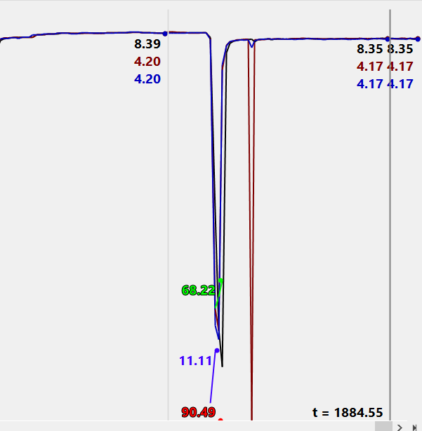

  2. Ohhh, sometimes total voltage drops to 0, sometimes cell 1, sometimes cell 2 but only one at a time is ever at 0 but all of them can be non-0. First image is each an attempt to fire, the second image is one time it actually let me fire and I captured it. Listen, the laptop batteries are an act of desperation lmao 🤣 if I could get one set of them to just last 30 minutes I would be happy until Mon/Tues when my fresh sets come in 😂 if this thing would let me bypass the batts entirely and power off USB I would def do that too 🤣
