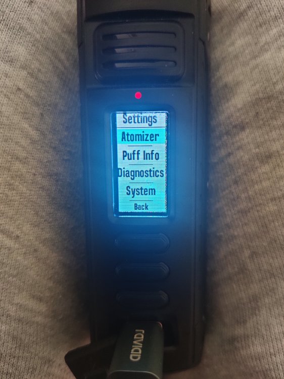

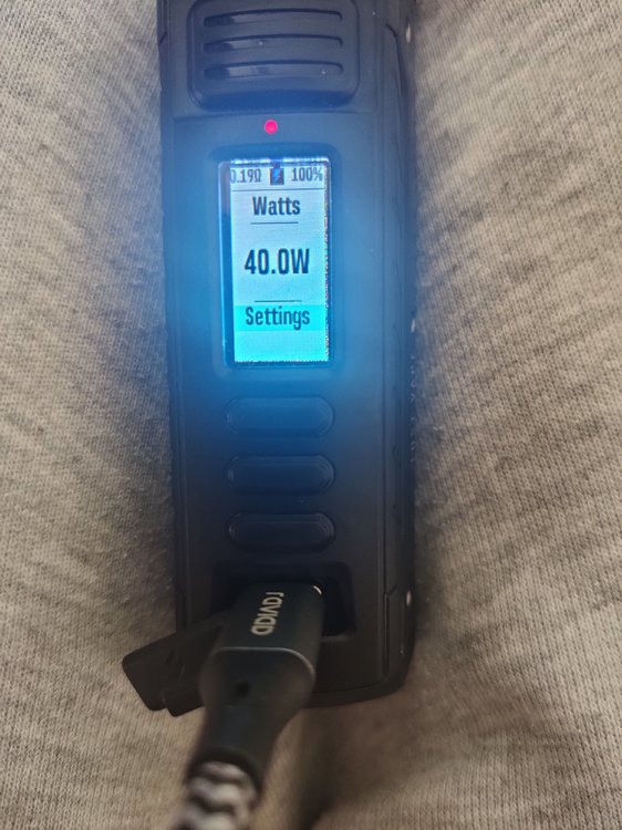

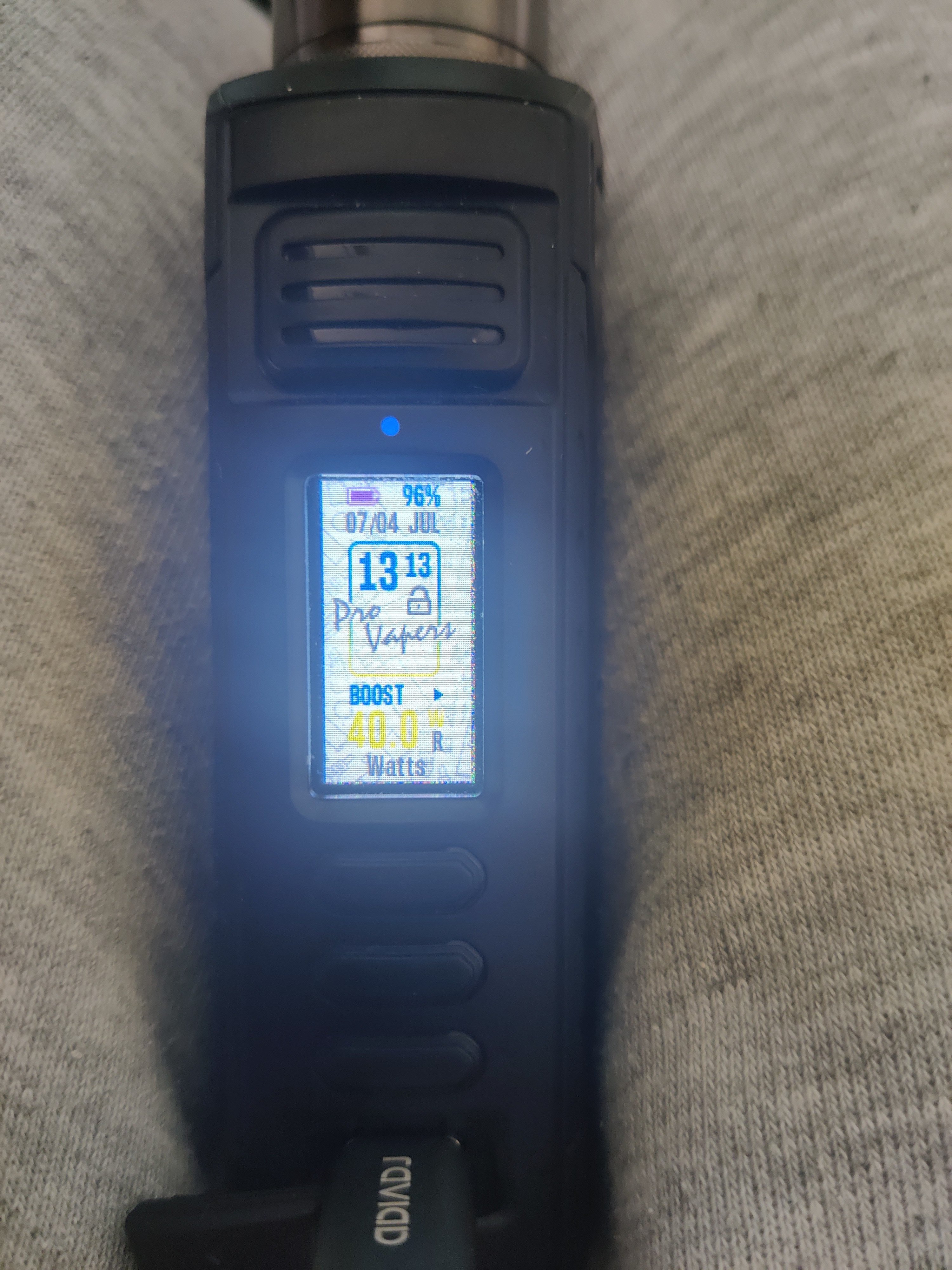

Nils81 Posted July 4, 2022 Report Posted July 4, 2022 I also own the Hyperion DNA 100C. I also have the problem. I have also switched between different themes. Even with the default theme from Evolv (see pictures) the colors are not displayed correctly. Also a change of the service pack did not work. Now I have again the ProVapers.Portrait.v9.1 as theme on the device and the colors are also again not correctly displayed (see pictures). What to do about this problem? Can someone help there? The device works fine otherwise. Thanks for the help.

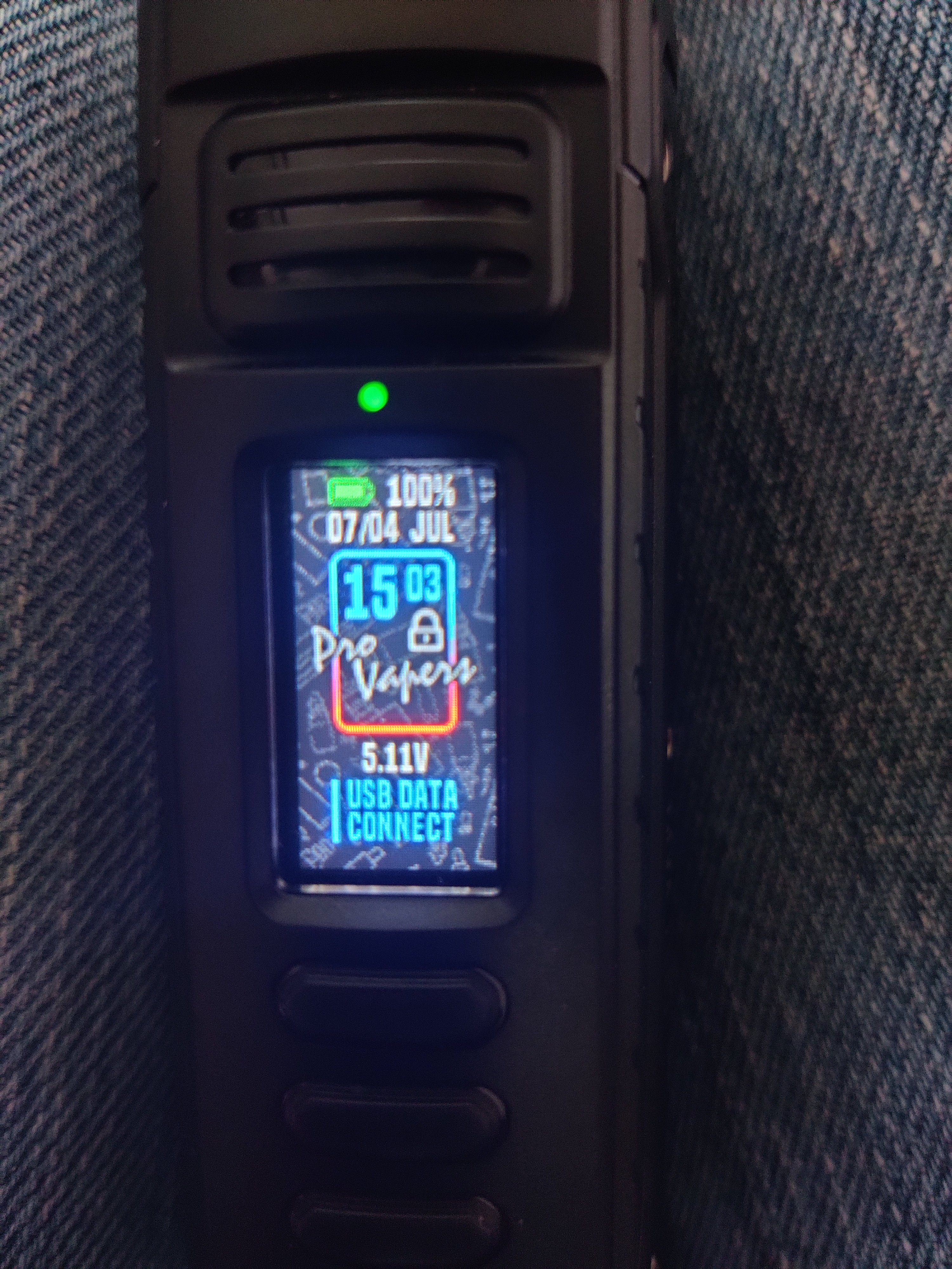

Nils81 Posted July 4, 2022 Report Posted July 4, 2022 Also an installation of the theme "ProVapers.Portrait.v9.1" has now worked without problems without the inversion of the colors (see picture). Then, in any case, the problem has been solved for me by resetting the device to factory settings. Many thanks for the support. 2

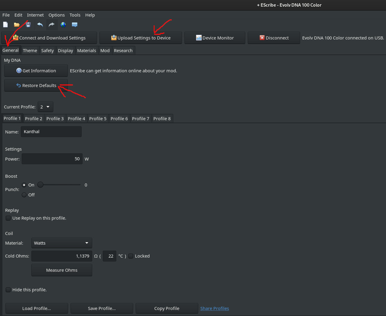

Nils81 Posted July 5, 2022 Report Posted July 5, 2022 vor 8 Stunden schrieb Peat: That’s great to hear you’ve been able to solve this issue Nils81! Are you able to do a step by step guide on how you reset your device? 1.) Connect your device to your PC via the USB port and start the EScribe software. 2.) Open the "General" tab. 3.) Press the "Restore Defaults" button. 4.) Press the "Upload Settings to Device" button. After that your device should have a normal color scheme again with the default Evolv theme. Good luck with it. 1
