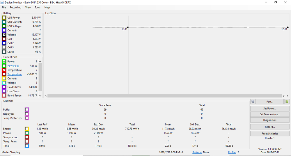

Wayneo Posted November 3, 2021 Report Posted November 3, 2021 Now that escribe sees your mod, start escribe, run Device Monitor, and do a full Screenprint (of DM) and post it here. I wanna see the individual cell voltages among other things. Let me get this straight. You sent it back in again, knowing it was out of warranty and no boards anyway, expressly for them to diagnose their work done 2 years ago, and they didn't even reply/update the ticket with 'No fault found'? Many times the tech will write a comment or 'test fire' and put that in the board info. For that you can click the 'get info' button after starting up escribe. On 9/18/2021 at 6:53 PM, Bricker89 said: As I'm smoking a cigarette, anyone know ...................... I didn't really buy that when you've said 'The only one that hasn't given me problems is my original DNA 75 HCigar VTC nano' or one of your more reliable $18 Chinese clones ......... but whatever

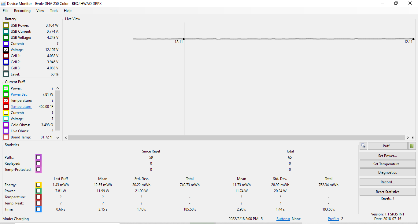

Bricker89 Posted February 18, 2022 Author Report Posted February 18, 2022 I left the MOD just sitting since making these posts couple months ago. Just now put the 3 pink 18650s and it's working. %67 battery. I downloaded the escribe old version 1.2 but it doesn't find the MOD. I plug USB and usually it pops up but even if I click Connect And Dowload settings, it says nothing is connected. I downlaoded the newer escribe and it found the MOD. Here's the screenshot. Wayne correct, the rep didn't reply in ticket or anything like 'no fault found'. I got the mod back in the mail and was surprised there was no follow up, that's why I asked if they remembered if it was fixed or what. dwcraig, excellent find if that's the reason. I agree it looks like the positive terminals on this MOD are too wide which might bypass the positive nipple of the pink batteries which don't even stick out. ------------------------------------------- When i got it back from evolv, I was able to get it to wake up using the computer USB. I got it to vape after that (unsure if it was USB plugged or not) but I took the cells out for a couple days (afraid to leave it unattended with cells in it), and then it was back showing 4% battery (fully charged all 3 externally) and nothing worked. A few day passed, I put the cells back in and it worked fine. I vaped it maybe 50 puffs over a few days, left it a couple days just sitting there and then it wasn't working again, usb woke it up, 'clock error' but it won't vape, unplugged USB and it won't wake up. It seems there's some sort of action that needs to reset it once this happens which might be from the one of the cells not touching the + terminal?
dwcraig1 Posted February 18, 2022 Report Posted February 18, 2022 Please provide a screen of Device Monitor when it's showing 4% (or similar).
