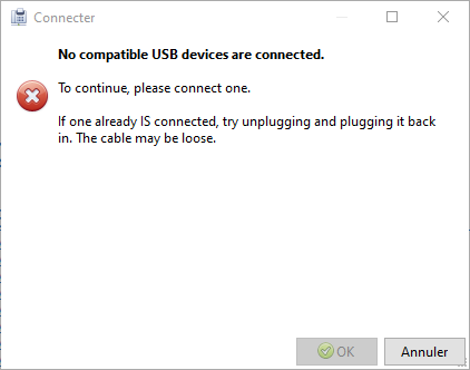

Apar Posted August 24, 2021 Report Share Posted August 24, 2021 Not working for me, when i plug my mod, it's written "No compatible USB devices are connected. To continue, please connect one. If one already IS connected, try unplugging and plugging it back in. The cable may be loose." Please help.. 😟 Link to comment Share on other sites More sharing options...
dwcraig1 Posted August 24, 2021 Report Share Posted August 24, 2021 6 minutes ago, Apar said: Not working for me, when i plug my mod, it's written "No compatible USB devices are connected. To continue, please connect one. If one already IS connected, try unplugging and plugging it back in. The cable may be loose." Please help.. 😟 https://downloads.evolvapor.com/SetupEScribe2_SP27_INT_ServicePack.exe Install SP27 Link to comment Share on other sites More sharing options...
Dragan Čelebić Posted August 24, 2021 Report Share Posted August 24, 2021 3 hours ago, Apar said: Not working for me, when i plug my mod, it's written "No compatible USB devices are connected. To continue, please connect one. If one already IS connected, try unplugging and plugging it back in. The cable may be loose." Please help.. 😟 I had the same or a similar problem when I got my hyperion DNA 100C. The first thing I noticed was that I didn't hear the "bling" sound that is heard when a device is connected to a computer via a USB cable. I kept going. I installed EScribe and had the same problem "I don't have a compatible device connected". I installed SP 27. I still had the same problem. He doesn't recognize. I had a few USB cables from different mods in the house. Eureka. I heard a "bling" sound. and the program recognized my DNA 100C. Everything else is history. Thanks for reading. Link to comment Share on other sites More sharing options...
