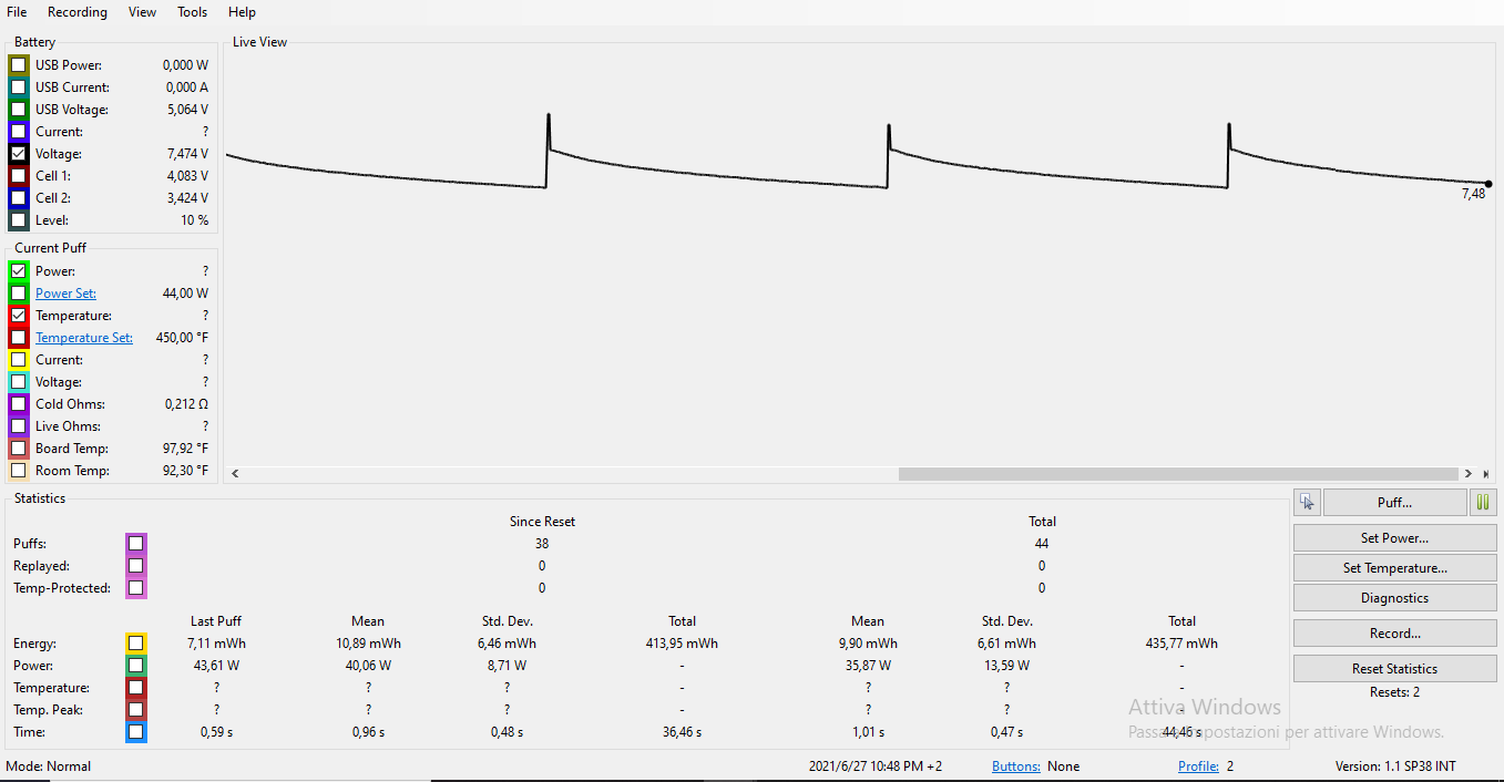

Hi, thank you for your quick answer, here's the screen, i charged the battery for the first time together yesterday, I already updadet the box at the last version and I did a "Restore defaults" too

Your cell 2, if you look is only at 3.4v which is much lower than cell 1. You should externally charge both. When done charging they should both be above 4.1V

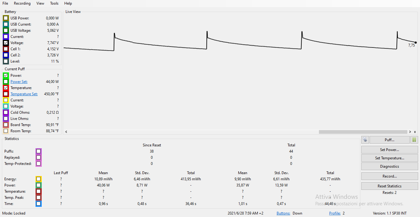

I tried to charge both batteries with my nitecore D2 and then insert the batteries in the box, same problem... Like this Video

If you look at your voltages of each battery right now in Device Monitor, and then with the same batteries, unplug the mod, swap battery positions, plug back in and look again in Device Monitor I believe you should still see cell 2 is low.
If what I say is true, you should return the mod to the place of purchase. Your mod is DOA (dead on arrival)
It appears more like wiring connections as opposed to a board issue.
