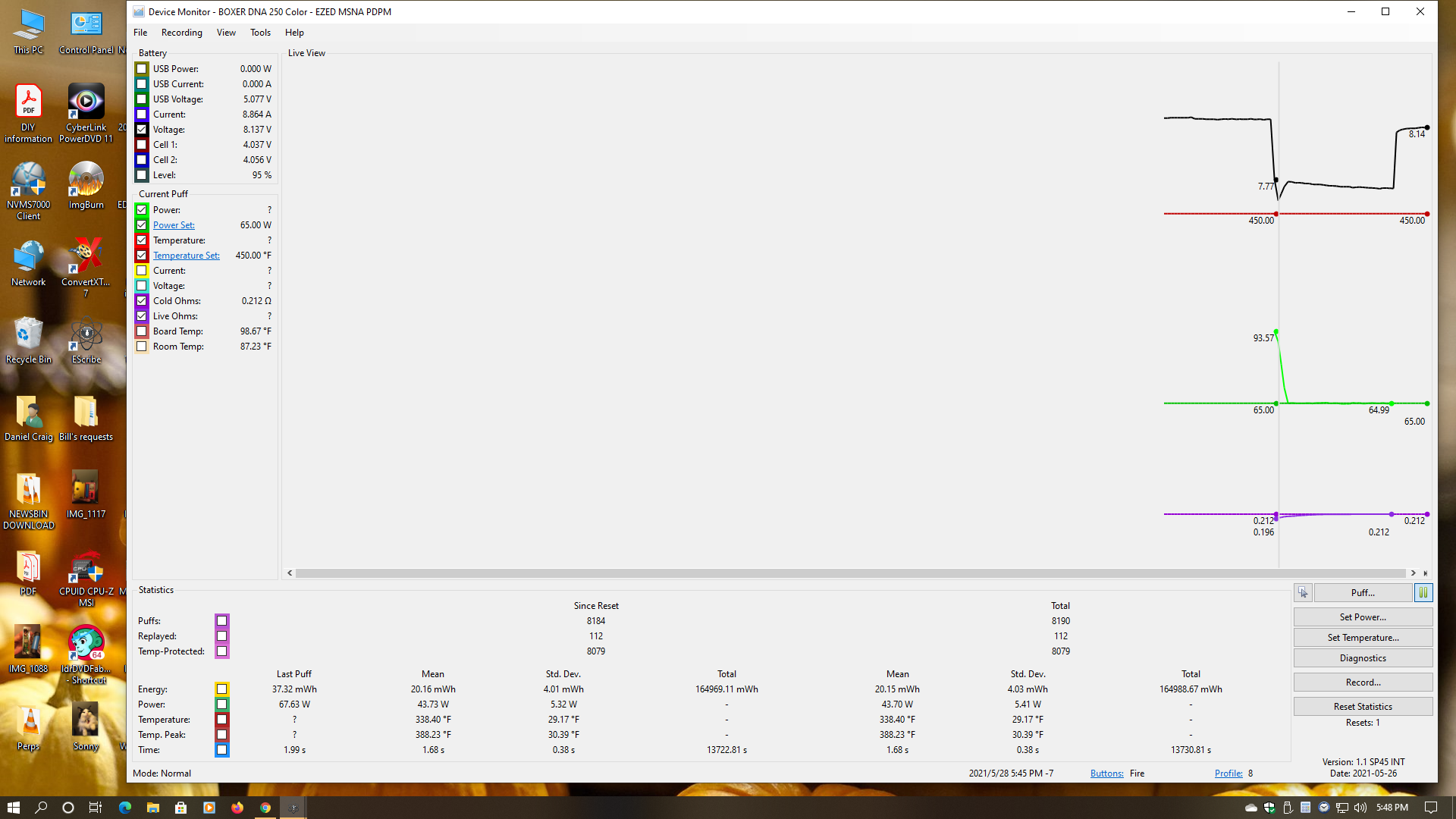

Wayneo Posted May 28, 2021 Report Posted May 28, 2021 Post a screenshot like below (Device Monitor) same checkboxes ticked, while firing. https://forum.evolvapor.com/topic/71597-change-in-resistance-value-when-heated/?do=findComment&comment=936766 1
Ahmed Nagy Posted May 28, 2021 Author Report Posted May 28, 2021 4 hours ago, Wayneo said: Post a screenshot like below (Device Monitor) same checkboxes ticked, while firing. https://forum.evolvapor.com/topic/71597-change-in-resistance-value-when-heated/?do=findComment&comment=936766 Sorry I can’t reach any pc near cuz am at work and am a chef so you know 😅 update : i got ss316l coil 26 round put in pioneer mtl and its works perfectly I just wonder why isn’t work on reload with mixed wire! Will check that and keep updating here thanks for helping appreciate it guys 🙏

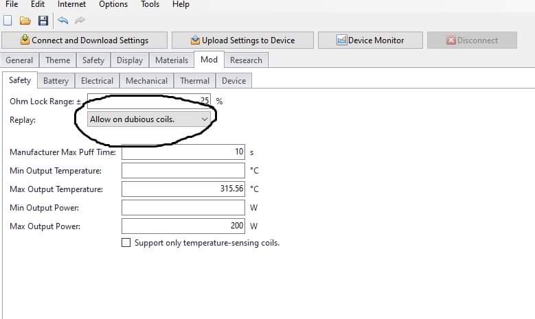

dwcraig1 Posted May 29, 2021 Report Posted May 29, 2021 I had to change to Dubious Coils or Replay wouldn't work. Be sure to upload settings after changing to Dubious Coils. Just a small resistance change from cold to hot, from 0.196 ohms to 0.212 ohms. I changed to a stock Evolv theme for this as well. I used this one: Evolv DNA-C stock.ecig 1
dwcraig1 Posted May 29, 2021 Report Posted May 29, 2021 I then switched back to Viable Coils and Replay failed to activate so I switched it back to Dubious and it is now working again. My opinion would be to use a material with a greater resistance change when building that low. Here is a great place for wire and coils: https://www.zivipf.com/epages/63862298.sf/en_GB/?ViewObjectPath=%2FShops%2F63862298%2FCategories%2FAlle_Produkte 1
