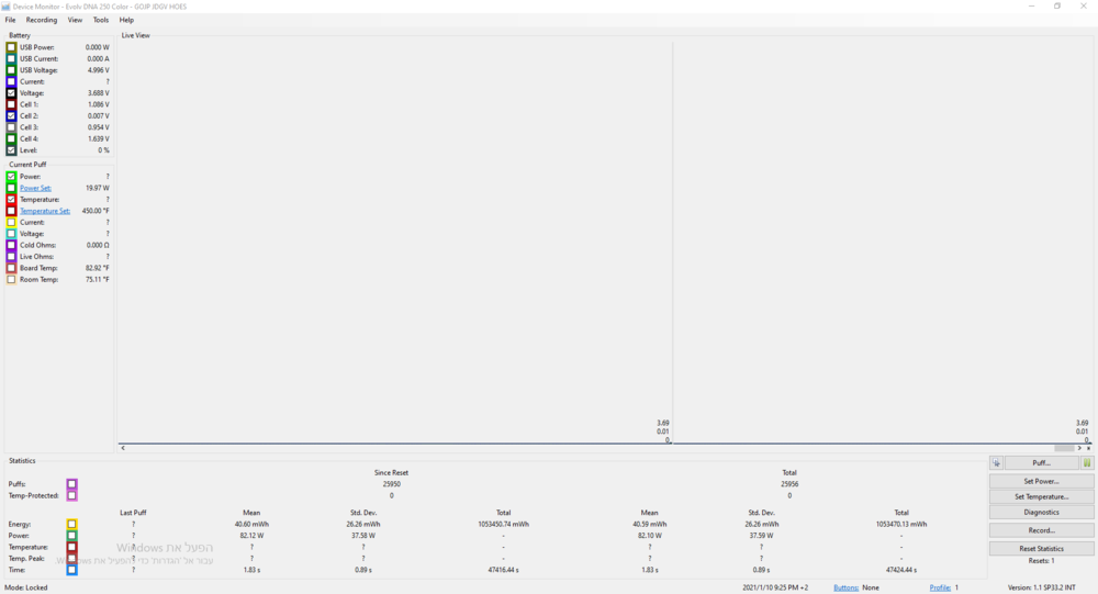

AZzAROo Posted January 10, 2021 Report Posted January 10, 2021 ok so hi everyone i have some problam with my divice 250c so i have this custom mod something about almost two years in total now i dont use this mod something about Six months until now ( and one year before this mod work perfect not isusse at all ! ) and after six months i come back to this use this mod and the problem is become to come first at all when i left this mod i have 4% battery before six montes ( i have lipo 4s battery ) now after six months i come is sill have this 4% but now i have error (press up error ) ok so i Update my mod (first time on two yaers) to sp38 now i dont know if this problem is still or just fixed how i chuck this ? and the Second problem is when i disconnected my mod the connected show my 0% and shuts down when i connected my mod again is show my immediately 4% and after few min is show my 0% and still work(becuse is connected to my computer) now what i need to do to chuck if this is hardware or my battery now this is my device monitor ( i dont know but the V on sell 2 is very very low 0.00007V this is Almost nothing) thank you for help
dwcraig1 Posted January 10, 2021 Report Posted January 10, 2021 You need a new battery. The voltage is way to low to safely charge it. 2

AZzAROo Posted January 10, 2021 Author Report Posted January 10, 2021 1 hour ago, dwcraig1 said: You need a new battery. The voltage is way to low to safely charge it. 1 hour ago, retird said: What he said ...............😃 ok thank you for all what taype of lipo 4s battery recommended ? How do I check if the error is still there ?
