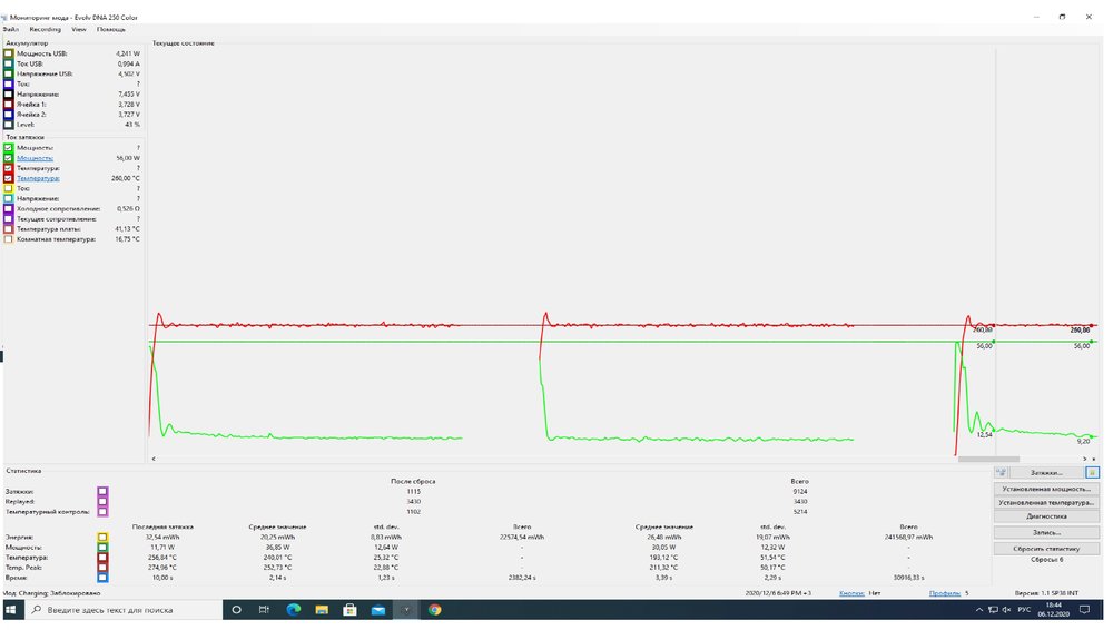

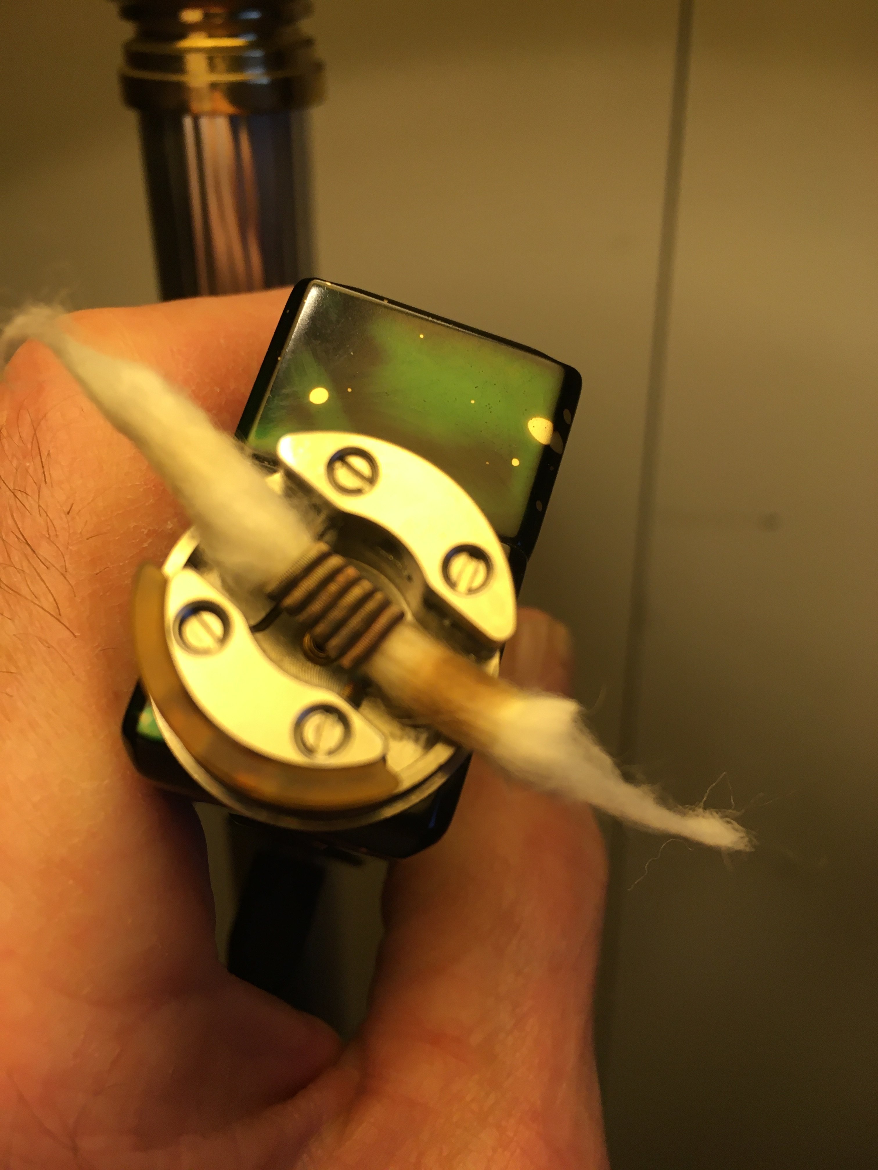

dwcraig1 Posted December 6, 2020 Report Share Posted December 6, 2020 Image of DNA250 non-color firing dry wick with 316L clapton coil with .5 second 60 watt boost then 40 watts. Same was done with DNA250 Color and results were similar. I had to hold firing button for several seconds before wick would show signs of burning, 15 seconds fire time. Voltage output dropped to 1 - 2 volts on both. 1 Link to comment Share on other sites More sharing options...

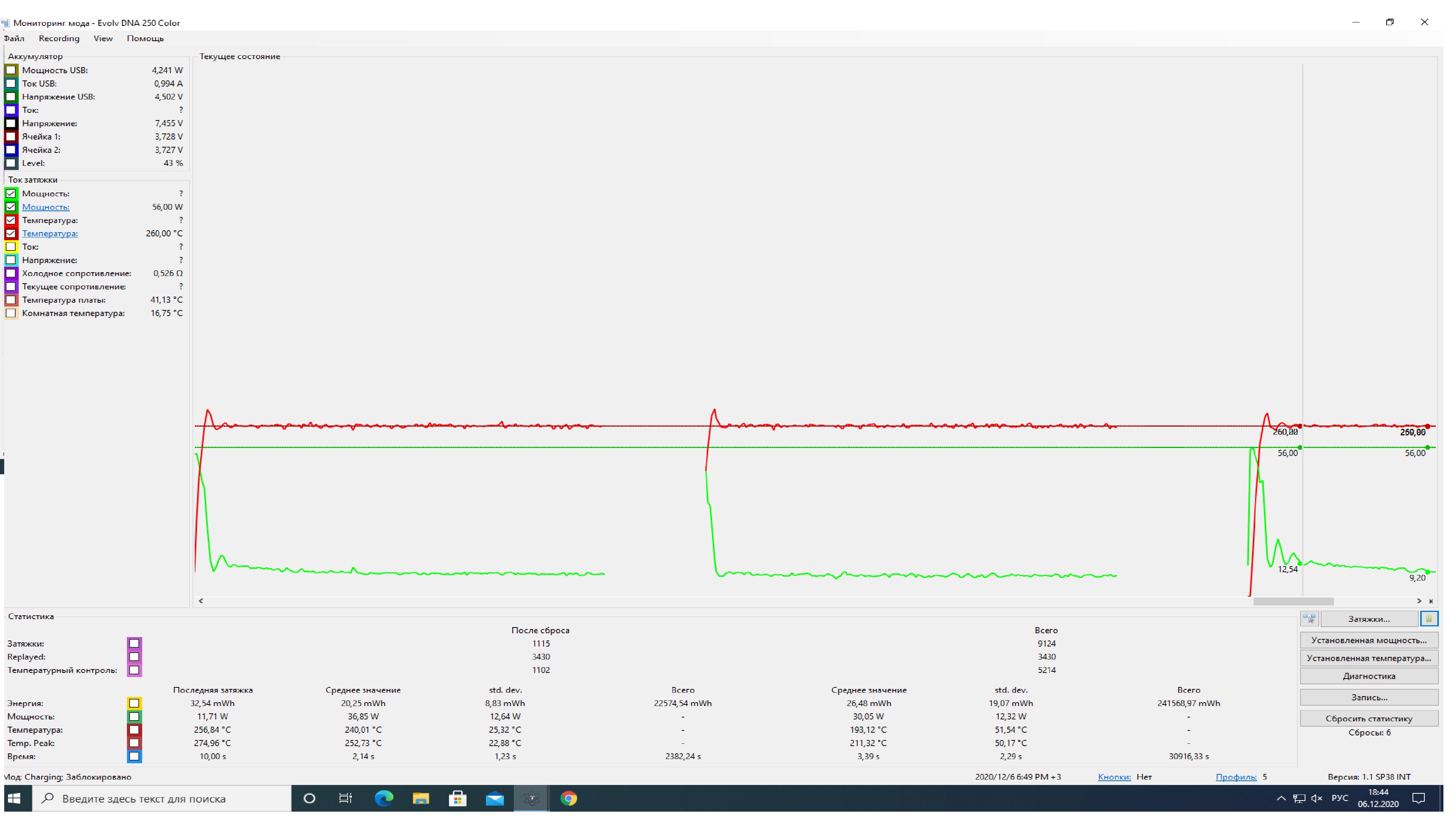

dwcraig1 Posted December 6, 2020 Report Share Posted December 6, 2020 It looks to me that the mod maybe is jumping out of TC and into wattage mode. Device Monitor in EScribe will help determine that. Perhaps poor connections between board and coil resulting in artificial resistance readings. 1 Link to comment Share on other sites More sharing options...

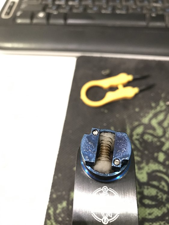

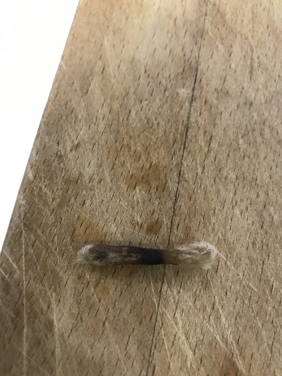

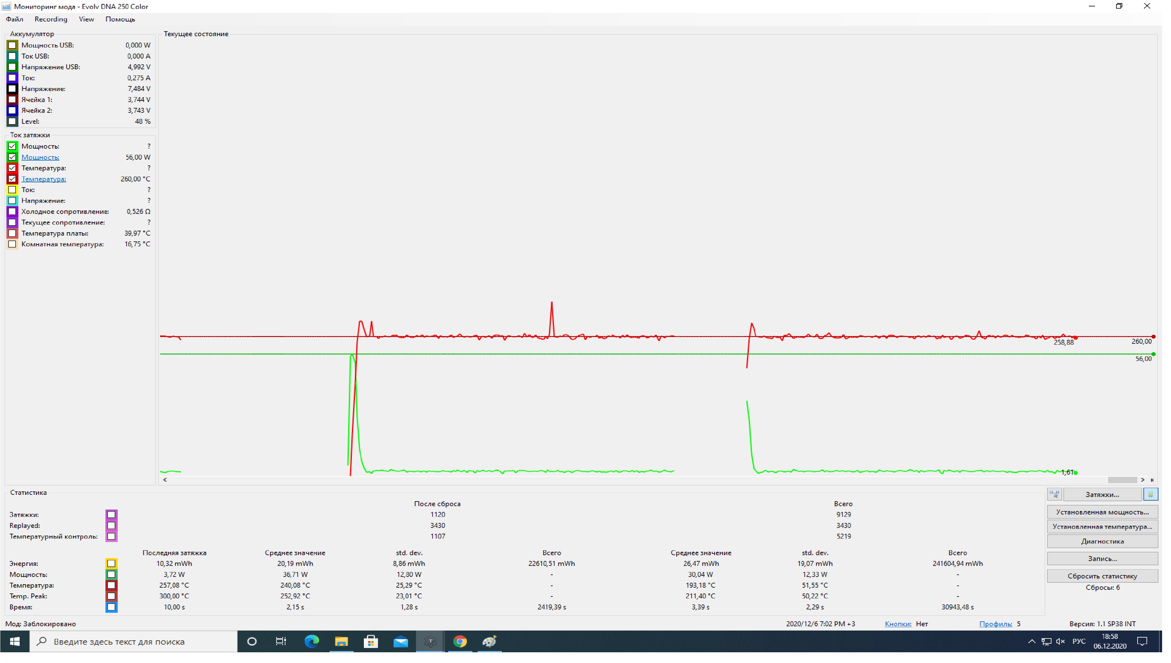

Djini Biba Posted December 6, 2020 Author Report Share Posted December 6, 2020 Это с ватой и жидкостью по 10 затяжки 10 раз примерно .Хлопок сгорел ,как сухарь черный ,потом без ваты он выдал по два вата Титан 1 Поставлю новый катушку и вышлю как он без жидкости работает Link to comment Share on other sites More sharing options...
Djini Biba Posted December 6, 2020 Author Report Share Posted December 6, 2020 Новый Титан 1 без ваты .Разве так и должно быть 3-1 ват включать напряжение ?Он же должен его отключить и не включаться ! я жарил 10 раз примерно вот откуда он включает 230 градусов на фото последнем!? наверно из-за этих графиков красных он выходит за рамки до 230 и включает напряжение эти два вата 2-3 вата или один 1.75 и хлопок начинает румяниться как на фото New Titanium 1 without cotton wool .Is this how it should be 3-1 Wat to turn on the voltage ?It should turn it off and not turn it on ! I fried 10 times approximately that's where it turns on 230 degrees in the photo last!? probably because of these red graphs, it goes beyond up to 230 and includes the voltage of these two watts 2-3 watts or one 1.75 and the cotton starts to blush like in the photo Link to comment Share on other sites More sharing options...
Djini Biba Posted December 6, 2020 Author Report Share Posted December 6, 2020 Link to comment Share on other sites More sharing options...
BillW50 Posted December 6, 2020 Report Share Posted December 6, 2020 260°C / 500°F is too high of a temperature and will burn a cotton wick wet or dry. And your next post, running it without cotton it will still fire, but it will hold at the set temperature. Link to comment Share on other sites More sharing options...
Djini Biba Posted December 6, 2020 Author Report Share Posted December 6, 2020 Вот именно что он не держит его при 220 С* А прибавил до 230 С* и снова и снова выше 222 С* за пределы графика красного That's exactly what it doesn't keep it at 220 Celsius But has added up to 230 C* and again and again above 222 C beyond the red chart Link to comment Share on other sites More sharing options...
BillW50 Posted December 6, 2020 Report Share Posted December 6, 2020 What kind of RDA (atomizer) is that? It doesn't look like it offers a solid enough connection for temperature control to me. It probably works fine in power mode. Your graph from the Device Manager seems to support that opinion. The live ohms should be a solid straight line once it hits the set temperature. See the ripple in the line? When you check the internal resistance of the mod and it reads 0.003Ω to 0.004Ω, does the live ohms show a ripple on the graph too? If it does, the ripple is in the Centaurus and maybe not also in the atomizer. Link to comment Share on other sites More sharing options...

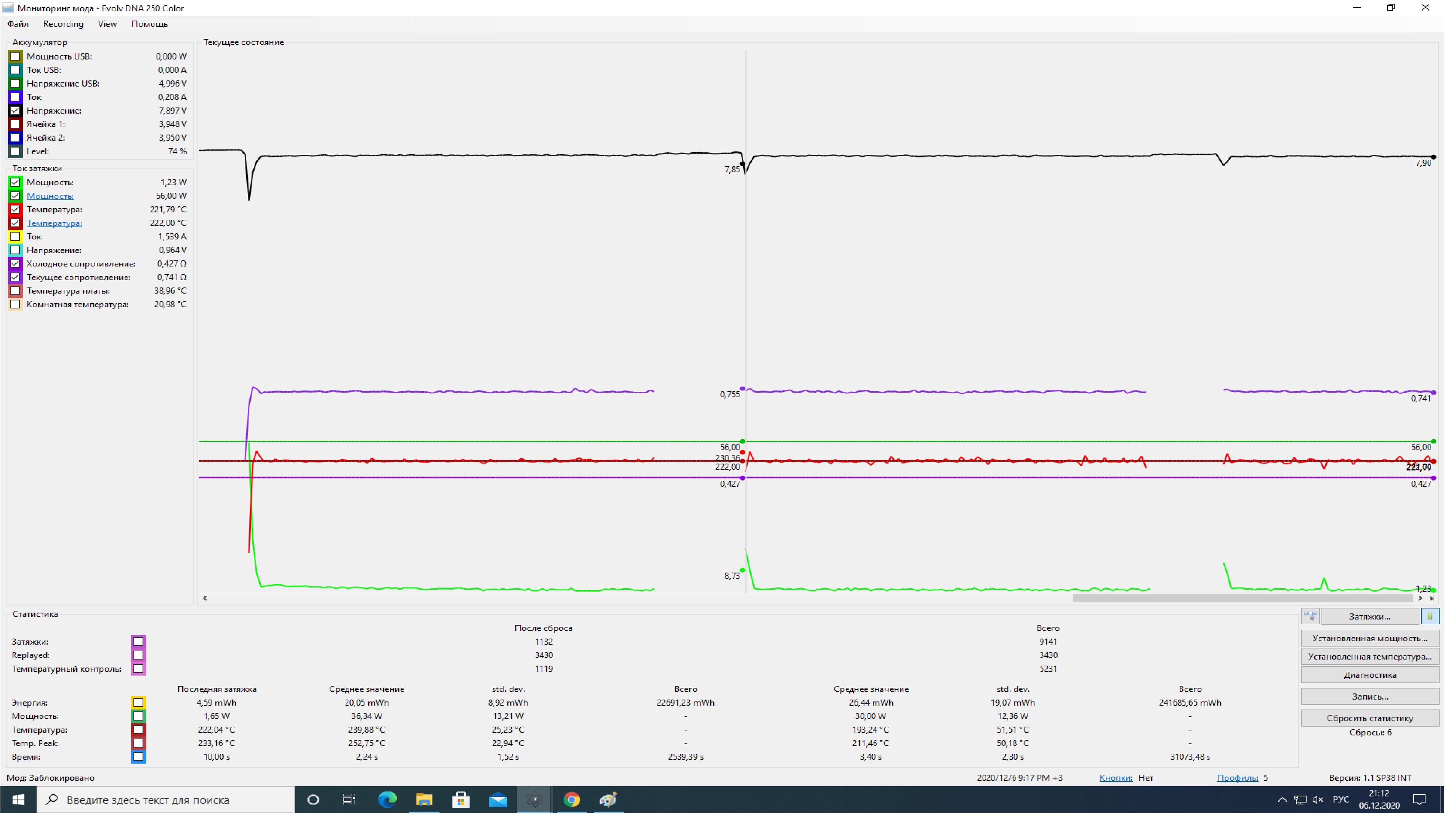

Djini Biba Posted December 6, 2020 Author Report Share Posted December 6, 2020 Wasp nana оса предварительный нагрева нет и preheat нету .я надеюсь что он отключён до 0 .Я везде ноль выставил .и минимально только 1 можно выставить ползунок в роде вкуса говорят нету и не может быть вообще .При 25-30 . 40 ещё как то есть немного .Я попробую так покурить. на графике попробую завтра посмотреть. главно чтоб понять как это проверить и сделать.Через анализатор показывает 0,004 график я завтра Wasp nana wasp there is no preheat and no preheat .I hope it's disabled to 0 .I put zero everywhere .and the minimum is only 1 you can set the slider in the genus of taste they say there is no and can not be at all .At 25-30 . 40 still as that is a little .I'll try to smoke like this. I'll try to look at the chart tomorrow. the main thing is to understand how to check and do it.Through the analyzer shows 0.004 schedule me tomorrow Link to comment Share on other sites More sharing options...

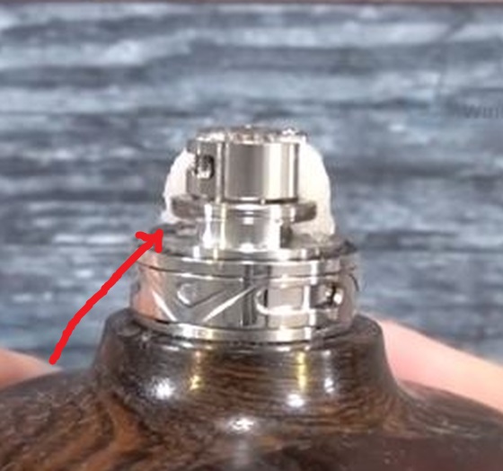

dwcraig1 Posted December 6, 2020 Report Share Posted December 6, 2020 Are you cutting your wick to this length? Link to comment Share on other sites More sharing options...
Djini Biba Posted December 7, 2020 Author Report Share Posted December 7, 2020 Любой как получается, на глаз. я rda использую в основном .Там как получается если видно в основном немного не до дна в rba Link to comment Share on other sites More sharing options...
Djini Biba Posted December 7, 2020 Author Report Share Posted December 7, 2020 (edited) Прямая полностью 0,004. ноль на графике прямая Edited December 7, 2020 by Djini Biba Link to comment Share on other sites More sharing options...

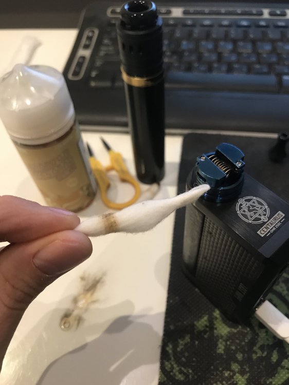

Djini Biba Posted December 7, 2020 Author Report Share Posted December 7, 2020 Не понял ,про что именно говорите где и когда ? или вы о том что курить просто с жидкостью как обычно то норм бывает, наверно так.Бывают норм Но ватка практически сразу чёрная первые такие попадания кажутся Link to comment Share on other sites More sharing options...
Djini Biba Posted December 7, 2020 Author Report Share Posted December 7, 2020 1 hour ago, dwcraig1 said: Are the first couple of hits good? Вот что мне предполагает на 10 -12 пых первых 34wat 247 c Link to comment Share on other sites More sharing options...
