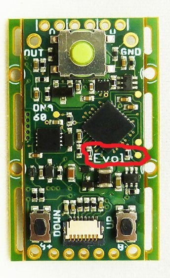

dwcraig1 Posted June 15, 2020 Report Posted June 15, 2020 Here's one way. Also the menu should give you a good indication.

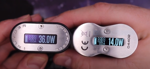

dwcraig1 Posted June 15, 2020 Report Posted June 15, 2020 Here is an example of where the menu is deceiving, the one on the left is a DNA60 and the one on the right it not.

dwcraig1 Posted June 15, 2020 Report Posted June 15, 2020 I was initially fooled in to thinking that the one one the right was DNA60 till I seen one that had a see through case and you could see a different arrangement of the board's components.
VAPINGSSP Posted June 15, 2020 Author Report Posted June 15, 2020 Thanks. Its funny that you showed the easy side by side....thats what I'm getting swapped to a DNA 60. Its a long convoluted story, but someone I have trusted for years, bought tons of stuff from recently screwed me. I already gave him the mod and paid for him to put in a DNA60 chip. I thought nothing of it until now....then realized there is no USB, and how would I know if its legit. I have a clear easy side by side too, so will definitely compare the screens side by side (lol, no pun). But thinking when I boot up the screen it won't say ambition mods anymore....won't it say evolve or something like that or different?
dwcraig1 Posted June 15, 2020 Report Posted June 15, 2020 It is capable of being programmed to say what ever is programmed into it . If your guy puts in a board without programming it then it will have the stock Evolv setting and will say "Evolv" on the start up screen. I hate when the builders don't add a data capable USB port. EScribe is half of the show.
dwcraig1 Posted June 15, 2020 Report Posted June 15, 2020 9 minutes ago, VAPINGSSP said: Thanks. Its funny that you showed the easy side by side....thats what I'm getting swapped to a DNA 60. Its a long convoluted story, but someone I have trusted for years, bought tons of stuff from recently screwed me. I already gave him the mod and paid for him to put in a DNA60 chip. I thought nothing of it until now....then realized there is no USB, and how would I know if its legit. I have a clear easy side by side too, so will definitely compare the screens side by side (lol, no pun). But thinking when I boot up the screen it won't say ambition mods anymore....won't it say evolve or something like that or different? Don't look at the screen as it looks authentic, look at the component layout on the board.
VAPINGSSP Posted June 15, 2020 Author Report Posted June 15, 2020 Thanks, and what you just said is what I'm afraid of. Because its a black mod, I won't be able to see the board as easily, but will do whatever I can to verify it. The settings should be slightluly different on the DNA 60, so hopefully that will be enough.

Valter Posted March 15, 2021 Report Posted March 15, 2021 LOL I realised I can actually take the box appart, it has a 3d printed receiver inside with the components bolted to it, the board should say Evolve .. Thanks again for taking the time to reply here @Wayneo
