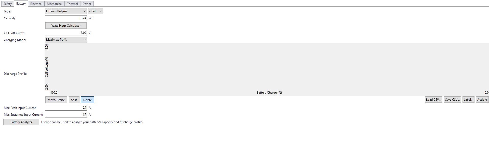

shehabismail Posted May 31, 2020 Report Posted May 31, 2020 Hello , On one of my DNA 200 devices, when i try to upload a dual battery profile i cant. The whole thing is kind of dimmed, i can do what i want on any other mod though, but this one i cant. Check attached screenshot. Help is appreciated
retird Posted May 31, 2020 Report Posted May 31, 2020 Probably because you have nothing shown in the Discharge Profile portion..... you need to load a CSV file..... you can look at one of the other mods you have to see what I mean...

shehabismail Posted September 16, 2020 Author Report Posted September 16, 2020 After months of trial and error i finally fixed it, its a weird fix but hey it worked, so i am just dropping it here for the sake of helping any other user with this weird issue The problem: Cant load any battery profiles into the mod through escribe, you can see it on the first post where its "dimmed" and the buttons where you want to load a csv just wont load the window where you choose the csv from Tried: Resetting, hard reset, reinstall escribe, different cable, different pc all together, nothing, i have a lot of DNAs and this specific one was the one facing the problem, any other one worked normally Fix: Change battery type from Lithium Polymer to LifePo4 as soon as you do that, the graph shows again, change it back to Lithium Polymer and the graph remains and you can load your csv normally now and upload it to device, i think this is a bug and would like Evolv to take a look at it and even if they want to collect logs from me, no problem.
