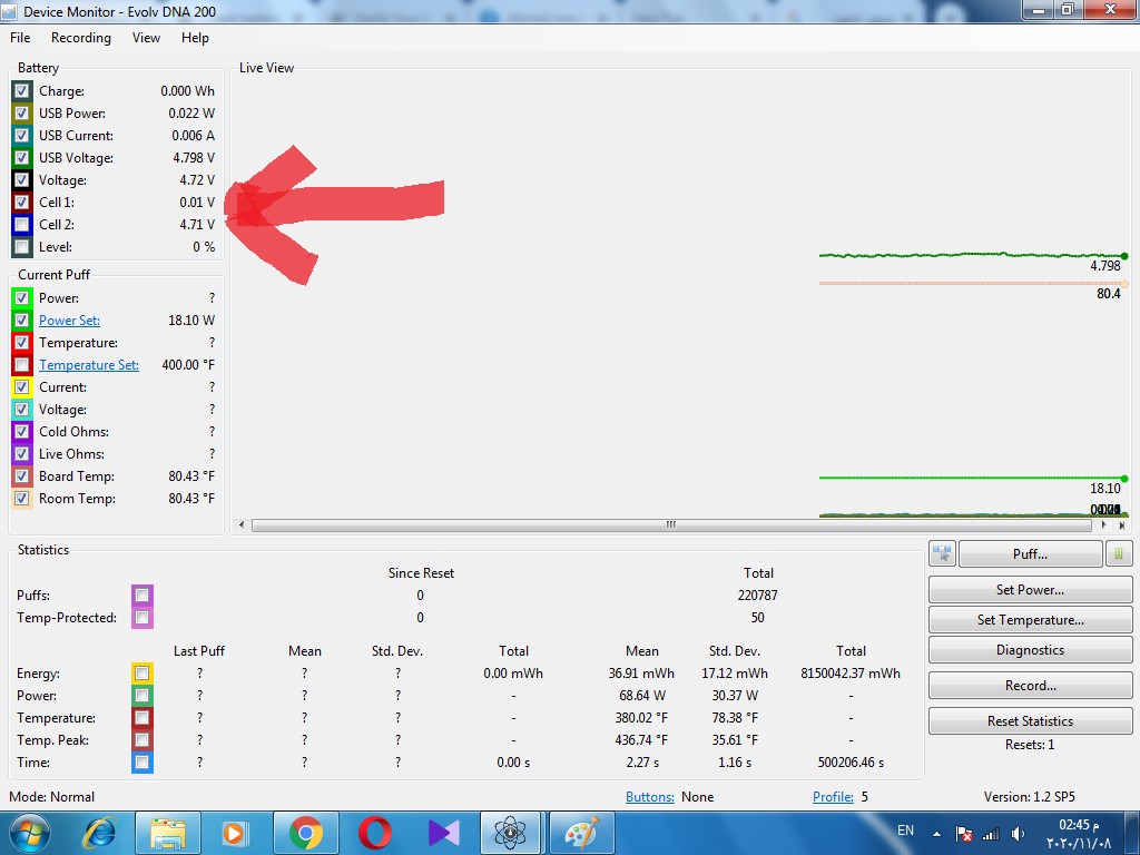

dwcraig1 Posted September 27, 2019 Report Posted September 27, 2019 Using Device Monitor in EScribe check the voltage on each cell and post here.
Wayneo Posted November 8, 2020 Report Posted November 8, 2020 @Reda Looks like your battery management chip is blown there. Other than replacing that blown chip it's a sad day for you and that mod. At ~220K puffs, it's lived a good life.
Wayneo Posted November 8, 2020 Report Posted November 8, 2020 9 minutes ago, Reda said: 😒 no solution ?? 22 minutes ago, Wayneo said: Other than replacing that blown chip Buy a 250 board and replace board. IIRC it's close to a drop in replacement
