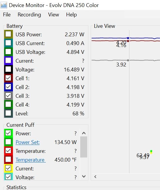

hill115side Posted August 28, 2019 Report Posted August 28, 2019 I have a DNA250C with a Hyperion 2800mah and looks like the charge percentage is off. I have added an image from the Device Monitor screen for reference. Has anyone else had this issue and what could I do yo fix it?

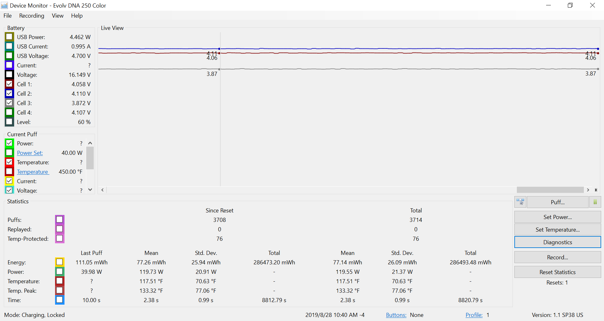

retird Posted August 28, 2019 Report Posted August 28, 2019 Not many folks have a 4 cell 250C. Your cell 3 seems to be out of balance in the screenshot. You might compare this CSV file to your CSV. Save your battery CSV file and load this one (attached file) if you want to see if that helps or you can run battery analyzer to create a CSV for that battery pack.. Screenshot of my 4 cell 250C while still charging: 4cellcsv.csv

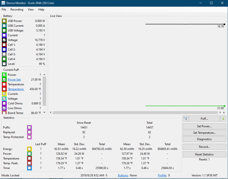

Wayneo Posted August 28, 2019 Report Posted August 28, 2019 21 minutes ago, retird said: Your cell 3 seems to be out of balance in the screenshot No use running the analyzer now. Over time, leaving your mod charging, it should rebalance, unless you can bring up cell 3 on your own.

hill115side Posted August 28, 2019 Author Report Posted August 28, 2019 No, it will not balance charge in the device. The best I get is 70% in the device.
hill115side Posted August 28, 2019 Author Report Posted August 28, 2019 no, cell 3 will be around 3.9 and others are 4.2. I would assume that the pack percentage would be higher than 70% at that point.
hill115side Posted August 28, 2019 Author Report Posted August 28, 2019 Current screen for reference.

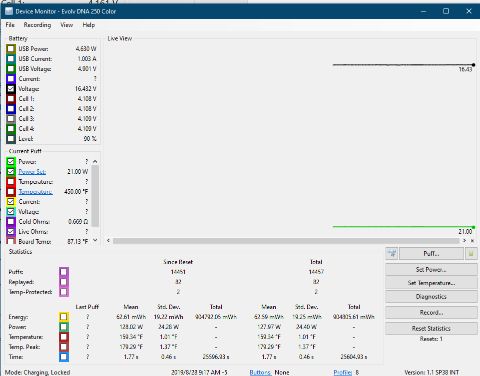

retird Posted August 28, 2019 Report Posted August 28, 2019 The 70% peak may be a CSV file thing but the balance issue may be a battery internal thing or a charger circuit thing in the device. But you say you can externally charge the battery and it is balanced at 100%. Screenshot of my 4 cell completely charged in the device. Shows 99% charge reading. My Battery is not the same one as yours.

Wayneo Posted August 28, 2019 Report Posted August 28, 2019 @hill115sideAFTER your external balance charge do another printscreen like your last one.
hill115side Posted August 28, 2019 Author Report Posted August 28, 2019 (edited) SUCCESS, the pack is now fully charged and balanced. After I removed the pack from the mod, it still would not balance charge on the external balance charger. What I did was discharge the pack to the storage voltage level (3.8) and started a balance charge again, that seems to have done the trick. Hope this helps someone else that has a similar issue. Edited August 28, 2019 by hill115side
