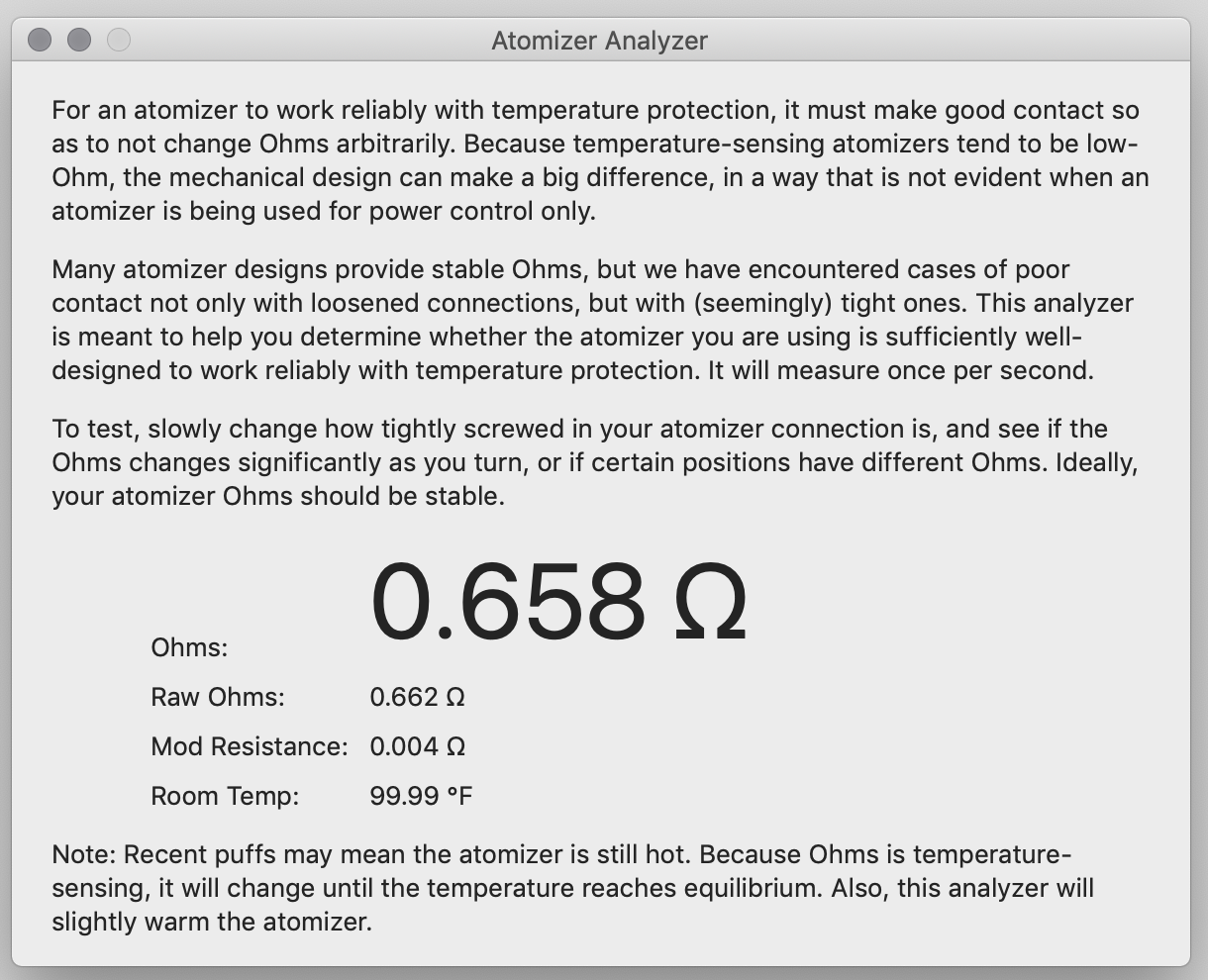

What is the resistance of the coil? Go to the Mod tab and click Atomizer Analyzer to see. You'll need to set EScribe to at least Advanced mode (Options -> User Interface -> Advanced).
What is the coil rated at? There it looks like it's at about 0.67 Ohm.

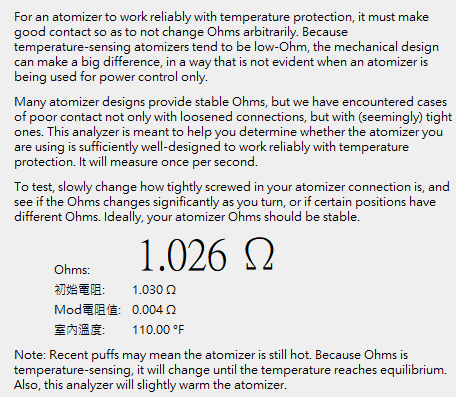

Posted
4 小時前, James說:
Thanks for reply
what should I do

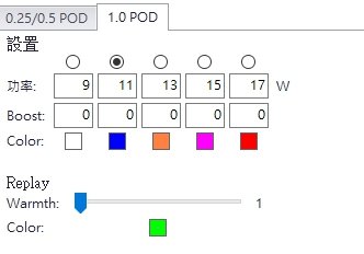

The default values of both those pods are the equivalent of the ranges on store bought coils. Yes you can raise them much higher, but they'll burn out quicker. The DNA GO can output 30 watts, the pods cannot handle that.

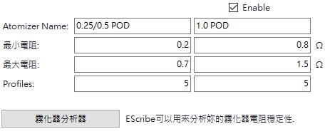

If that coil is 0.658 Ohms cold, the limit they have set of 0.7 Ohm will (if it is a temperature-sensing coil) not produce significant vapor. Is it marked as a 0.5 Ohm coil? If so, perhaps you got one that was well outside the appropriate variance.
You could try upping the limit from 0.7 Ohm to 0.8 Ohm and see. (At your own risk.)
