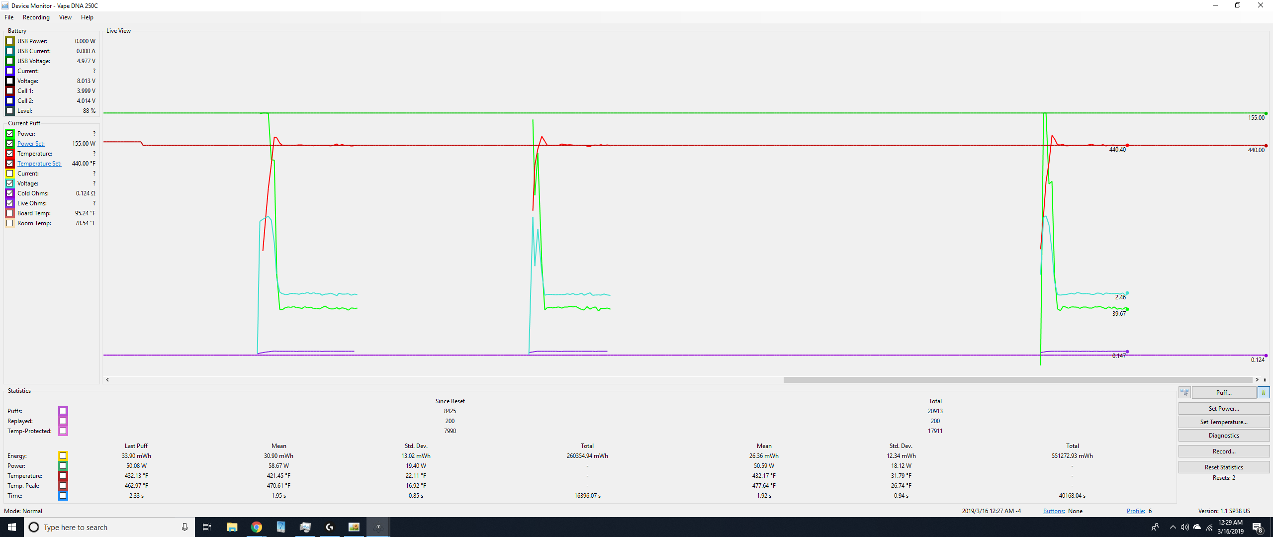

StockQuahog Posted March 16, 2019 Report Posted March 16, 2019 (edited) Info Paranormal DNA 250C Geek Vape Zeus dual coil Advanced Vape Supply triple core fused clapton SS316L wire ~.124 ohms Set to 155w Set to 440 degrees F No punch No preheat These settings work very well for me. It seems like most people use preheat but why? Why not set the wattage high and let the chip back off the wattage when it gets to the correct temp? I also see people saying SS wire builds should have a higher resistance but I've used the same setup for months with no problems. Any thoughts or recommendations are appreciated, thanks. Edited March 16, 2019 by StockQuahog
Lanzarotechris Posted March 16, 2019 Report Posted March 16, 2019 What are the values of your coil(s) diameter, wraps,... 1 hour ago, StockQuahog said: It seems like most people use preheat but why? Why not set the wattage high and let the chip back off the wattage when it gets to the correct temp? Well, maybe because whe you use preheat you will not have the huge spike like in your diagram (Power and Voltage), so they don't stress their batteries like you do, which will result in longer lifetime for the batteries... its also safer if you don't stress your batteries over the recommended Ampere value (calculate it with an Ohms Law Calc). Yes, maybe the chip throttles down, but I think its more intelligent to NOT to rely on the correct function of a chip to protect me from blowing up my batteries. Also my mod will last longer over the day if I don't run it on 155 Watts but 50 instead. As you see in the diagram, the 155 Watts only lasts for a very short time, so you are actually wasting energy and stress your batteries without reason when you could use preheat instead. Or to quote your coil manufacturer: **THIS IS AN ADVANCED ITEM THAT REQUIRES A GOOD UNDERSTANDING OF BATTERY SAFETY AND OHMS. WE RECOMMEND ONLY FOR USE ON A REGULATED MOD, MECHANICAL MODS ALSO WORK BUT CAN BE DANGEROUS IF DONE INCORRECTLY! 1
Wayneo Posted March 16, 2019 Report Posted March 16, 2019 @StockQuahog Personally I'd have no battery concerns. Your build and settings are working fine for you. Nothing wrong at all, if you like that vape and flavor. BUT if your build goes wonky you'll be vaping at 155 watts. If you were to put Preheat to 155w, Punch to 11, and set regular power to 50 ....... you'd achieve the same thing, while having some safety if it drops out of TC. By blasting your way to any temp you could be missing out on nuances in your ejuice, which could be a good or bad thing. Higher resistance SS builds are easier for chips to control in general. Your .124 raises up to ~.15 ......... a .4 would raise to ~.48 Only old-timers will appreciate that Karloz bump, where your mod has overshot the temp set before settling.
Chris Musampa Posted March 16, 2019 Report Posted March 16, 2019 (edited) As Wayneo says, you'll taste your juice better if you reduce the final ramp up speed. Your device monitor shows you need about 40 watts to maintain temperature for your draw, so maybe set power around 50 - 60 watts (experiment with it) and preheat to 155, then mess around with the punch value. If you set power and/or punch too low you'll probably notice a little spitback (as you'll be drawing while the juice is just starting to boil but not full got going yet), too high and you'll miss out on some flavour. Edited March 16, 2019 by Chris Musampa

Lanzarotechris Posted March 17, 2019 Report Posted March 17, 2019 7 hours ago, StockQuahog said: Hey Guy Fawles can you pls just hack my escribe and fix my settings? or at least tell me what iphone app I need? Set your profile to SS316L, temp could stay like it is, and power to about 40-50 watts. Activate Replay Set preheat to 80 or 100 W, for 1 second should be enough. Adjust after trying if needed The default punch and warmth is 4, adjust after trying if needed (punch for throat-hit, warmth for warmer or colder vape) Try it 😉 Adjust the power setting only when it spits ... otherwise adjust the preheat Enjoy ! come back here and report if its ok... or if its not 😉
