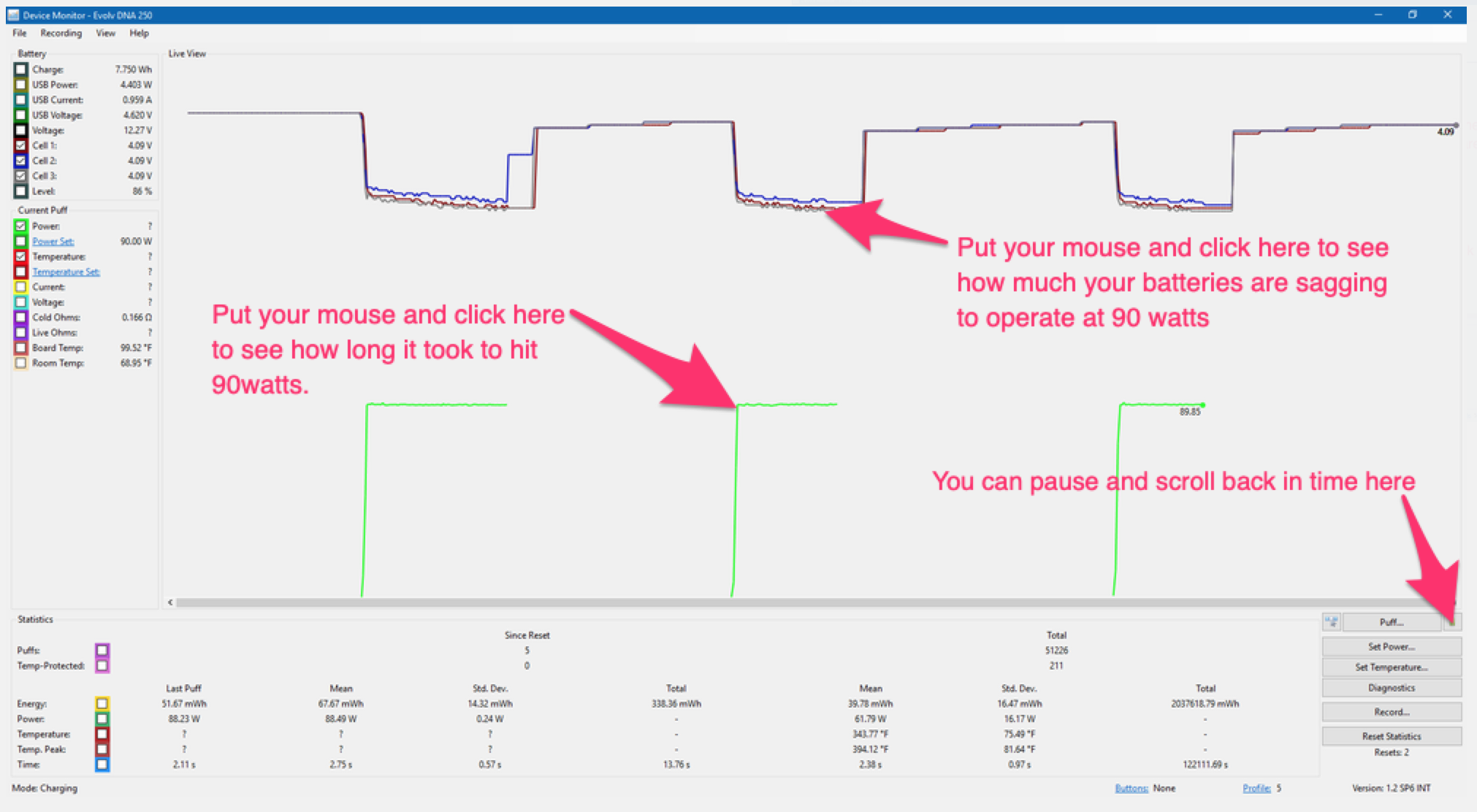

Wayneo Posted February 18, 2019 Report Posted February 18, 2019 11 minutes ago, MohKha said: Currently running an RTA at 90w but every pull I take reduces the battery by 1% so I get around 100 pulls before the battery is dead Batteries talk in volts, but you can see their performance in Device Monitor. Only Click/select cell 1-3 and post a full printscreen while firing. you might want to lower your cell soft cutoff to 2.7-3V I already answered your question 3. Live display.
Wayneo Posted February 18, 2019 Report Posted February 18, 2019 For battery details it's under the Mod tab For the MOD tab to appear - Options (menu bar) -> User Interface -> Manufacture

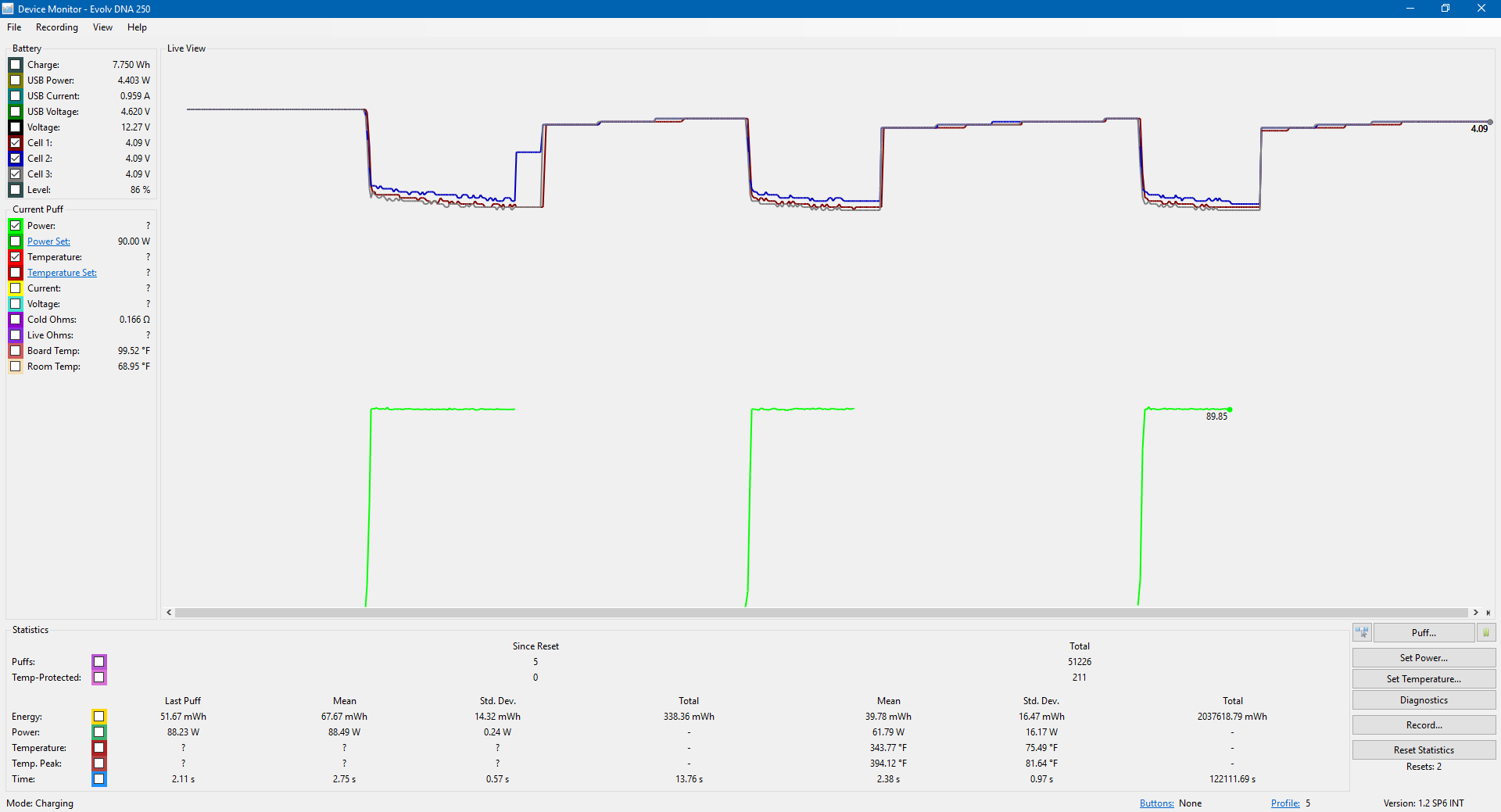

MohKha Posted February 18, 2019 Author Report Posted February 18, 2019 4 hours ago, Wayneo said: Batteries talk in volts, but you can see their performance in Device Monitor. Only Click/select cell 1-3 and post a full printscreen while firing. you might want to lower your cell soft cutoff to 2.7-3V I already answered your question 3. Live display. screenshot of device monitor attached
Wayneo Posted February 18, 2019 Report Posted February 18, 2019 @MohKha Thanks, your batteries appear to be firing evenly, that's a good thing. Here's your printscreen back with a few notes on it for you. No need to repost it back here. And maybe you can find a Lyra forum to ask all those other questions.
