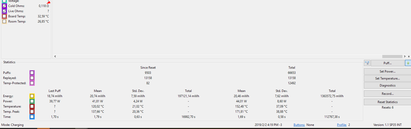

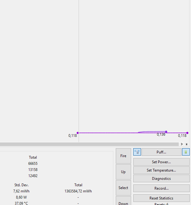

Wayneo Posted February 2, 2019 Report Posted February 2, 2019 Klap Using Device Monitor with Cold and Live Ohms ticked, what are the starting and ending values (while taking a puff)? Replay does not require a material profile. If you want the resistance to change, cut off some of the width (Not the clamped ends).
Klap Posted February 2, 2019 Author Report Posted February 2, 2019 okey, let me give this to you i dont know if i do fine: I fire for 3 seconds i see cold is in 0,118 and when i puff go to 0,136
Wayneo Posted February 2, 2019 Report Posted February 2, 2019 Thanks for the printscreens. It looks to me that Replay should work, and I see you have replayed thousands of puffs. Have you used this same profile successfully to replay other atomizers. EDIT: OR just post a printscreen of Profile 6
Wayneo Posted February 2, 2019 Report Posted February 2, 2019 Ya know, in your original post you said On 1/31/2019 at 7:08 PM, Klap said: But i can't work fine the MESH TCR or Replay. My response was only with regards to Replay, and you show me Profile 2, not 6 (which was bolded), but now you tell me Replay does work. Either way, the csv you posted should just be thrown out. Try to use the standard SS316 material profile on your mod. Edit: Added more info for you I have no clue about your mod and customizations done by the vendor. So this refers to Evolv defaults. In your Profile 2, change the Material back to watts Profile 6 should be your SS316. Try your mesh there in TC Profile 4 is Nickel which you probably don't use, so you can jiggy with that one if you must.
