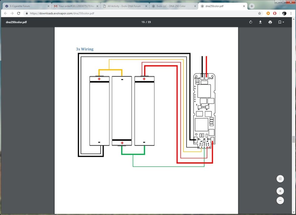

dwcraig1 Posted December 8, 2018 Report Posted December 8, 2018 I don't have an answer for you, I'm curious as well. The pack voltage is correct for 3 cells, does the mod work properly? Here is wiring configuration for 3S, note the bridge from 3 to 4 I suspect you will get an answer shortly from another member/staff

retird Posted December 8, 2018 Report Posted December 8, 2018 You would think logically it would read 0V but it may be reading voltage due to the wiring of the balancing circuit for 3 cells where the T4 pin is bridged to T3. Here is the Data Sheet which has wiring diagrams. https://downloads.evolvapor.com/dna250color.pdf
DanJenZen Posted December 8, 2018 Author Report Posted December 8, 2018 Ok, probably it has to do with the bridge.
