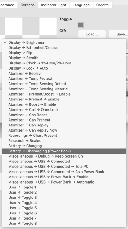

Sure, a couple different ways. There's a whole page setup for pulsing the LED while charging in Theme Designer.
Drill a tiny hole in your enclosure so you can see the on-board LED while charging, or use a clear fire button
Create a toggle (or field) in Theme Designer. Look at the field below the highlighted one.

Wayneo, Zark and Retired, many thanks for your time. It is appreciated. I can see the led fine already but I really want a display where, when it's charging, I can just look over and see the input current and the voltage of each cell without having to interact with the device. It's how I have my 250 set up (apart from the input current). Wayneo, you're a star, I've set up a child screen off of the main screen with the toggle and it works. So thank you for the advice. The only problem now is that the screen stays on but also the led is now also permanently on and is blue. I haven't changed any of the led settings so that should indicate it's firing (it clearly isn't) but is there a way that you can think of to either turn it off or have it set to the pulsating red as in the default profile? It's picky I know but I would prefer to keep the led off then have it on for hours at a time.

No can do at this version. That toggle, like @skineedog mentioned will eventually timeout, but its usage would be to toggle on when charging, toggle off when done charigng. If you don't want to see the blue, delete that firing option. But seriously, if you can see the blue glow, you could learn to embrace the pulse while charging, and the green at the end.
