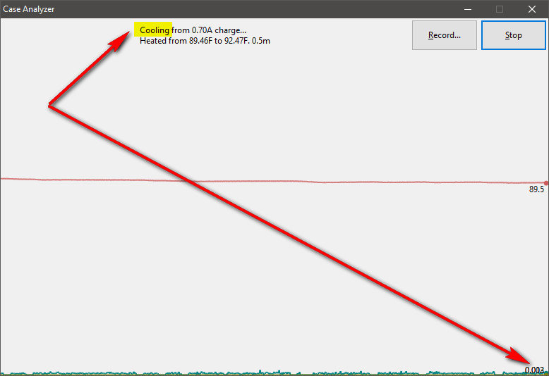

Ran Case Analyzer yesterday with ambient temperature around 72F.. Results are attached. Mod resistance appears to be 0.006 ohm. What I don't like is that even during the "cooling" stages throughout the analysis it was showing a charging going on at 0.001-0.003 amps. Which is not a good sign, really. Screenshot is attached a well.

I've seen several posts saying the same thing.... been pondering what that could be....  3-one-thousands of an Amp....  I have no clue how the board is designed nor about the software and firmware design either.... so.... I ponder what that can be....
Could it be this:
When you charge the device the charging circuit balances the cells and even after the battery charge circuit stops charging you will notice the cells are still being balanced..  Could this be what you are seeing and does it really effect the Case Analyzer results significantly???
That's my best guess (read my disclaimer at the bottom of my post... 😊)

The reason I'm concerned about it is because of THIS video. Bill is saying there that when you see charging while cooling off it means that mod is experiencing "leak-through" which causes mod to heat (even though it's not really charging) which, in its turn, leads to incorrect results of the whole Case Analysis. He also states that he saw it happening in (and I quote) "a mod of a certain Chinese brand that supported 2A charging".  So it's quite possible that Lost Vape is in fact this "certain Chinese mod" with 2A charging. :) In this case he recommends going with default values that mod has since any values we get after running Case Analyzer would not be correct.

The mod he alludes to that has the daughter board 2 amp charger is a Vapor Shark.... Vapor Shark had custom DNA boards made so they could use their own daughter board 2 amp charging circuitry and their wireless charging that they called "Zip "charging ...   As far as I know Lost Vapes never had a daughter board...
So the minute amperage he states will slightly effect the case cooling temperature results..... does it change the final analysis enough to matter?   And could the minute amperage of 0.003 just be balancing of the batteries...????
As far as using the default settings they are not device specific.  All devices have their own case thermal properties. Each mod manufacturer should run analysis on their case and put the correct settings in their devices before shipping them, but many do not do that.

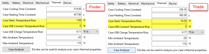

He says it does. However... Below you can see side-by-side results of Case Analyzer for Triade and Finder. When I ran Case Analyzer for Finder there was no amperage during the cooling - it was steady at 0.000 amps. The interesting part is that "Case USB Connect Temperature Rise" values are at 0F which technically should indicate that there was no temperature raise due to this minute amperage. On the other hand, "Case Static Temperature" value for Triade is significantly higher...
Share this post
Link to post
Share on other sites
Do both devices have exactly the same cases made by the same case manufacturer and the devices are exactly the same using the identical parts and batteries?  All of my DNA devices have different thermal results after running case analyzer as the case thermals depend on the case design, materials use to make the case, internal parts used in the design, batteries used,  and etc.    So the two devices you have show different results. What difference in use do you experience between the 2?   In the video Bill said some cheaper mods will have leakage.  You have one with leakage and one with no leakage.  Mod design?  Mod assemble issue?  Something else?  Who knows....
