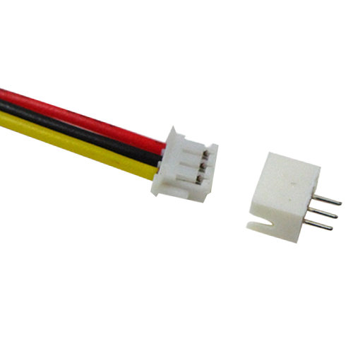

Ah sorry should have specified so I need male or female on the charger. Can’t tell what the batteries use from pictures
Link to comment
Share on other sites
On 6/20/2018 at 9:05 PM, Ak89 said:
Batteries have male. Chargers, female (The connector with pins)

I guess this an example of conflicting terminology....
I usually refer to the board mounted connection as a "header" and the one with wires as "housing" or "plug". However, I tried to answer the OP's question with his own terminology. The male/female thing can get confusing, since many people and shops use the terms interchangeably.
Here is the official datasheet:
http://www.jst-mfg.com/product/pdf/jpn/XH.pdf
Note: Male/female is not used by the manufacturer.
