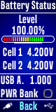

Jetro Posted May 16, 2018 Report Posted May 16, 2018 Thanks niandra3 and Mr Timbit, That pretty much squares me away. And I do my screen shots the same way as Mr Timbit does. They do not show the field lines. But it can be a pita to get the toggles to show the way you want. This is a screen shot taken from TD. JT 1 1
