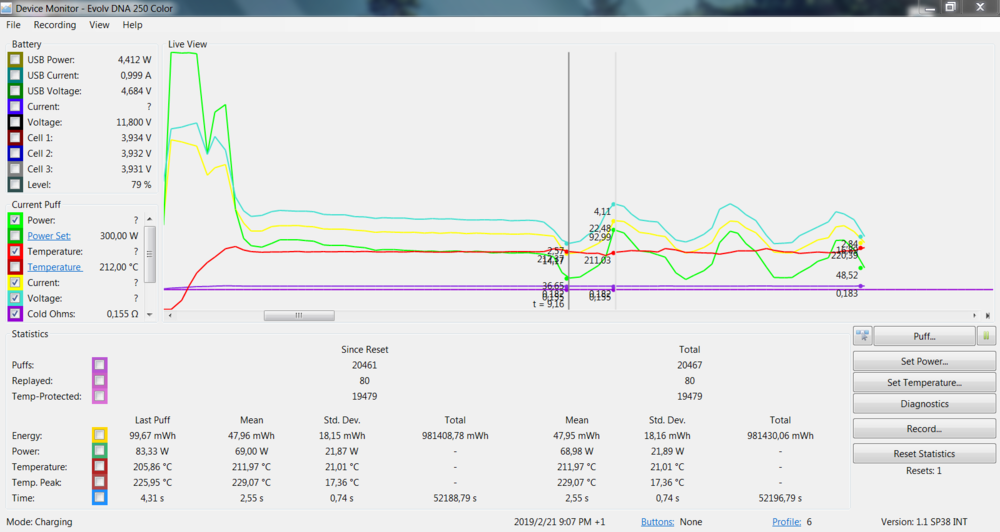

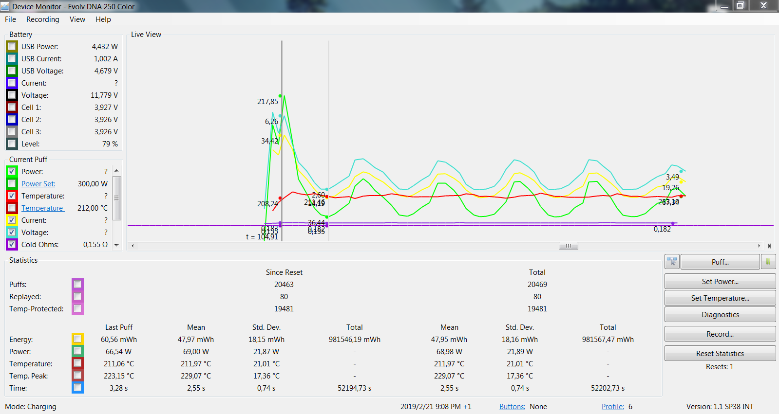

Quipu Posted February 21, 2019 Report Posted February 21, 2019 OK, after satisfaction with DNA I'm hitting some "problem" with TC on Titanium, it starts to be erratic feel that this morning in the car. Like pulsating, on graphs can be seen, any idea what it is or what is the cause? I clean rewick the coils nothing, then hit two or three temps protect, cleaned the 510 contact nothing, roll back to SP 35 same behavior, Screw up another tank with SS same thing, then changed for a new SS coils and the same thing but less sensitive rattling versus on Ti. On Ti it really feels its erratic to the haven. Unfortunately, don't have the graph with Ti. And this is random, can star on the beginning of firing or at the end of it, or all the time of puff, and not every puff some use to be normal. Any idea? Em, I joined in the DNA TC club 😶?

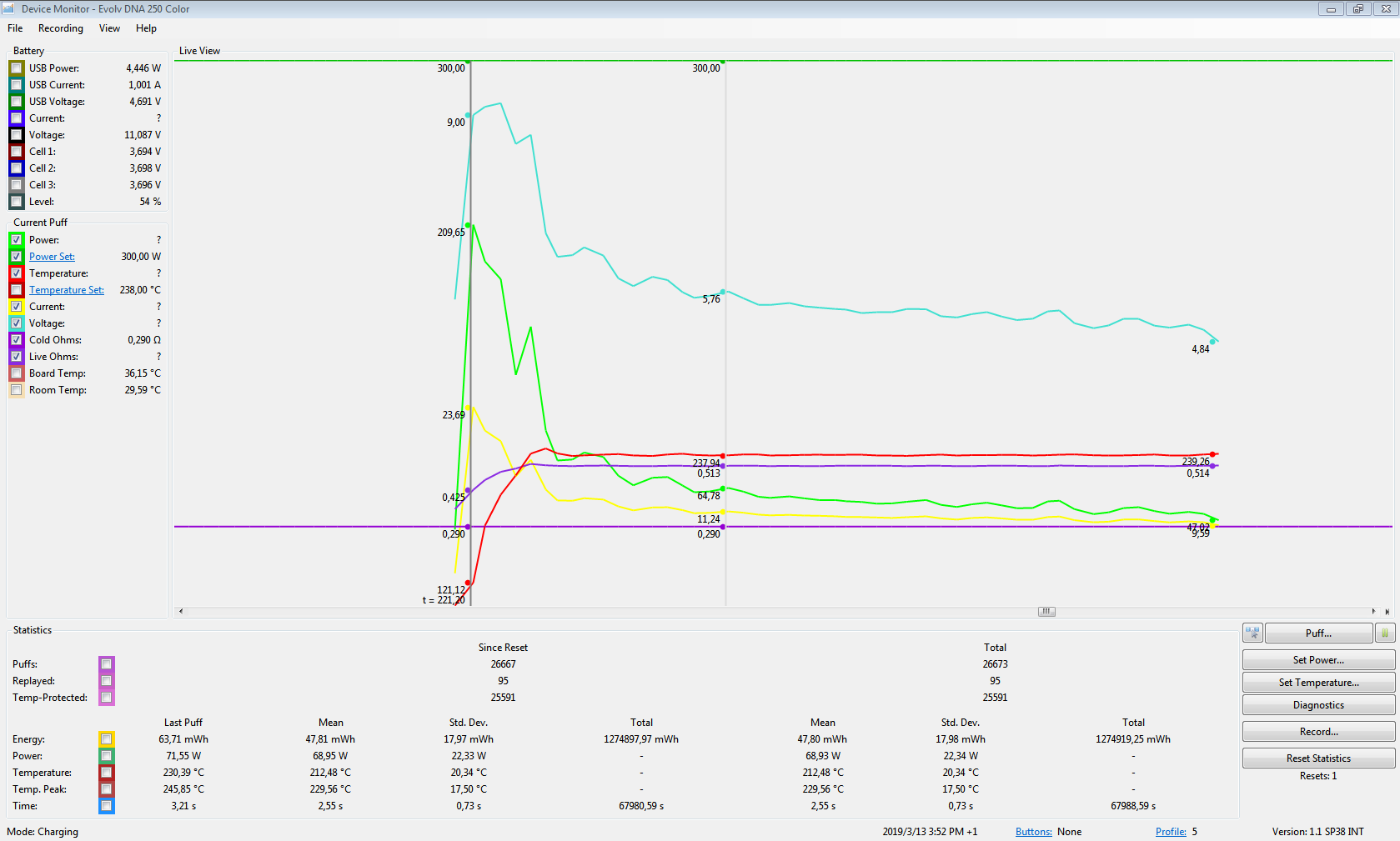

Quipu Posted March 13, 2019 Report Posted March 13, 2019 Just to report that big temp. fluctuation is happening when I vaping my DIY NET e juice. With artificial aromas DNA control temp. much better, like it was. Net gunk much faster, so I hoped that with precise DNA chip, I will have more time between rewicking the coils. Ti graph Regards
Lanzarotechris Posted March 13, 2019 Report Posted March 13, 2019 Well, I would say no wonder about the Temp flux because you've set your power to 300 Watts ! As you (should) see on the graph that after the big spike your coil only needs around 65 Watts to keep the temperature. So why don't you try 70 Watts, and if you have a big fancy coil set some preheat of 80 Watts for the first 1 second ? Then you probably won't have trouble with gunking anymore, because the gunking is caused by that 300 Watt inferno. I bet your coils will thank you too with giving you more life out of them. Just remember: Because your mod CAN do 300 Watts doesn't mean you SHOULD do it ! Also you have longer lasting batteries... so basically its a win-win-win-win situation (no gunk, no flux, longer lasting coils and longer lasting batteries) And it also will probably don't blow up in your face one day, too 😉 3
Quipu Posted March 14, 2019 Report Posted March 14, 2019 (edited) Hmmm, I understand this. I put my thought on this thread, a few posts before. I use all available watts for an instant hit when I inhale the vape like with the real cig. Maybe with higher NIC or PG solution, will limit a TC performance with limiting available watts, and vape will become softer. All other stuff like a Punch, Preheat, Warmth etc. is gimmicky in my opinion. I don't mind how many watts mod needs, for the respective build and selected temp. just want to maintain my prefered temp. and to be instant, keep it simple. For battery concern, I believe that we all buy DNA's because of precision and safety. It looks like we all have our way of using the mod, it's just finesses. Maybe I'm not right, but I'm experiencing that in this way. Regards Edited March 14, 2019 by Quipu
Lanzarotechris Posted March 14, 2019 Report Posted March 14, 2019 Well, then maybe you should stop complaining about gunk and flux and wasting coils,... And please never say: I didn't know that/never heared that before,... etcpp. Sometimes its wise to just accept an advice. Especially when that is a) for free and b) well explained... And NO, the "security/safety" options of a DNA will not safe you from your own stupidity. But I see, you're the cool hero, right ? You have 300 Watts and you're so cool you just lick the posts... Sorry, but you're the kind of type the vaping comunity really don't want ! Because you don't care, and you don't listen and you ignore the given rules ! So do me a favour, don't ask me for any further advice in the future... its wasted time.
