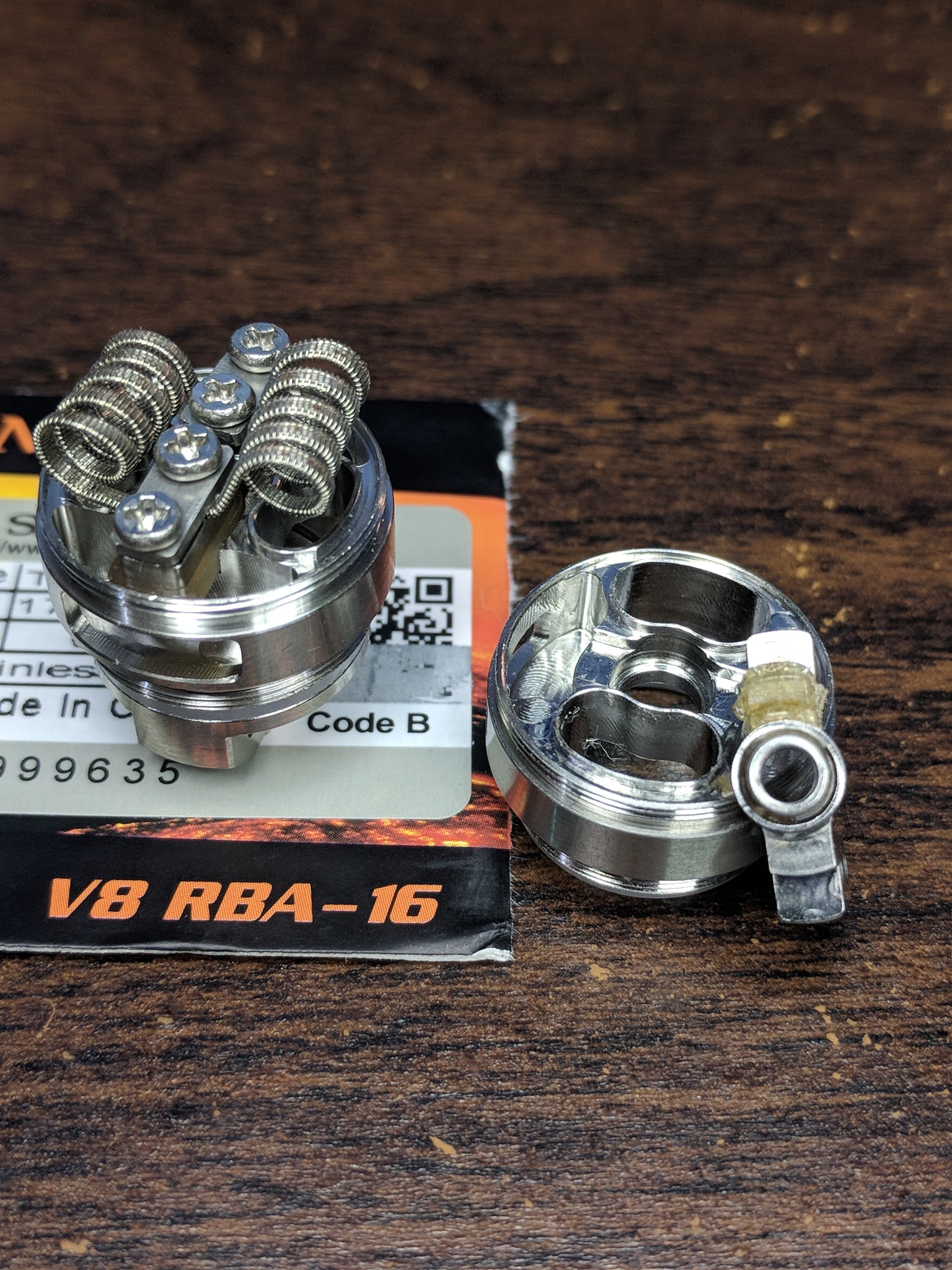

 I've found 2 of my SMOK RBA's have the insulator melted and cracked that was causing me issues with replay. SMOK has a new deck out for the TFV8 that is a clamp style and so far is working well

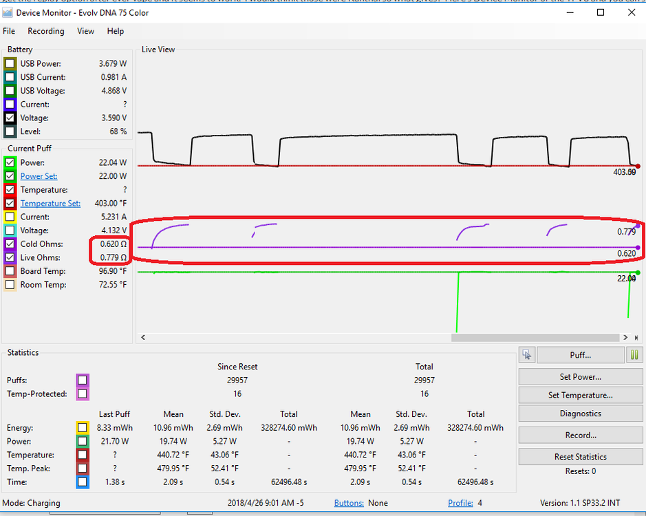

I have slowly learned that you are exactly right.  I had been vaping the RBA we've talking about all day today.  When I got home I put in in front of a fan for an hour or more.  I took it and held it for a bit and started testing the resistance and the fluctuation we're pretty wide.  +/- 0.35!!!
I built this:  and the fluctuation is less than 0.15. and replay is working correctly.  So Evolv might want to make clear how much it can fluctuate.  And can we change it in EScribe on the Mod/Safty tab, "Ohm Lock Range"  Mine is set at 0.25 from the factory.  So if I changed it to 0.36 would replay have worked on that first build that wasn't working?  I wonder.  Don't have the time to dig those out of the trash and rebuild.  Maybe someone smarter than me will chime in like has been happening.
Good to figure stuff out.  Replay needs a solid Ohms reading, no variation.  Got it
Looks SO much better!
Where did you find the new RBA for the TFV8?  ...linkie...  Do you know if the TFV12 is to follow?  Hope so!
Posted
8 hours ago, KMac said:
@iambyrdman not sure on the V12 but here is the link for the V8 https://store.smoktech.com/product/details/v8-rba-16-core
I'm not sure that's it because it has an Ohm rating.  That's the regular V8 coil.
Id ask my SMOK sales rep but I cut them off because of the bad information on the Prince coils.  So sad I can't get an honest answer after busting her for telling me they are 304 when they seem not to be.  What's so hard about telling me what they're made out of?  Sad...
Here's a weird one to add to the discussion... I've been trying to vape up all the juice I have in tanks so I can more on to a new (wonderful) mix and picked up a TFV8 with a prebuilt Q4 coil.  I get the replay option after ever vape and it seems to work.  I would think those were Kanthal so what gives?  Here's Device Monitor of the TFV8 and you can see where it pulls back on power even though there's not temperature readout.  Strange...
