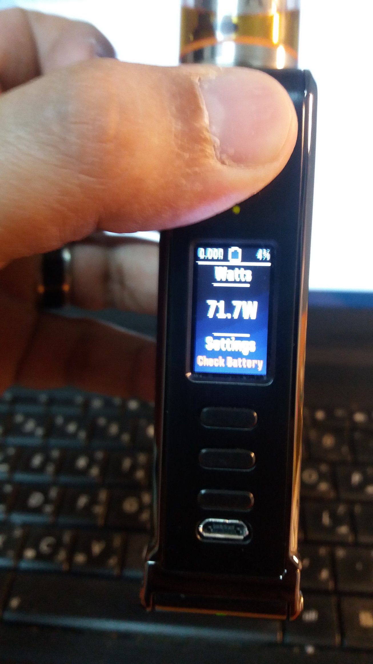

Check Atomizer: The DNA has detected a large resistance change during operation, the atomizer has shorted out, or the atomizer resistance is incorrect for the power setting.

22 minutes ago, drmaz2000 said:
I've a Paranormal DNA 250c which was doing good and then i lost the Replay mode , and when i went for restore defaults from escribe  it keeps telling me " check battery "  .
what happened and how can this be fixed ?!!!!!
You restored the Default Evolv file probably.  You need to go into the Mod Tab and see what the Battery setting is set to.....  A 2 cell device should be set to 2 and not 4 cells (default Evolv setting).  See if that gets you going...

1 minute ago, retird said:
Yep the 250C defaults to 4 cells and the 200 to 3 cells...
What were you doing when you lost Replay?
it was working for some time at first when i got the mod but then after i changed some theme settings it stopped working .. that's  why i did restore defaults settings  hope it would work again !!

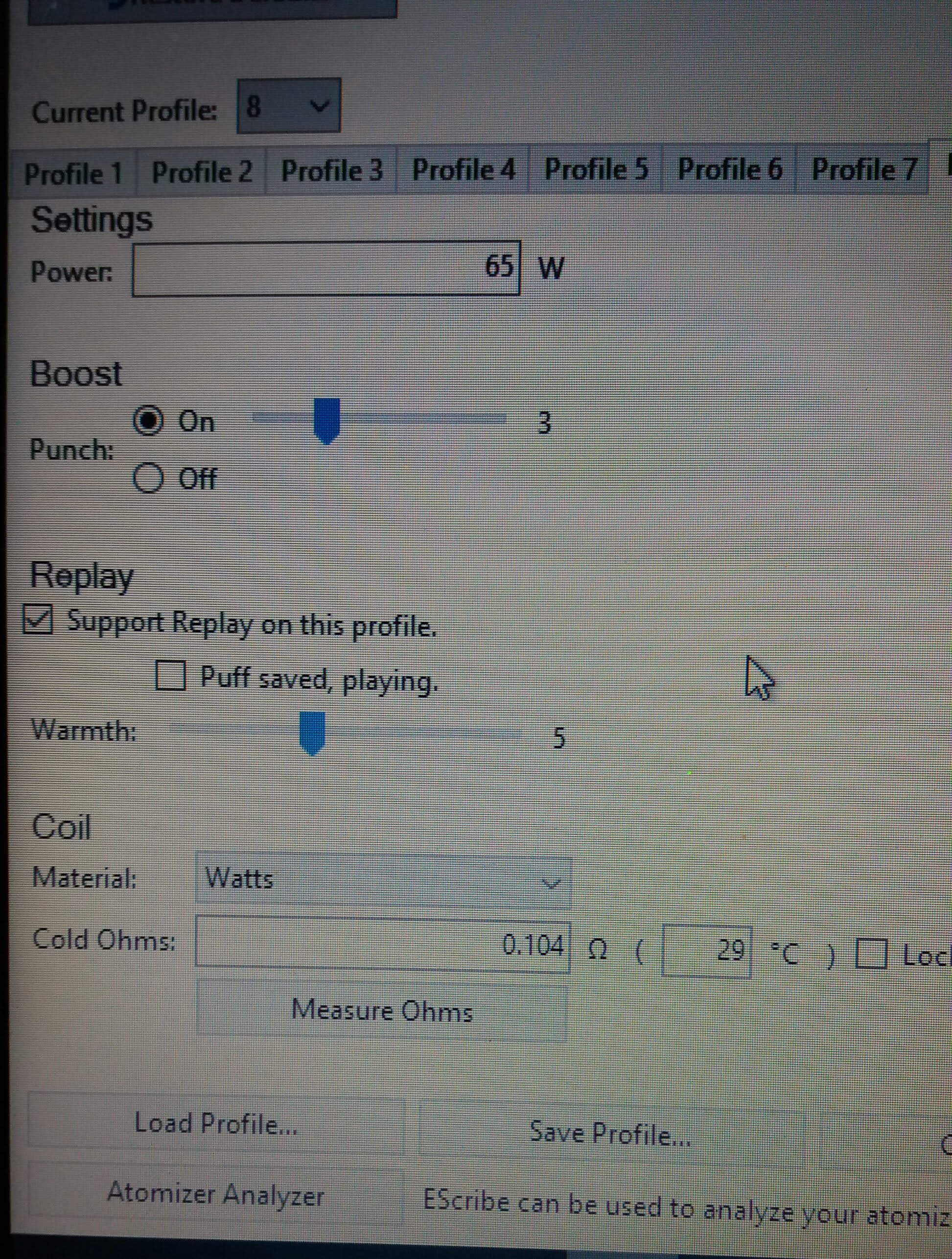

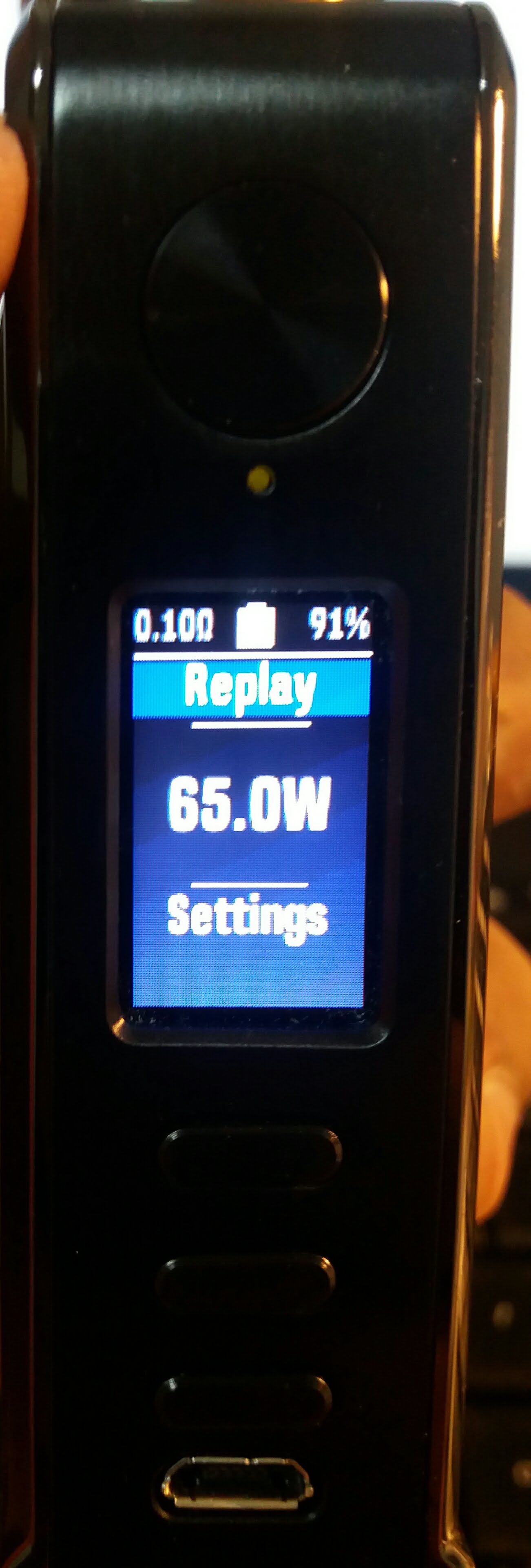

OK.... probably the changes in the theme could have done it.... You now have the Evolv theme I think so make sure the Profile is set to the Replay Profile and make sure Support Replay is checked in the Profile setting... see if that gets you going....
Link to comment
Share on other sites
It's only showing this now  ..

1 minute ago, drmaz2000 said:
@retird  Nothing at all , just like the pic i showed it to you now
I corrected my last post.... Replay as seen on the device is telling you what Profile you are using.... does it vape now with the settings you set in Replay Profile.... what wire did you set in the profile?
