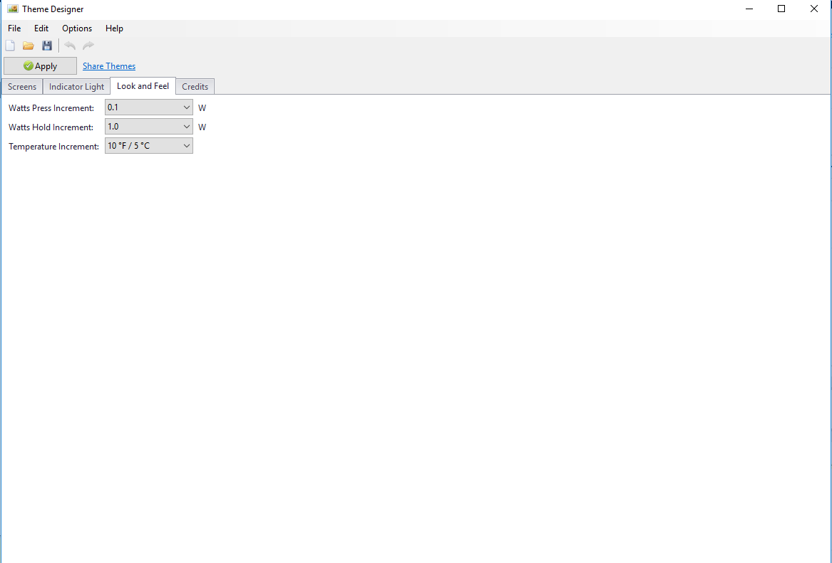

I have been looking for it as well and couldn't find it anywhere either. I do know that it is buried deep in the theme designer but can't find it!!!!. Also what did you set your internal resistance at?. Mine came with it set at 0.04 which seems to high to me. Thank you
Link to comment
Share on other sites
To change Watt Increments, launch Theme Designer and download the theme on your device.
Go to the Screens tab, click Main Screen, click the Watts field you want to change. Go to Source, it will say "Coil power".  Click Options. Change either Decimal Places or Step Size.
Then upload the theme. Should work :)
The "Go to Source, it will say "Coil power".  Click Options." ought to be "double click the Watts field", but it has conditions so that doesn't work. It ought  to be simpler. I'll add getting rid of that step to my To-Do list.

Are you in Watts mode? There are two (overlapping) Watts fields on that screen. One (for temperature-sensing coils) looks like
10W
100F
The other (for non-temperature-sensing coils) is centered and looks like
10W
(Only one of the two shows on the real screen, depending on whether or not the profile's material is temperature-sensing.)
Thank you very much, I now have 1 watt increments.
