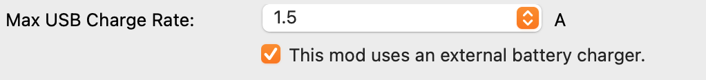

arvelo Posted August 3, 2023 Report Posted August 3, 2023 i need to disable usb charging everytime i connect it to my mac. how can i fix it?
arvelo Posted August 3, 2023 Report Posted August 3, 2023 6 minutes ago, Wayneo said: What chipset in your mod? dna100c - steam crave hadron mini
Wayneo Posted August 3, 2023 Report Posted August 3, 2023 escribe -> mod -> battery tab. Shuts off internal charging completely. Upload settings to mod. 2
