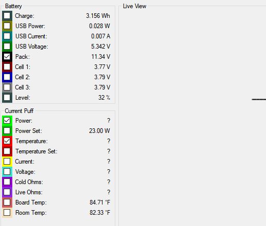

shehabismail Posted January 18, 2018 Report Posted January 18, 2018 Hello. I own a VS 250, it came with the Fullymax 11.1v 3S 900mah 30C LIPO. After couple of months it stopped charging and when I opened Escribe device monitor I found that 1 cell was @ 3.7 volt and the other 2 were too low @1.7 Volts. I purchased new exact lipo and when i replaced the dead lipo it says its charging now at 0.001 - 0.007 Amp or lower as you can see on the screenshot attached. I am lost and i dont know what else to do, any help appreciated.

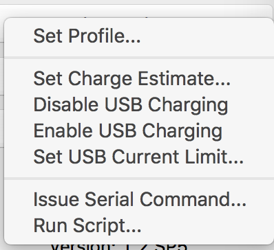

VapingBad Posted January 18, 2018 Report Posted January 18, 2018 Check Device Monitor - Diagnostics - Enable USB Charging as nothing to stop it charging in that screen shot.
shehabismail Posted January 18, 2018 Author Report Posted January 18, 2018 Have you seen the amp rate its charging with? 0.007!! I also tried the usb recovery charging 4 times and still the same behaviour
VapingBad Posted January 18, 2018 Report Posted January 18, 2018 4 minutes ago, shehabismail said: Have you seen the amp rate its charging with? 0.007!! I also tried the usb recovery charging 4 times and still the same behaviour Yes, that's why having disabled USB Charging in Device monitor would explain that, hopefully that is the answer.
shehabismail Posted January 19, 2018 Author Report Posted January 19, 2018 ok what should i choose from there?

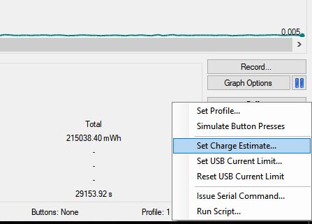

shehabismail Posted January 19, 2018 Author Report Posted January 19, 2018 I tried the reset usb current limit still same issue is there

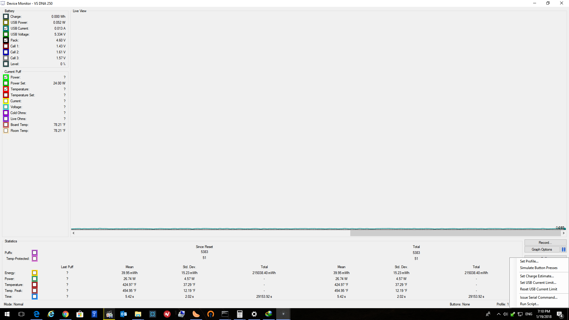

Wayneo Posted January 19, 2018 Report Posted January 19, 2018 @shehabismail In escribe v2.x there's a clear disable/enable USB charging. Can you post a FULL printscreen please. Does the mod display show a charging icon, after say 1 minute? Apart from the thicker +/- battery connector, did you plug in the smaller one (usually white) with 4 thinner wires? 1
shehabismail Posted January 19, 2018 Author Report Posted January 19, 2018 @Wayneo No charging icon. I redownloaded escribe, same version i had previously installed. Full screenshot attached with the options I get when I click on Diagnostics
Wayneo Posted January 19, 2018 Report Posted January 19, 2018 2 hours ago, Wayneo said: escribe v2.x there's a clear disable/enable USB charging Couple things. Look at your voltages now, I'd stop using the mod till you get this sorted. What version of escribe? If it were charging, that 'Mode' (bottom left would say charging). 2 hours ago, Wayneo said: Apart from the thicker +/- battery connector, did you plug in the smaller one (usually white) with 4 thinner wires? You might wanna check that
shehabismail Posted January 19, 2018 Author Report Posted January 19, 2018 @Wayneo usb voltage is @ 5.337 volts i am not using it since i posted yesterday i had half of battery left and now its fully drained without usage (no way to shut down the mod except taking the battery out). I did attach the smaller white 4 pin one other than the negative and positive

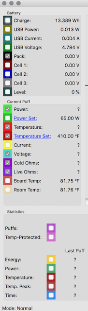

Wayneo Posted January 20, 2018 Report Posted January 20, 2018 No idea at all. Here's a screenshot with my Lipo JST unplugged. No icon on screen. Mode shows normal, all cells show '0', and small USB current. Are you sure you're replacing that connector where the OG was plugged in? I haven't seen the internals of a VS.

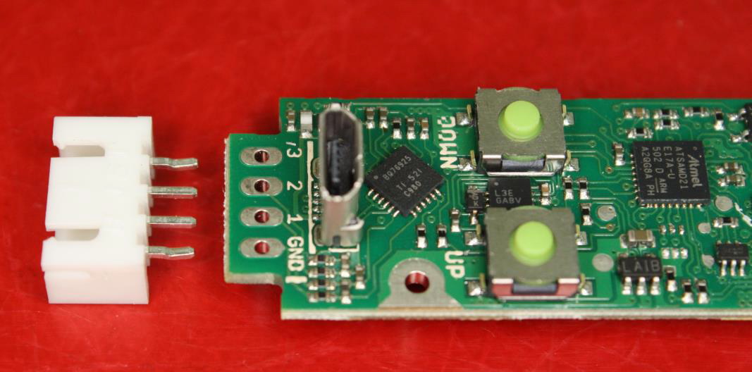

shehabismail Posted January 20, 2018 Author Report Posted January 20, 2018 @Wayneo I gave up and went to a local vape shop for repair. They suspect the issue is with the Charge IC above the usb port in attached photo they said they will try to work it out
