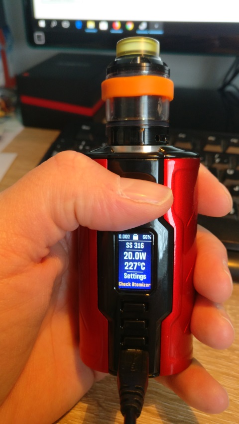

Robin6236 Posted December 26, 2017 Report Posted December 26, 2017 Hello together, my Paranormal 75c shows Check Atomizer or No Atomizer when an Atomizer is installed. The tested Atomizers work on all of my other mods! When I take out the batteries and wait for like 10 hours it works for 10 Puffs and then the problem comes. It isn't saying something like too hot or something else before the problem comes. I tried to downgrade it to very old Service packs and deleting all the settings on the mod but nothing helps. Please help me because I don't know what to do. With best regards Robin6236
giz_60 Posted December 26, 2017 Report Posted December 26, 2017 The Paranormal's have been having issues due to LV using a loctite compound on the threads of the 510 connector. This could very well be causing the problems you are describing. You can read about it & a fix here....https://forum.evolvapor.com/topic/69140-paranormal-75c-resistance-too-high-fix/ Or you can open a ticket with Evolv & let them guide you...https://helpdesk.evolvapor.com/index.php?a=add&category=1
Robin6236 Posted December 28, 2017 Author Report Posted December 28, 2017 Yeah, I thought so too but I wasn't ready to void my warranty. I send it to Evolv and they told me that some Paranormal Devices, in particular, have this problem. It is just hard to guess if it is a hardware failure or a chip failure. I thought it was a cold soldered point but that can't be because it works perfectly for like 10 puffs after 10 hours without batteries. Still thanks for your help. I just thought it would be the best way to send it to Evolv because they are pros.

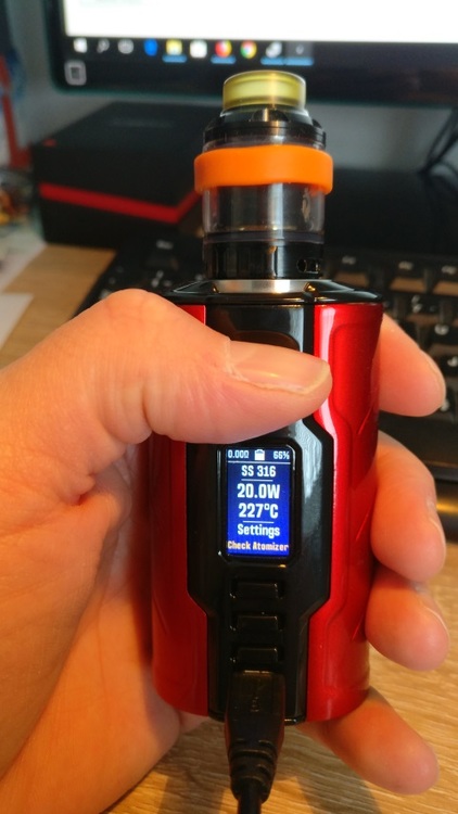

krucymucy Posted January 4, 2018 Report Posted January 4, 2018 Hi there! New mod was delivered to me half an hour ago. I've unpacked it screw the atomizer on top of it and I have this very same problem. "Check atomizer" I've tried with two different tanks which on the other mod I have work properly. On the device I can't even measure resistance in escribe software it says "failed to measure coil Ohms" Atomizer analyzer only show mod resistance 0,004 ohms and question mark sign on atomizer resistance Device is brand new and it says service pack 25 is installed. Anyone has any ideas or should I contact the seller? kind regards
giz_60 Posted January 4, 2018 Report Posted January 4, 2018 If you have a Paranormal, there is a known issue with them. Read this post...it can also be causing the problem you are describing.....https://forum.evolvapor.com/topic/69140-paranormal-75c-resistance-too-high-fix/

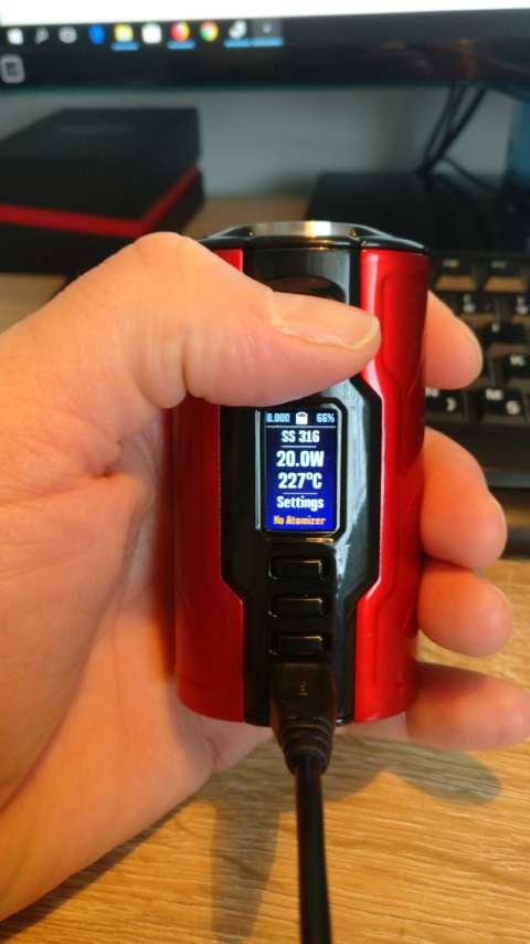

krucymucy Posted January 4, 2018 Report Posted January 4, 2018 It's not LV Paranormal it's Vapecige Creator DNA75C. And I noticed it says no atomizer with atomizer removed and check atomizer if atomizer is on the mod.
giz_60 Posted January 4, 2018 Report Posted January 4, 2018 Sounds like there is a connection problem between the board & the 510 connector...seems it is new, I would contact the seller about a warranty exchange...
krucymucy Posted January 4, 2018 Report Posted January 4, 2018 Yes but mod sees the difference with or without atomizer. So there is a connection.

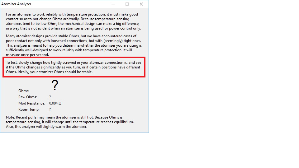

retird Posted January 4, 2018 Report Posted January 4, 2018 If I recall correctly the Mod Resistance value shown in the Atty Analyzer is just the setting your device is set at rather than an actual live reading.... You can check the device setting in the Mod Tab/Electrical tab and yours is set to 0.004.... If you change the setting to 0.003 and upload it then the Mod Resistance in Atty Analyzer will change to the new setting you just changed. In short, there is no atty or no tool screwed into the 510 thus you have a question mark.....probably a connection issue with the 510 connector or wiring to the 510 connector is my best guess without having your device to troubleshoot.... As @giz_60 noted to contact the seller or start a ticket with Evolv... good luck.... let us know what you find out...
krucymucy Posted January 4, 2018 Report Posted January 4, 2018 Atomizer analyzer is showing realtime resistance. I had two dna75c devices before.
retird Posted January 4, 2018 Report Posted January 4, 2018 Go to Mod Resistance... change to 0.00 and upload to device and see if you still have 0.004 shown in Atty Analyzer...

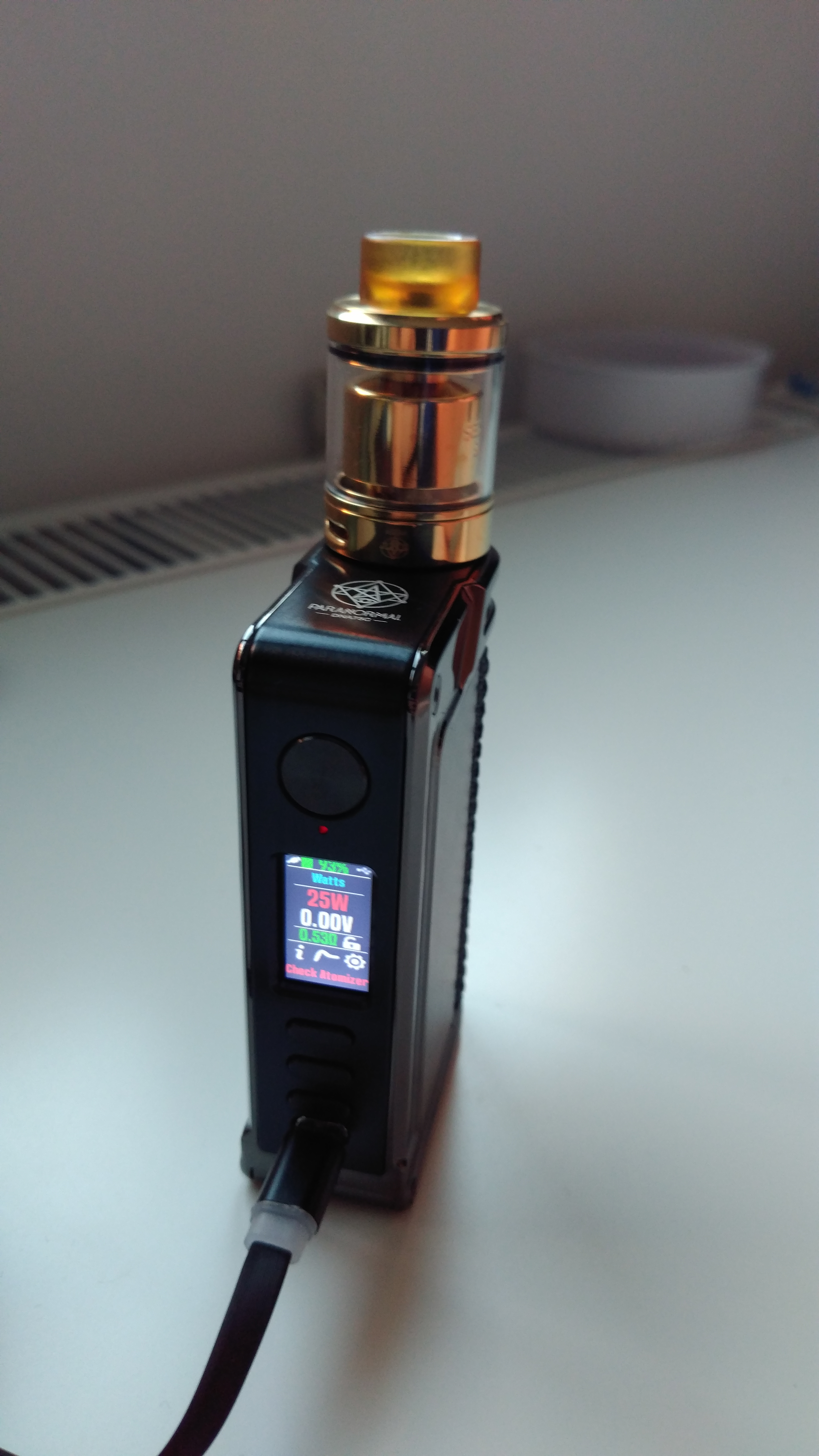

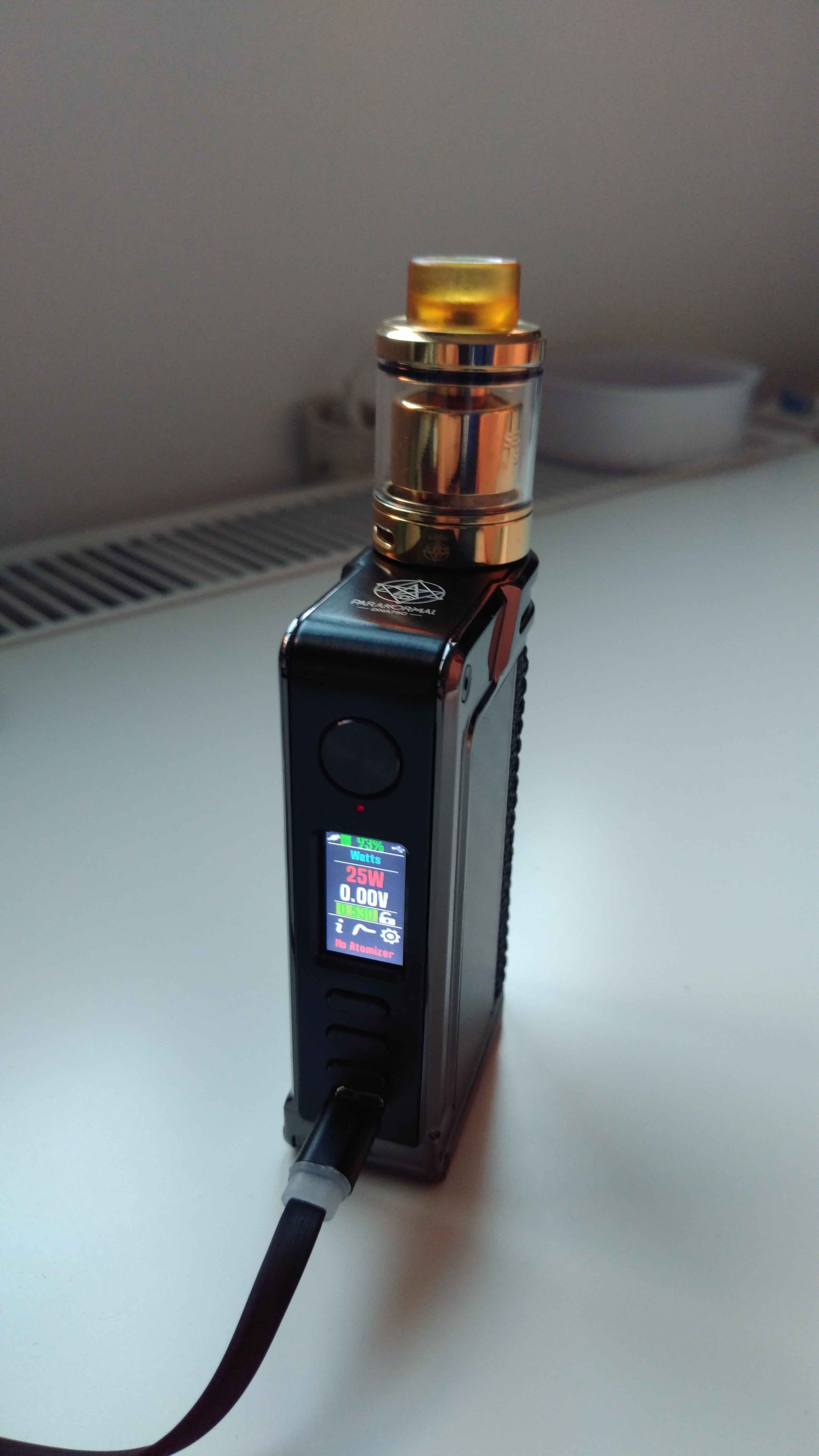

krucymucy Posted January 4, 2018 Report Posted January 4, 2018 It doesn't matter how I set it manually result is the same. here are some photos for better understanding. This is from escribe "general" tab > measure ohms Normally you get real time resistance reading from this. (other two DNA75C devices I had in the past) Atomizer analyzer also reads real time resistance continuously I also suspected 510 connector, but there is a difference with atty installed or removed ... without with
retird Posted January 4, 2018 Report Posted January 4, 2018 I guess you did not want to do what I mentioned.... A tool is needed to set Mod Resistance thus the Atty Analyzer Mod Resistance is not a live reading as far as I recall... From your last post it failed to measure the ohm's.... my best guess is still a connectivity issue.... is there a good connection from the atty 510 to the device 510? What atty's are you using.... some atty's can give this issue also by their design...
krucymucy Posted January 4, 2018 Report Posted January 4, 2018 (edited) I've tried few atomizers. Once again on other two DNA75C devices I had atomizer analyzer is showing real time resistance. I actually ordered two identical mods, the other one for my friend and that one is working as it should. Guess I've unpacked the wrong box. Edited January 4, 2018 by krucymucy
giz_60 Posted January 4, 2018 Report Posted January 4, 2018 (edited) The .004 is NOT a live resistance reading, but rather what the Mod Resistance that is set at via Escribe...@retird was trying to get you to set it to 0 to show you that Edited January 4, 2018 by giz_60 Edit
