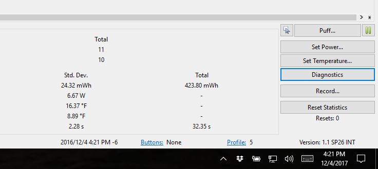

giz_60 Posted December 4, 2017 Report Posted December 4, 2017 Hey retird...check out the date in Escribe & the date on my computer in this screenshot...looks like Escribe is reading the date wrong?
retird Posted December 4, 2017 Report Posted December 4, 2017 That is strange??? Have not seen this before..... I didn't load the theme you guys did and guess what.... my theme shows the same thing..... may be a bug not noticed before??? Guess we all are using the INT version of EScribe....?? I'm gonna load another different ecig file and check it out...
giz_60 Posted December 4, 2017 Report Posted December 4, 2017 On 12/4/2017 at 10:30 PM, retird said: That is strange??? Have not seen this before..... I didn't load the theme you guys did and guess what.... my theme shows the same thing..... may be a bug not noticed before??? Guess we all are using the INT version of EScribe....?? I'm gonna load another different ecig file and check it out... Expand Have you tried changing the date manually on your device yet?
retird Posted December 4, 2017 Report Posted December 4, 2017 Yes.... I can change date on-device and goes incorrect in Device Monitor.... I'm gonna turn off Internet sync and see what that does...
retird Posted December 4, 2017 Report Posted December 4, 2017 Turning off Internet sync didn't help.... I can keep 2017 on the device until I run Device Monitor then it goes to 2016.... thinking it's a bug since it happens on multiple different ecig files.... James may want to chime in.... Note: on my device I need to adjust year to 2018 to get it to set at 2017..... gotta go for a few hours....
giz_60 Posted December 4, 2017 Report Posted December 4, 2017 On 12/4/2017 at 10:50 PM, retird said: . Note: on my device I need to adjust year to 2018 to get it to set at 2017..... Expand I am seeing the same here...really interesting because I have run the Device Monitor on all my 75C's many, many times & have never seen this before....
retird Posted December 5, 2017 Report Posted December 5, 2017 I've not seen this before either or just didn't notice it....been away from the house for about 4 hours and date on device stayed @ 2017 while vaping these 4 hours... hook up to Device Monitor and poof it's back to 2016.... EScribe Version 2.0 SP9 with Version 1.1 SP27 INT

Floh85 Posted December 5, 2017 Author Report Posted December 5, 2017 so have tryed to change service pack, back to default. have try other theme, same thing. thing is happend when change date it jumps from 2017 to 2016, dont get it off. escribe have wrong date too. so for me i hate those crazy things
James Posted December 5, 2017 Report Posted December 5, 2017 Turns out this is an off-by-one error in the real-time clock code affecting the month of December. (If you change your PC clock to another month and then run Device Monitor, it will work in any other month. It's related to PC-synchronized time, not on-device time.) I will be fixing it in the next Service Pack. Thanks for finding this! 1
