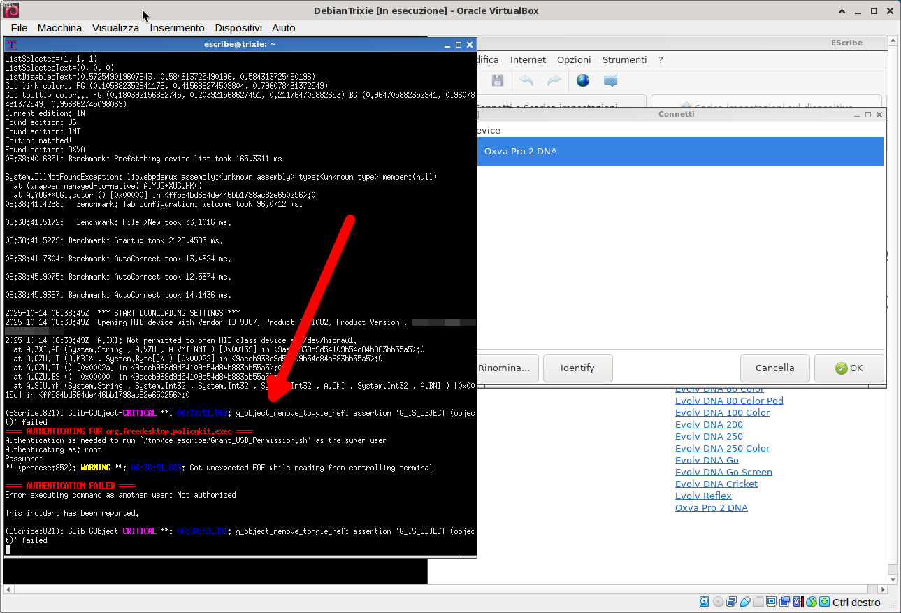

Magigamix Posted yesterday at 03:58 AM Report Posted yesterday at 03:58 AM 9 hours ago, James Bellinger said: @Magigamix, what device are you downloading settings from? That is not a Linux-specific error. Is it a DNA Go or Reflex by any chance? Yes ! It is a Tek Division mod: Shred v3, which uses a Dna Go board. 5 hours ago, James said: I've posted up a version that fixes the bug with DNA Go and Reflex. If that's the problem you were having, it should be fixed now. Let me know God bless. James Thank you so much. I just tested the new version (SetupEScribe2_SP71_INT.run), it fixed the error, now it works perfectly.
