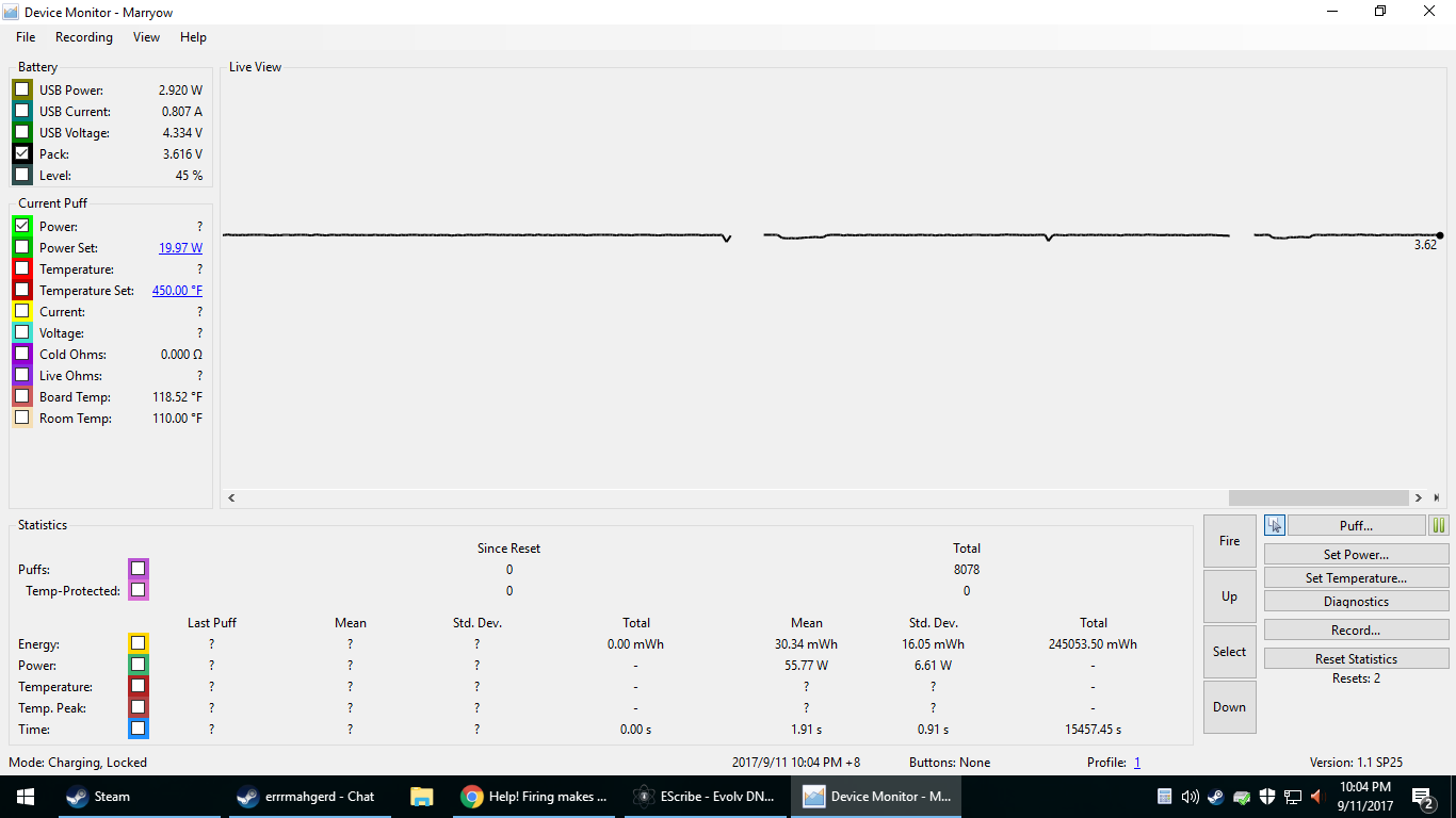

Help! Firing makes the device locked

Honestly this is what happened. night before i sleep. my battery is at 20% and forget to remove and charge. Checked it when i woke up and theres no power so i changed the batteries with my spare one and thats when it started. i really dont know the reason. but i will look for a firmware/software upgrade and see if it helps.
