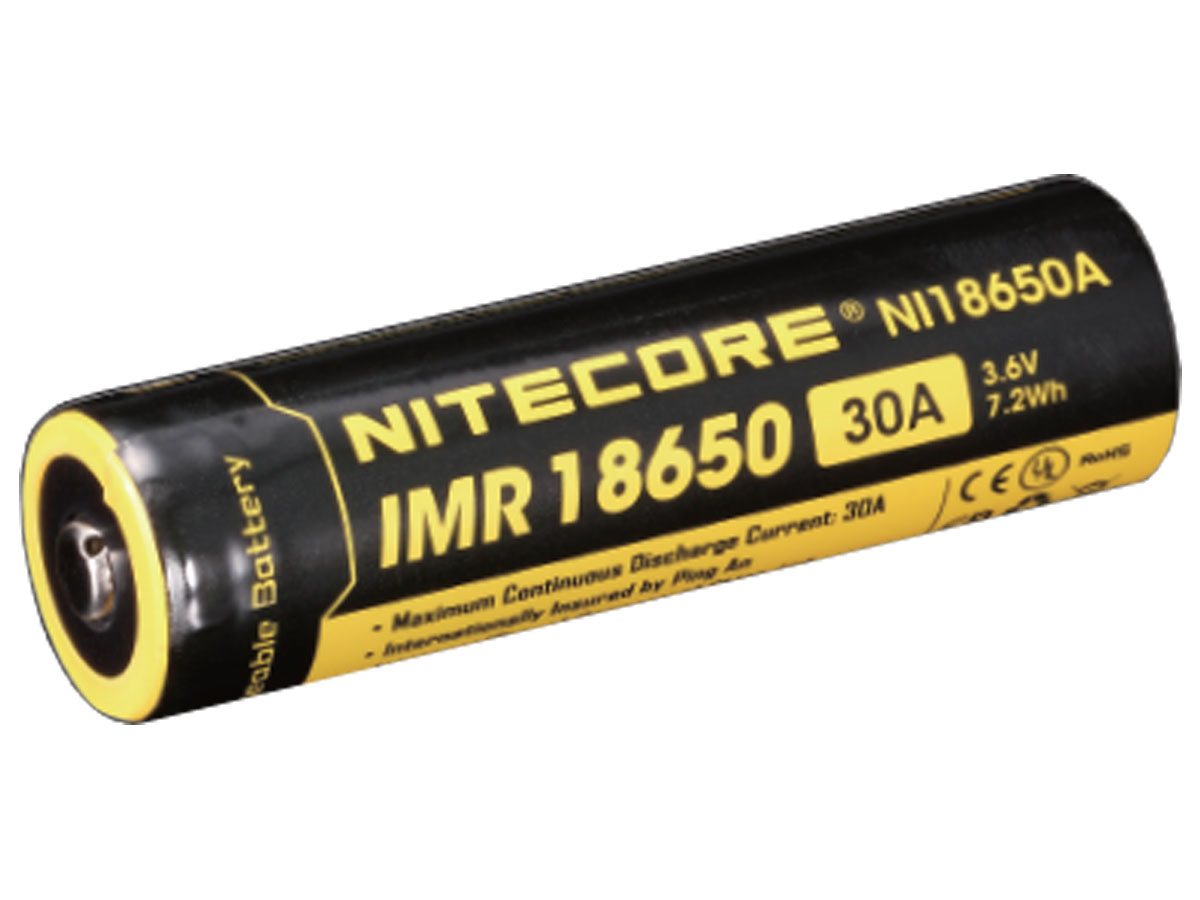

1 hour ago, timbuc2dan said:
Is anyone using the new batteries with the PCB Protected Board built into the battery?
With the addition of the PCB the battery becomes longer than 65 mm.
Then perhaps the user decides to screw in the battery cap till it's flush......Bingo....the problem arrives.
Example:
  • Typical Capacity: 2000mAh
  • Nominal Voltage: 3.6V
  • Discharge Voltage: 2.8V
  • Charging Voltage: 4.20+-0.05V
  • Max Continuous Discharging Current: 30A
  • Dimensions:
    • Length: 66.9mm
    • Diameter: 18.30
    • Weight: 46g

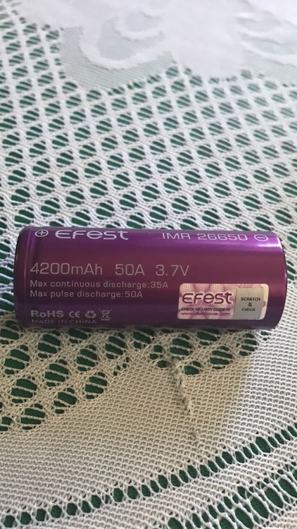

Ok everyone, FWIW I decided to try the  EFEST 26650's to see if it was ok to use them and so far so good, they fit with the battery cap screwed all the way in. When I bought the 1st VTC75 Color mod I got it from Fasttech which normally has about a 30 day haul from China but mine took 3 wks longer they told me, due to HCigar making new ones. Maybe they fixed the problem or it's the li-ion batteries coming in different lengths voltages etc, the EFEST are 65mm+1mm for the crown at top and that was told to me by the seller. The mod has never gotten hot, the bottom of the atomizers/tanks I'm using - Vaporesso - only in 32 wattage mode, only get warm if I'm chain vaping from stress, old cig smoker bad habit. I had two of these mods anyway since nothing sticks around very long in vape world and I'm very happy with mine. It would be nice to know more info about the ones that failed, were they adjusted using the escribe settings, were they using rta's and when were they bought, I got mine in August ordered it July 3rd took 4 wks to ship, got 2nd one from MVS and they as well as any other sites I checked, also didn't have them in blue/available till August, that's why I'm wondering if HCigar fixed them. The only 26650's in that 65mm size were the EFEST'S and the brand of batteries they show on Fasttech site next to the mod in their pic, all others are too long. I also read about other mods having problems with the 26650's and wonder if it's more of a battery issue. They also have these new types now, deep cycle lithium ion phosphate batteries that last much longer and give a constant drain, solar lights are one use for them and one manufacturer used the words non-combustion or explosion which tells me that obviously li-ion batts in general are potentially dangerous items and who makes them matters, meaning it's better to go with name brands than those blue or green no brand ones, and I've read that elsewhere also. So, I'm not saying what you should do, just giving my experience with them is all and it is great being able to go all day into the night with just one 26650. Sometimes it's better to spend a little extra coin. Anyway, that's it I'm keeping mine and using the EFEST 26650's, will post if anything changes. Vaping with Crystal Canyon Vapes My Cafe Blend.
