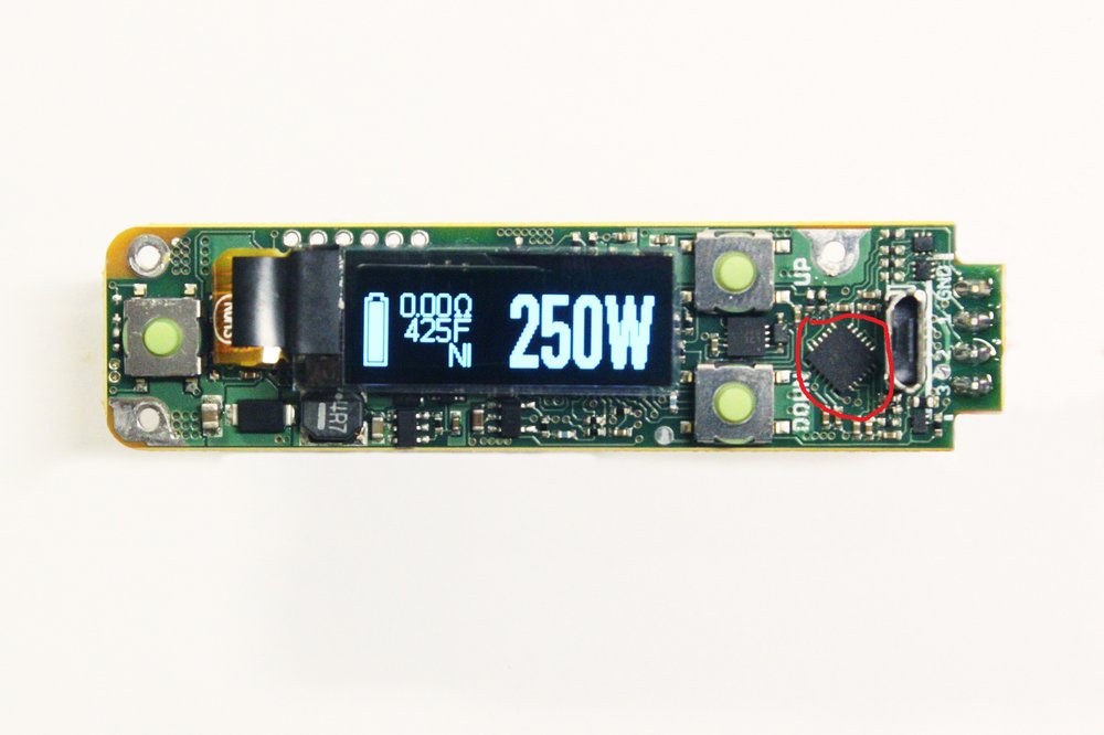

you want the analog front end IC?  this is the IC - http://www.ti.com/product/BQ76925 - bq76925 VQFN (24) 6.50 mm × 4.40 mm
mouser or digikey will most likely have them in stock...... you will need a hot air station to replace and SMD rework experience, not easy to reflow without proper heat shielding protecting other nearby board components from burning/melting FYI.

First off, @Sovan you know Evolv warranties the board for 1 year. Even after one year it is still worth sending them an email about your situation. You never know, they might still help you out. The only reason i posted the link for the analog front end IC is for people who have experience with Hot Air Re-work stations and have a good understanding of soldering SMD components. This IC replacement is not for the average person who owns a soldering iron. I have experience re-flowing small BGA and QFN  packaged IC's.
RGE Package
24-Pin QFN With Thermal Pad
