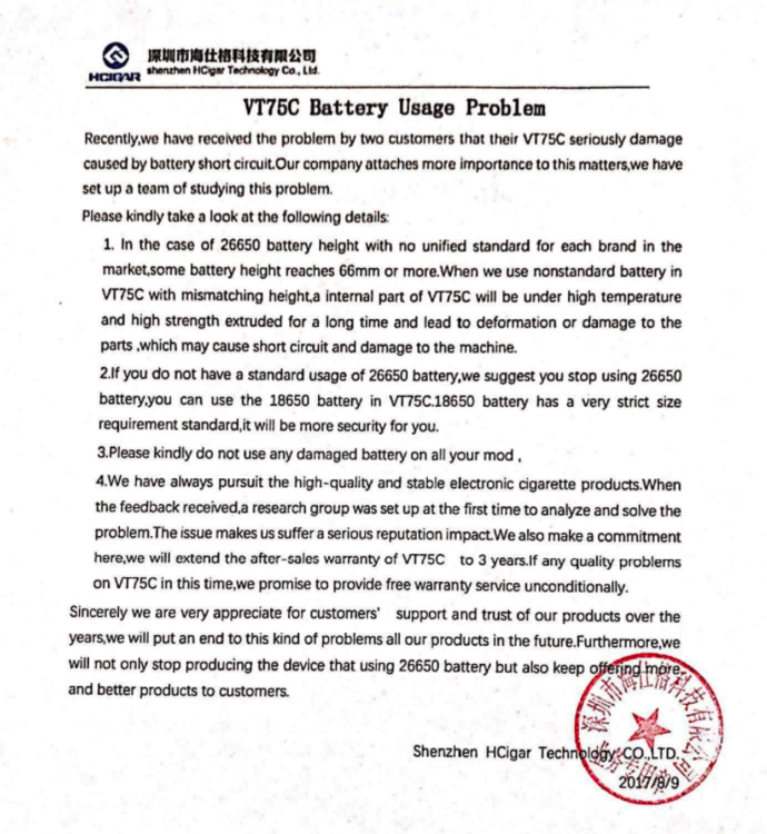

Lowbytes Posted August 3, 2017 Report Posted August 3, 2017 Please note the actual warning about 26650 cells using in the VT75C !
