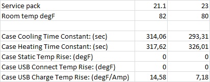

Posted (edited)
hello attached my results on Therion DNA75C
Sorry if this is a stupid question (I'm new on DNA stuff) but do have i to calculate the static delta temp manually ?
Regards
Francesco

Posted
No, case analyzer works correctly (finally) in this version. There's a bit of discrepancy depending on whether your theme charges with the screen on or off, but that's a couple degrees at most.
However, the default case thermals for the board are definitely wrong in most devices. So changing them manually to approximately what I posted above is recommended if your room temperature is significantly off. We'll push a device-specific update when these changes (and any others that show up while testing this one) get pushed to all users.

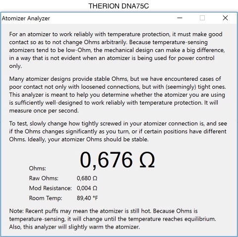

Well, I'm pretty much confirming all of the above:
1) SP23 improved "precision" of cold ohm sampling. Note I used "precision" as what has improved is the stability (or repeatability) of the measure. If I take several samplings, I get much more consistent and similar values (barring the physiological slight increase due to the measurement slightly warming the coil) than before (where it was more jumping here and there across different back-to-back measurements)
2) SP23 doesn't seem to have improved "accuracy" of cold ohm sampling: I took the same atomizer (a TC-friendly one, with no springs, direct center-pin-to-post positive path) with a SS316L coil on the therion 75C, the vaporshark 200 and an EvolvReferenceMod 200 and you can see the output from AA here below.
Keep in mind real room temperature is ~86F, so the ERM is the most accurate as far as room temperature goes.
The headline is: the 75C still reads lower, _my_ therion seems to be ~ 0.024 below (instead of 0.04), but that's still enough to swing the temperature by ~60F with SS316L. Unfortunately at the moment I don't have my other 75C which is out for repair, so I couldn't put that to test as well.
Oh, as a final note, manually correctly the cold ohm value on the 75C, brings the temperature value I have to use back to its normal 390/400F range, instead of the "tuned-by-taste" 475F value I need after a "real" cold ohm sampling.

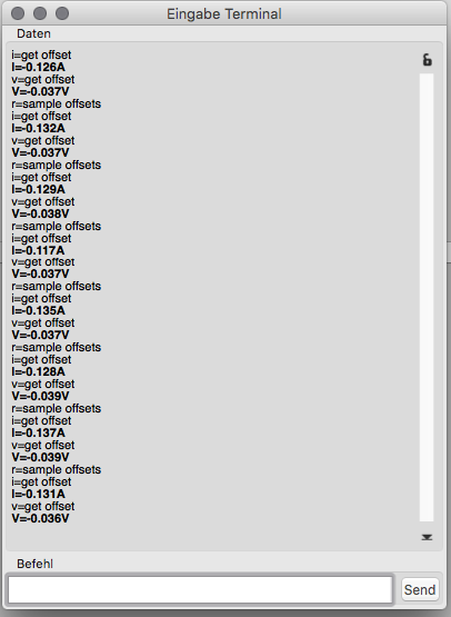

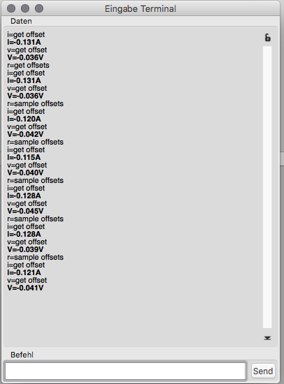

Just want to rule something out... If you go into Tools -> Serial Terminal, what does it say if you send the commands
I=GET OFFSET
V=GET OFFSET
? (You will need to have fired a coil at least once for these values to not show up as 0.000.) Also, how did you power-up your device from cold? From USB? Fire button not connected to USB? Most importantly, what happens to the current and voltage offsets above if you send the command
R=SAMPLE OFFSETS
? I get -0.101A and -0.033V the first time around, and -0.109A and -0.031V the second.
Thanks!

Posted
Hi @James
just tried this on the therion 75C I used in the comparison in my previous post and I get these
1) After a couple of puffs: I=-0.156A, V=-0.037V
2) After R=SAMPLE OFFSETS: I=-0.154A, V=-0.045V
I just unlocked it with the unlock sequence, then connected to Escribe and issued the commands you suggested after firing (I fired while connected to USB, for that matter).
I also realized I did this with the cold ohm value manually corrected to 0.695 (as it was reported by Vaporshark DNA200) instead of the 0.676 that coil sampling would have produced.
I don't know if this makes any difference and/or impairs the results in any way. If you need me to do it again with a standard sampled value for cold ohms, just let me know and I'll let the coil rest for a while and repeat...

I also get case static temp rise 0 degrees here when running case-analyser with the latest early sp.
