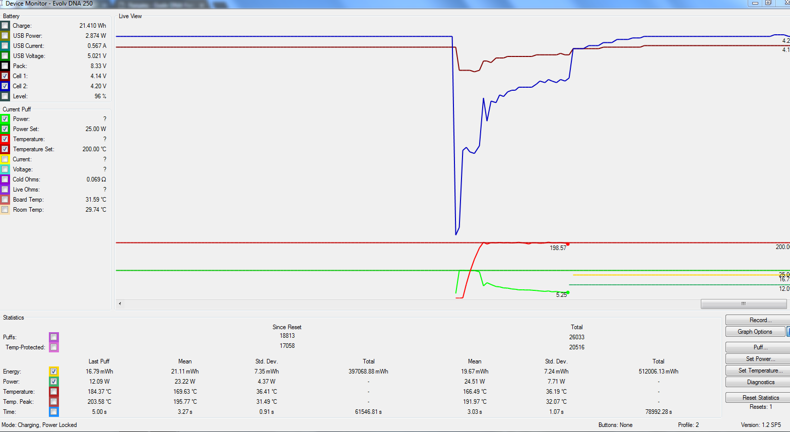

Omranr Posted May 27, 2017 Report Posted May 27, 2017 I've read couple of threads regarding the thereon 166 issue "battery Check" and " Imbalanced batteries" although they are brand new and tried many other pairs of batteries, any solution for this frustrating issue ? appreciate your help reading on Escribe looks normal for both cells

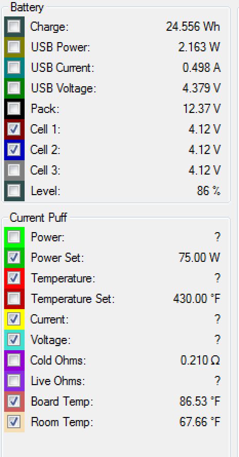

Wayneo Posted May 27, 2017 Report Posted May 27, 2017 (edited) Can you post a full 'Device Monitor' printscreen while firing and this is occuring. Image shows what to have 'ticked' (Include cell 3) and Power, not Temperature, sorry. Include another printscreen of your 'Mod' tab, and finally, what are your battery details (make and model). Edited May 27, 2017 by Wayneo Ticked box clarification

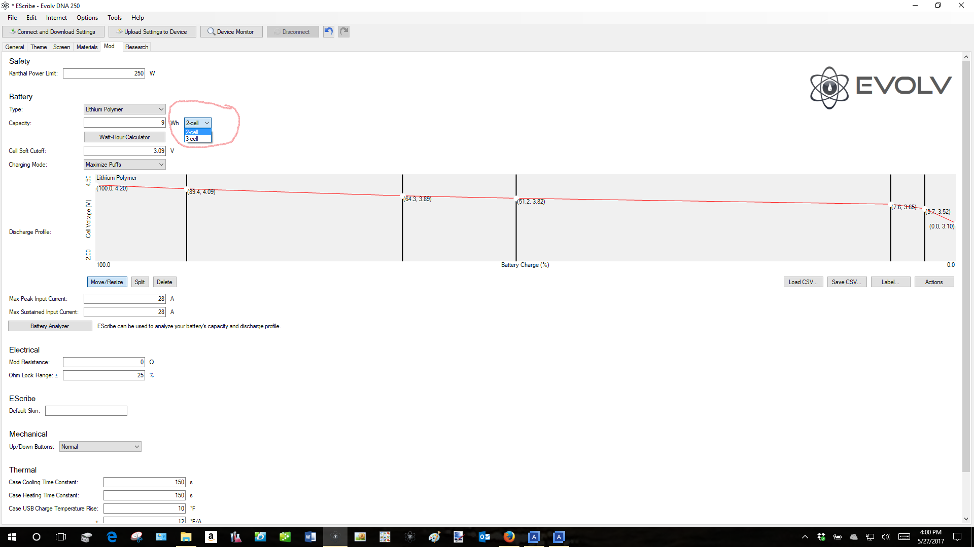

giz_60 Posted May 27, 2017 Report Posted May 27, 2017 In the 'Mod' tab, you need to make sure it is set for 2 cell... 1

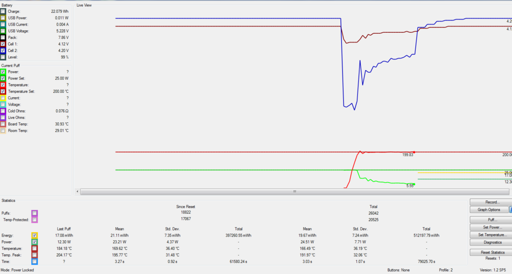

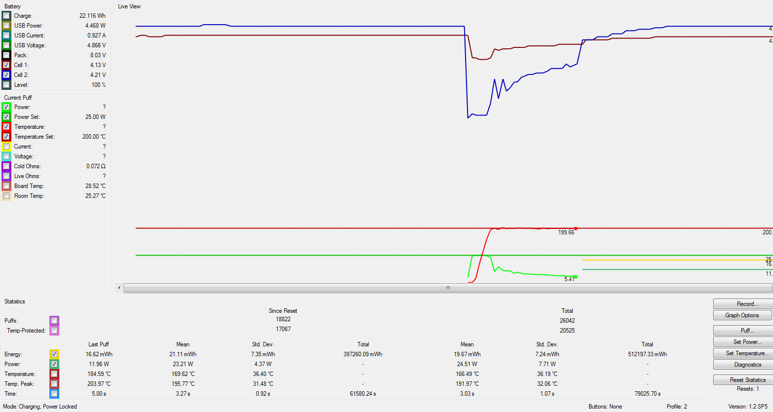

Omranr Posted May 28, 2017 Author Report Posted May 28, 2017 41 minutes ago, retird said: Switch battery positions in the device..... take out batteries and change places with them.....fire again and post screenshot like the one you just posted.... here you go i switched them and each has a screen shot.. any thoughts ?
retird Posted May 28, 2017 Report Posted May 28, 2017 The graph looks fine except for the difference in battery sag on cell 2 and 1 while firing, and the difference in battery voltage of each cell. Switching the batteries around still showed more battery sag on cell 2 and still showed less voltage at cell 1. Thus, I think we can rule out the batteries as a possible issue. I assume the battery posts are clean on the batteries and sled and making a good connection. Thus there is something amiss in the device and you have contacted Lost Vape. The device graph shows the device is still vaping good. There are several things that can cause this but all would require opening the device to check so why not just let Lost Vape guide you.... I would hang on to the graphs you posted as they would be good info to give to Lost Vape showing it doesn't seem to be a battery issue but could be a wiring, battery sled, poor soldering, or even a board issue.
