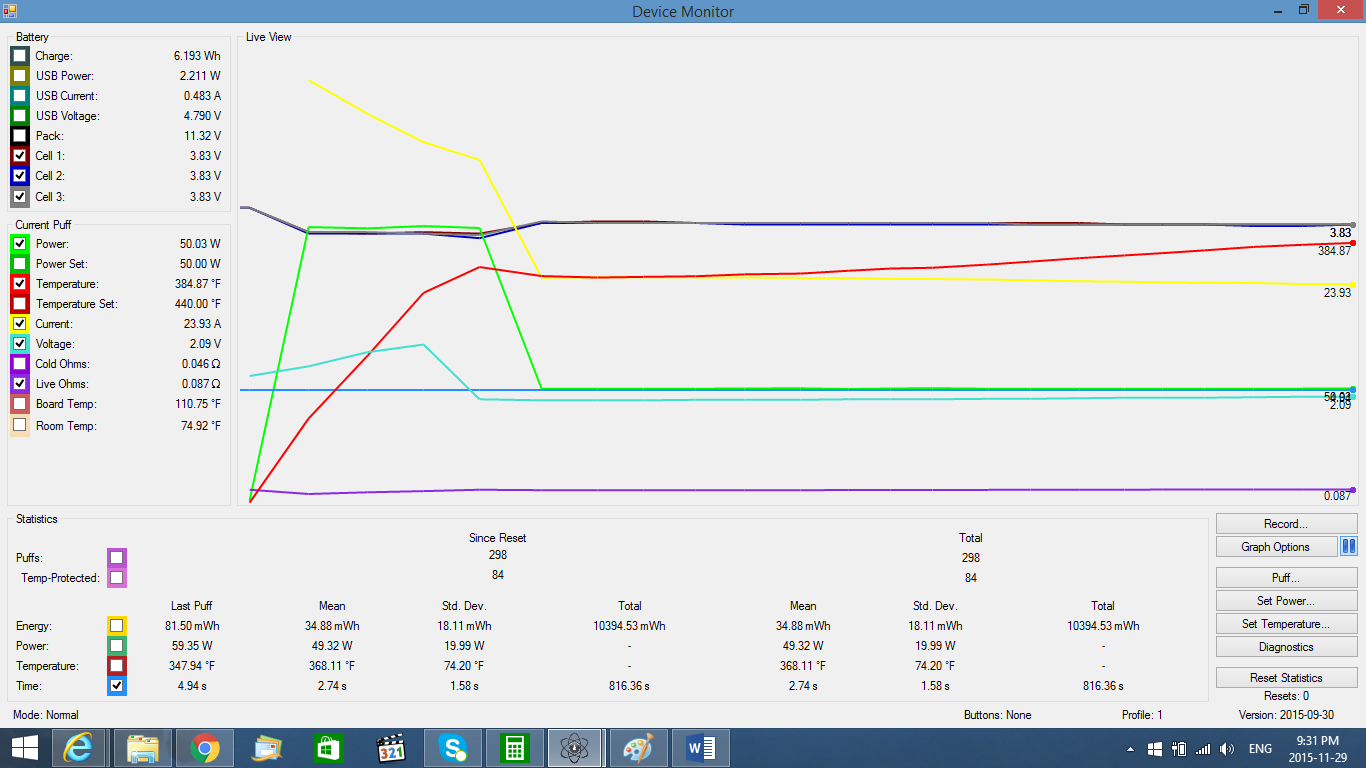

Hi, i just got a lava box on friday (black friday) and no, no correlation between sales and the box, just coincidence. I am having troubles with a bug that i have not been able to find through the search function which isnt actually why im writing this post. Which has to do with the chip not sensing tc coils and having to go through a series of steps to get it reading and working right. The problem I am posting about now is when i get past that bug which im hoping is fixed in an update sometime soon. When i get past the bug and i am connected to escribe i have my temp set to 440 with a preheat of 100w 1s 9punch, i then open the device monitor. when i take a pull the temp jumps to ~330 and creeps up slowly from there, and the temperature set is still 440. the weird part though is that it feels too hot for 440. If i reset temp to 400 it does the same thing on the graph and settles at ~330 but the temp feels different from when it was set to 440, but depending on if i set and reset the temp it hits hotter or warmer, never constant yet its always settling at 330.
so tl;dr no matter the temp im setting, the live temp on escribe settles at ~330 and graph still acts as if its reading and performing right if temp was set to 330. Yet temp does not feel correct to what is actually set and isnt constant (hotter/colder if i switch between temps)

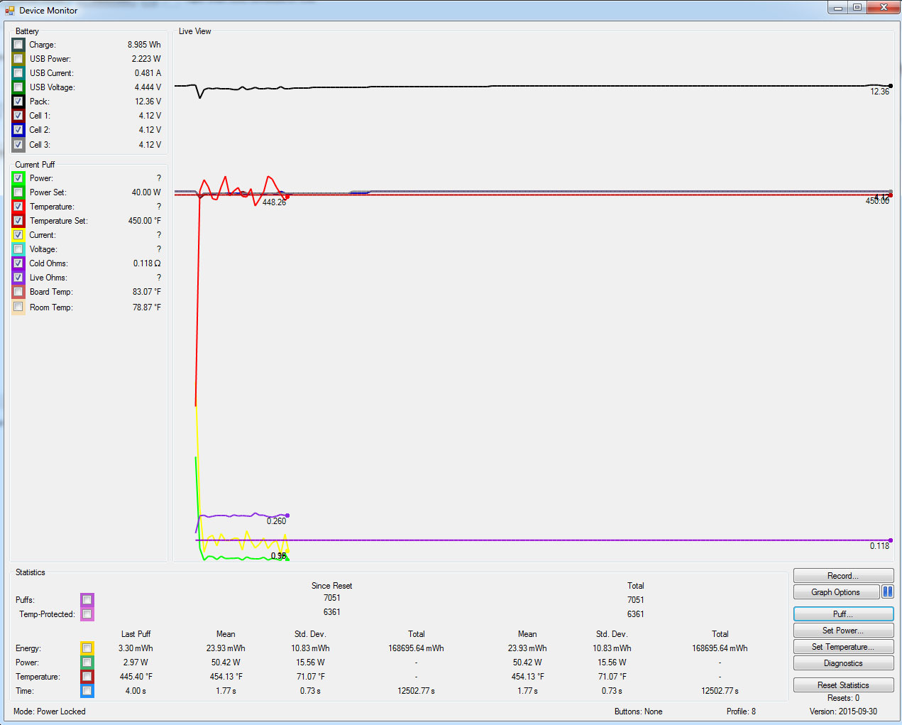

Example raw Ni200 coil (using the built-in Ni200 profile):

Flat curve (Fused 2x26 Kanthal, 1x30 Ni200); the FLAT one is your calculated 'curve':

you used 30g instead of 32 by accident. i recreated the "correct" coil and the resistance in the calc was off by 0.04ish which is a lot i feel. i loaded the tfr curve and my temp is getting closer to desired temp (about 20 degrees higher or so)  on graph but still feels hot which is confusing. live ohms still look stable..
