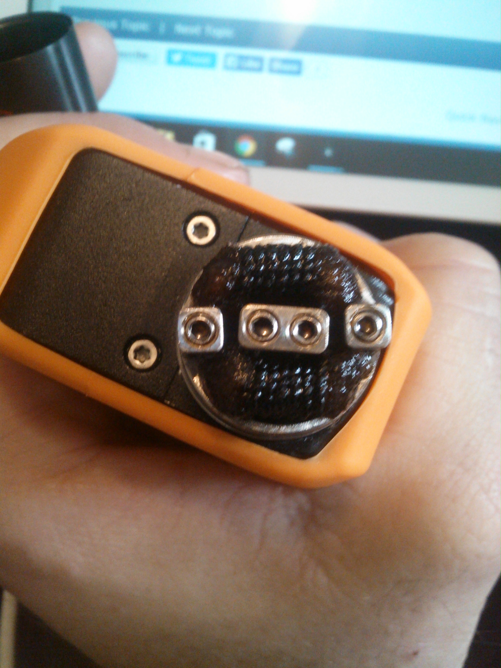

Just made an interesting build, A tiger coil made from 28 gauge Ni200 with .8x.1 Kanthal ribbon wire. Used the tcr calculations from steam engine for parallel mixed wire since it doesn't allow for twisted mixed wire. The results were a 0.07 ohm coil consisting of 12 wraps around a 2.5mm arbor for a dual vertical coils in a Steam crave aromamizer rdta. temperature set for 440 F very favorable dense warm vape. In my opinion, anything twisted results in a better more favorable vape than you can get with a single wire. Granted not quite as good as a clapton coil build but close
