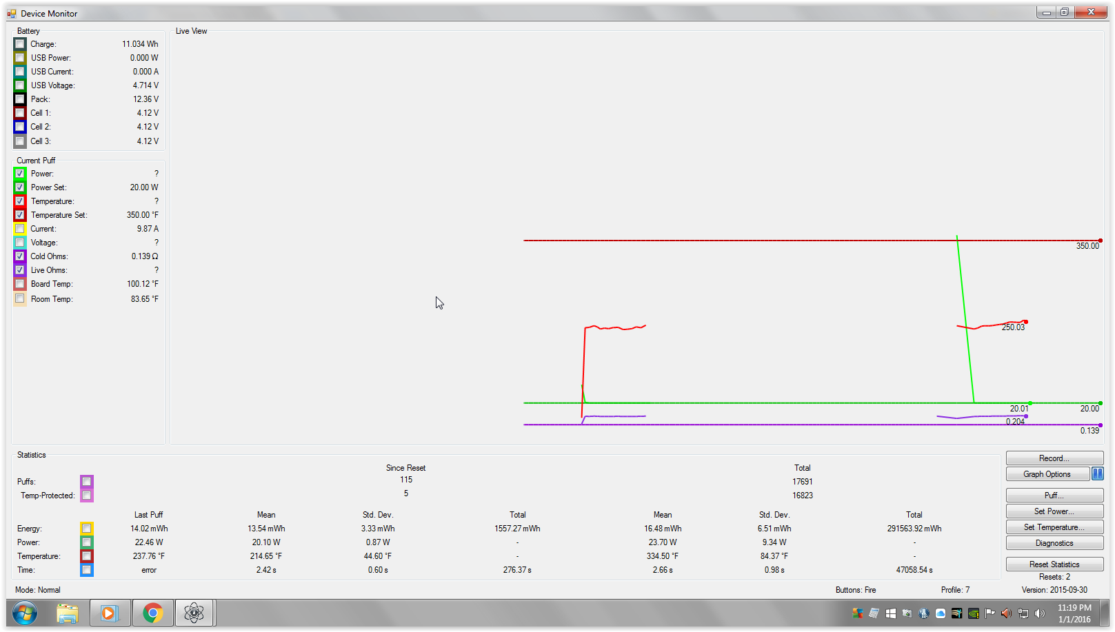

LarryLenz Posted January 2, 2016 Author Report Posted January 2, 2016 Hi. As the screenshot shows, I take 2 hits of my hCigar VT200 running a Kanger SubTank Mini with a 0.21 ohm NI200 coil. The mods works great with this tank, but when I check it out with Device Monitor I get no temp readings while firing. I've tried 3 other tanks with the same results.Any ideas why this is happening to me? thank you in advance.
nismith8 Posted January 2, 2016 Report Posted January 2, 2016 I had the same thing happen to me last night, I also noticed the cold ohms on mine kept changing and the live ohms stayed at '?'. Not sure exactly how I fixed it, but I used the set temp button in device monitor to set it to 600f and pushed the fire button a few times and all of a sudden it started working.
LarryLenz Posted January 2, 2016 Author Report Posted January 2, 2016 Thanks nismith8 . I'll give it a shot. OK set the temp in Device Monitor to 600 deg F, took two hits and set it back to 350 deg F and still no Actual temp while vaping. Hmmmmm********************UPDATE:********************I set up a profile for the Kanger SubTank Mini, uploaded it to my mod, and selected this profile. Ran the test again and it worked. Go figure. All the setting were the exact same. It is Working Perfectly NOW lol See Screenshot.

Spector NS5 RD Posted January 2, 2016 Report Posted January 2, 2016 try someþing run atty analuzer on your subtank. most subtanks are garbage for tc. unstable. i had three mini st's one of em works good for tc. someþing with the design of em is wrong. what gauge is your ni? how many wraps? i'm guessing yoir base res is closer to .1 something and not .218. which would be loose conn somewhere.

retird Posted January 3, 2016 Report Posted January 3, 2016 Temp set to 350F and only reaching 250F. Noticed your wattage set at 20 watts... Try turning up the wattage and see how it responds on the graph.
black lace Posted January 3, 2016 Report Posted January 3, 2016 I cant remember the wattage i vaped mine at on a simular coil build, simular juice viscus, but set at 450 never reaching it. It would have been less than 30 watt though, See what the program does with a different attomiser or overwrite the program. Just thoes center pins give a poor connection and send everything off.
Spirometry Posted January 3, 2016 Report Posted January 3, 2016 Post #1 there is no temp reading because it is firing in power mode. If the mod doesn't see a rise in resistance it will switch to power mode. You have to remove the atty to force a new base resistance (uploading a new profile will also force a recheck)Post #2 Things definitely aren't working perfectly now. Your coil is not 280F because 280f is not hot enough to produce vapor. Your mod clearly has the wrong base resistance.
mactavish Posted January 3, 2016 Report Posted January 3, 2016 dc601 said:Temp set to 350F and only reaching 250F. Noticed your wattage set at 20 watts... Try turning up the wattage and see how it responds on the graph. Exactly, folks keep thinking the "temp protect" message is a warning, better to think of it as CONFIRMATION that you achieved the temperature you set your device to! If you like a cooler vape, lower your temp, but set your wattage to at least obtain it. I can't speak toward the possible connection issues, as I would correct one issue at a time.
LarryLenz Posted January 3, 2016 Author Report Posted January 3, 2016 I will be checking my resistance when Bob's adapter arrives. I just purchased one to do the testing.Thank you all for you concern and help determining any issues I may be having. I'll let you all know once I do all the test and set the mod up properly. I think it is pretty sad that hCigar doesn't take the time to set up their mods before they ship them. That is a big negative in my book.Spirometry. You just might be right. It all looked correct on the mod display.mactavish. When my mod reaches the temp I set it at, it starts to stop firing. But this doesn't happen every time. If it is flashing"Temp Protect", sometime it won't even fire when I hit the fire button. I have to do the final tests and set the mod correctly to be sure. So until then, I will just fight my way through dc601. When i changed the watts to 30, the temp does go up, but the vapor is to harsh for me. So I lowered the temp from 350F to 300F. Save vape, and it never give me the "Temp Protect" message.
black lace Posted January 3, 2016 Report Posted January 3, 2016 Usualy only the simplest thing, if your confident it aint the coil or dry wicking, and your coil aint shorting against the top of the chimney,, have you looked inside the mod at your fire wire, power out to spring loaded center pin, ive had a few so called high end 510 connectors whose name i wont mention, where the bottom has dropped off, so the wire is just rattling around. Also the subtank has quite a long male end 510 to screw in, so anouther possibility that it may have forced the spring loaded center clean away on the inside of mod and so intermitantly shorting against ground when you fire, giving a reading on escribe, but nothing at the buissines end.
