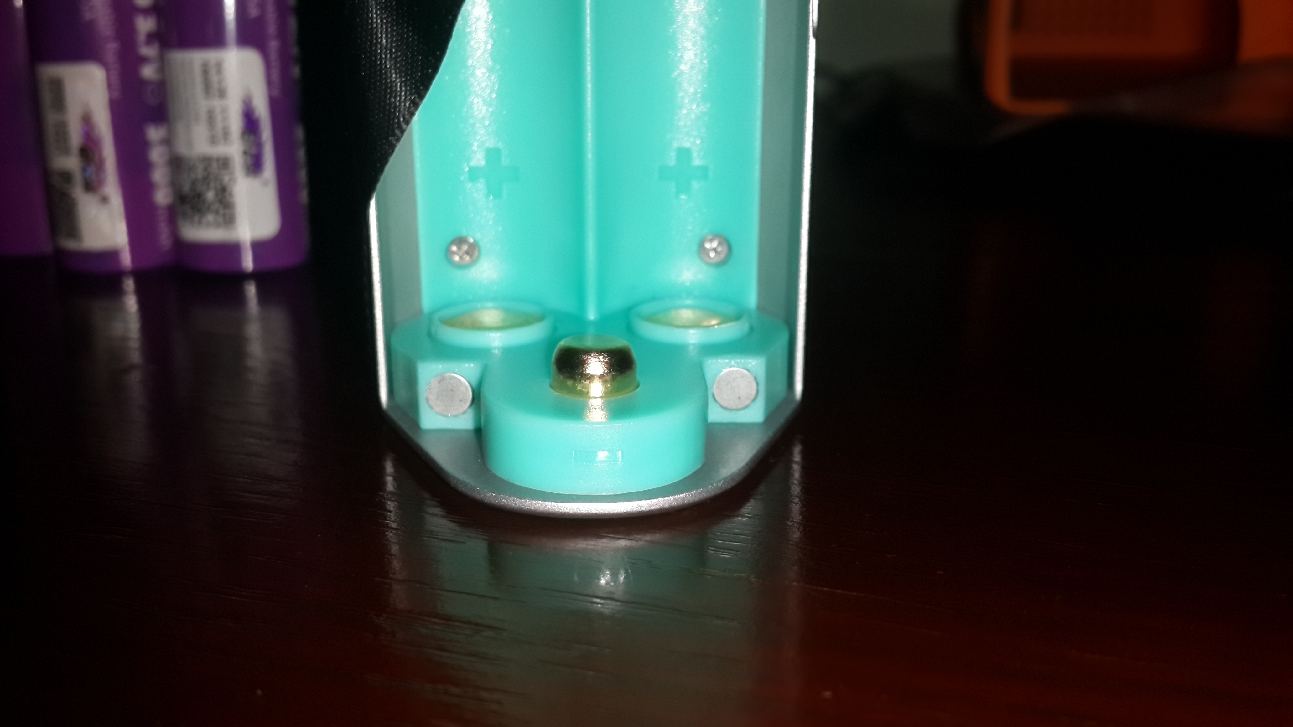

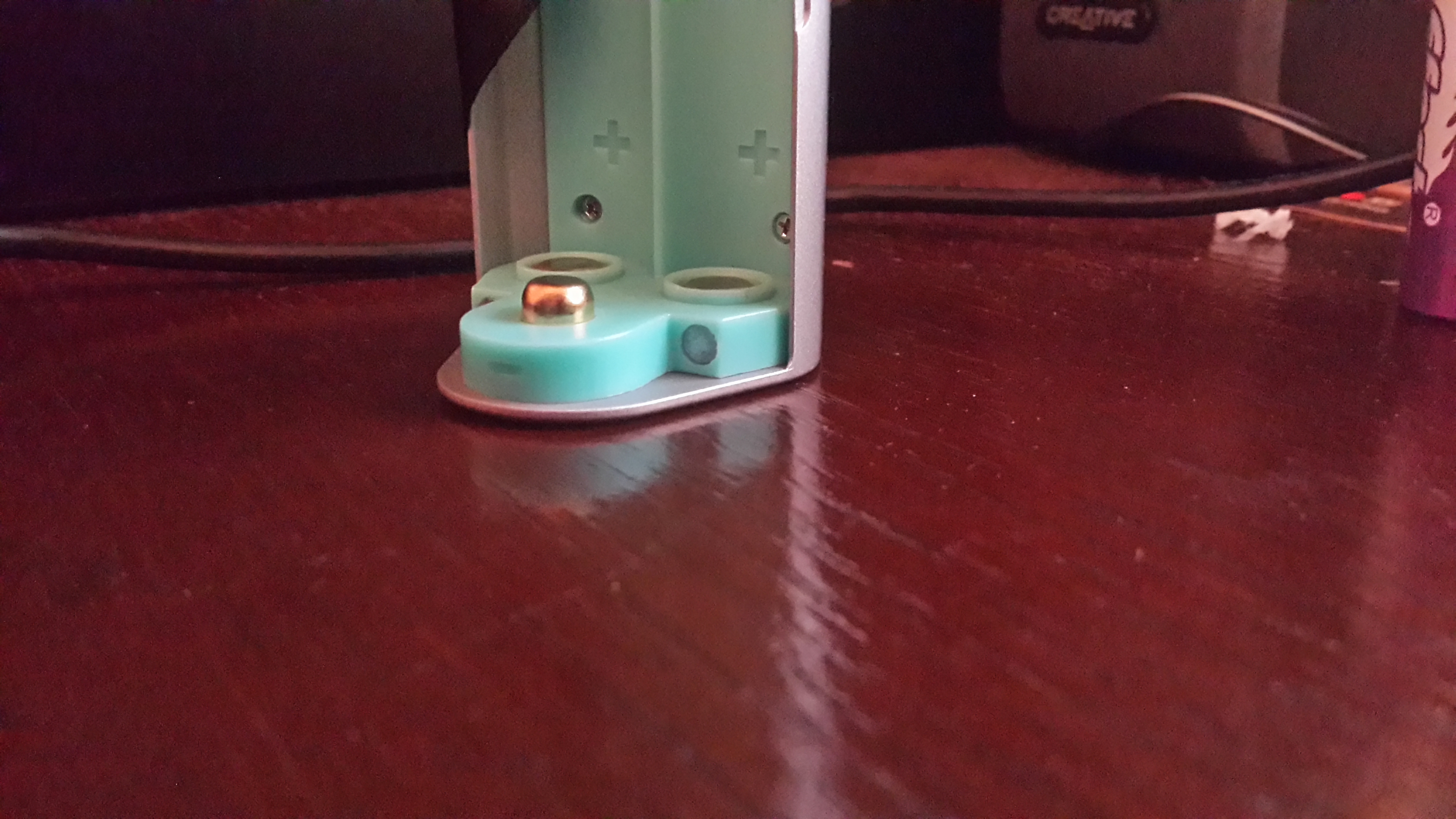

Hi, my reuleaux won't start up when i switch to my 2nd set of batteries. The 3rd battery bay has a problem (when you remove the battery cover the inner left battery is cell 1, the middle battery is cell 2, and the inner right battery is cell 3). The battery installed there keeps giving me 0.85v while the rest of the cells are above 3v.
It only turns on when connected to usb but doesn't charge or anything.
I tried switching the batteries around but whatever battery goes in cell 3 it reads low around 0.85v.
Anyway i could fix this bay?
Pictures attached. The positive right connection piece seems to be lower than the left one.1.jpg 2.jpg
There is a white foam plug in the battery bay covering the ground connection from the batter cradle to the board you could try and give the screw a tweak, don't over tighten.  It is also one of the connections for the balance connectors for cell 1 so there is more than a good chance it is your problem.

Thanks i'll try it
Edit: Didn't work, still not turning on. Thanks though
