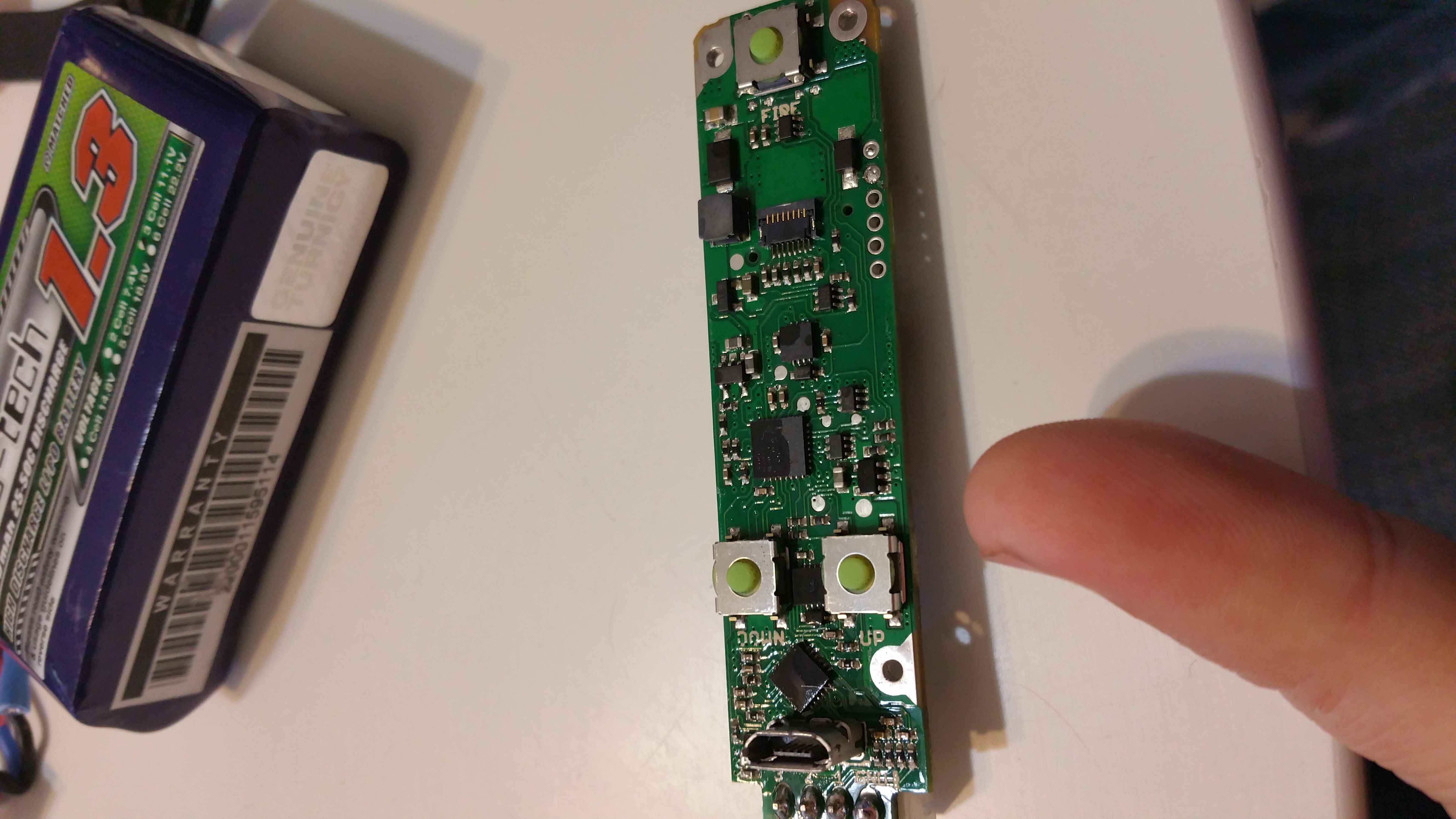

JTree Posted January 31, 2016 Author Report Posted January 31, 2016 Sure. It'll be tomorrow, maybe, but i'll post some. I too am pretty hardcore about everything being clean. I take the solvent approach (sprayed it all down with starting aid after I got done). You'll see a little white crusty on one of the corners when I post, but that was super glue (lose magnet) and didn't get anywhere near the sensitive components.

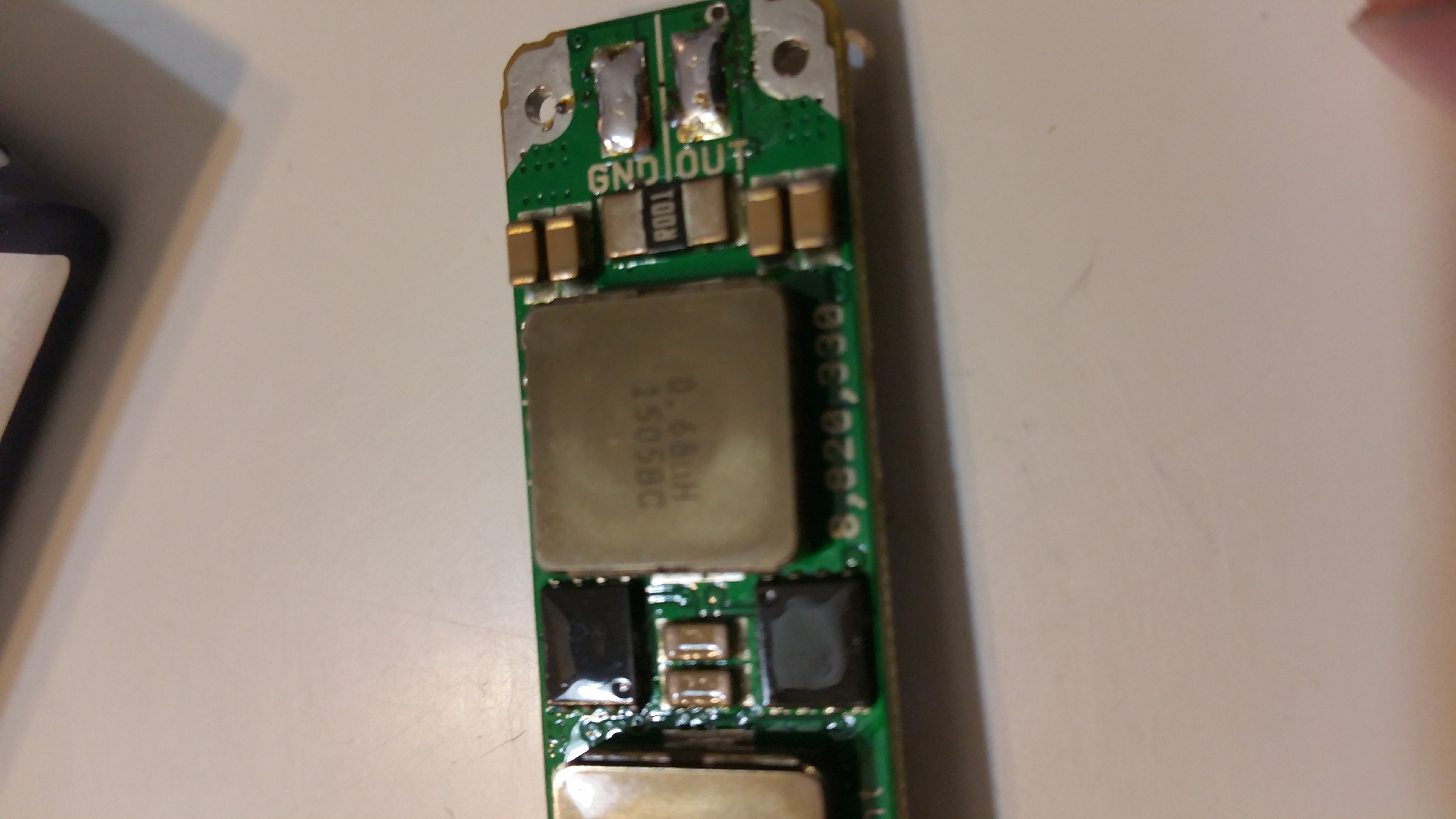

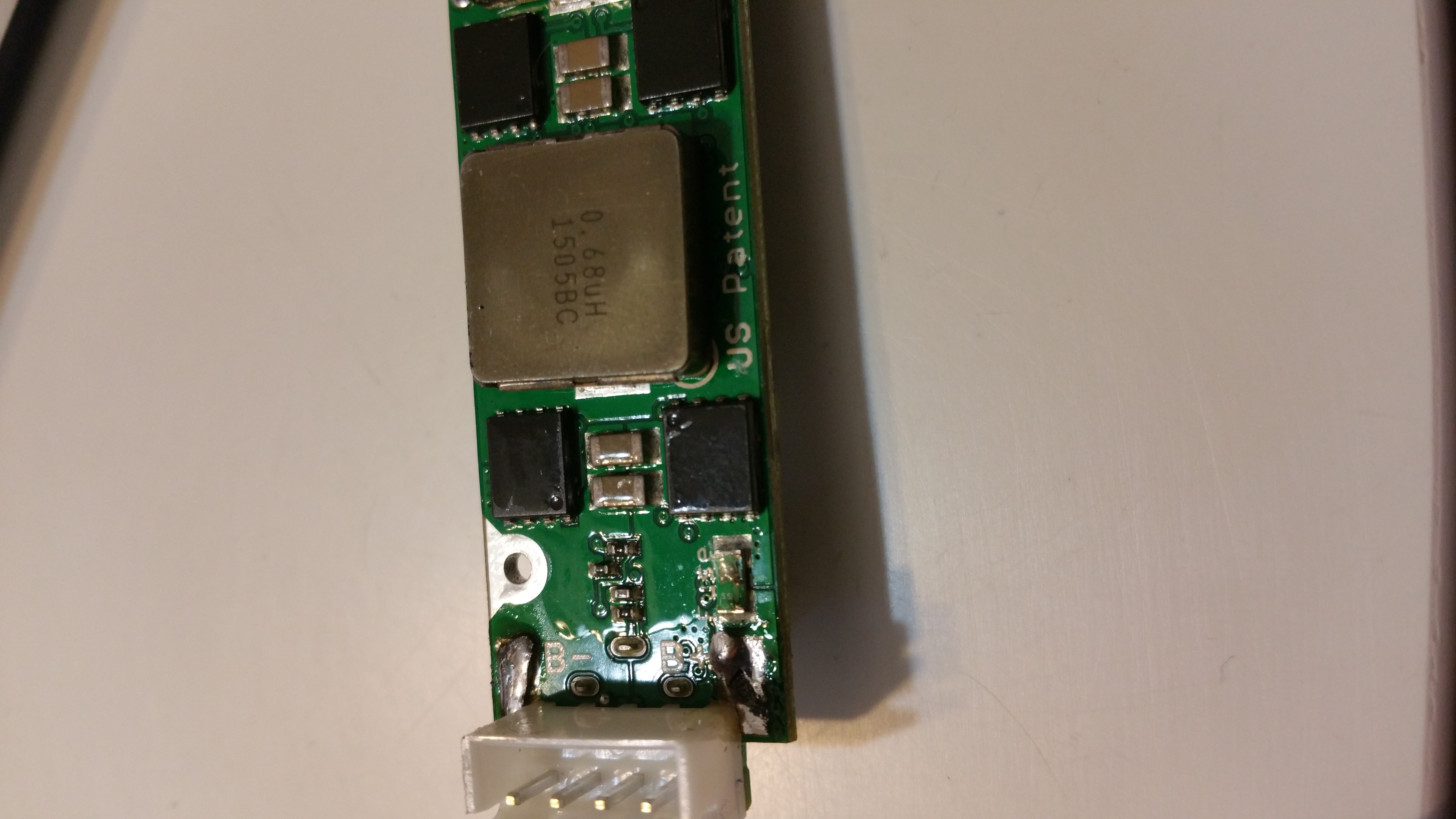

JTree Posted February 1, 2016 Author Report Posted February 1, 2016 So my board has an rma number and is being shipped back to evolve. Here are the promised pics......no continuity across the fuse.
JTree Posted February 1, 2016 Author Report Posted February 1, 2016 I didn't get real crazy with the wick or pump durring deconstruction, as you can see.
black lace Posted February 1, 2016 Report Posted February 1, 2016 Hope you get a new one sorted and up and running realy quick. Picture perfect board from my mobile anyway. Spose its to late to ask did you bridge across the blown fuse and find any life.
JTree Posted February 1, 2016 Author Report Posted February 1, 2016 nope. i was afraid that whatever caused it to blow would further damage the board. they said they may try to repair it, and if so, i don't want to make any more work for them.
