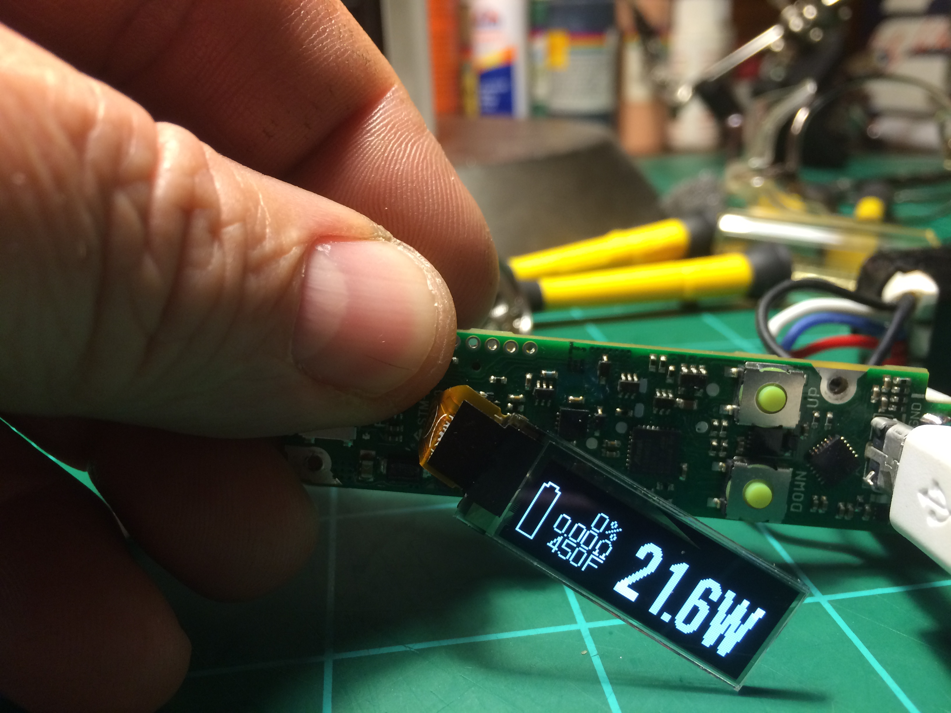

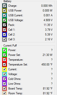

I know this may be a dead horse but I'm having issues with my battery. I have done a hard, soft reboot, I have done a USB recovery charge, I have soldered and re-soldered my connections. updated firmware 2/23/16. I'm using a modcrate 950 box with a protovaper 510. I'm very frustrated and ready to toss it out the window! I just got this board and have broke 1 screen already (ordered 2 boards). Software is set to 3 cell lipo. The charging screen never comes up just the running screen. As you can see below none of my cells are below 1v I'm stumped! Any help? Oh and I'm using a turnigy 950 lipo.
lipo is new i take it? what are the actual individual cell voltages using a multi meter?  if all cells are balanced and at decent levels then you could have some problems where the balance wires meet the board. ex. ejuice near or on jst solder points, flux residue also creates problems if not cleaned off entirely, cold solder joints. if those ARE the true cell voltages, you got a bum lipo. over 4.20 volts kills lithium cells.

I believe it was my battery. I unhooked the balance charging plug and cell 1&3 read 0 but cell 2 was 1.7v with just the pos/neg leads attached. And when I unhooked the battery completely and only use the USB I could navigate some of the other screens that wouldn't come up before ie normal and stealth. Also when I would reheat the balance charger leads my cell 2&3 would swap volts ie cell2 would be 2.18 and cell 3 would be 5.2 then I would heat up my solder leads and make sure all was right and then cell 2 would be 5.3 and cell 3 would be 1.8 my volts for my cells would be all over the map. So I ordered a new battery actually 2. LOL! Thanks for the help!

do not go by the dna board battery readout alone. use a multi meter. borrow one for 5 min if you have to.
