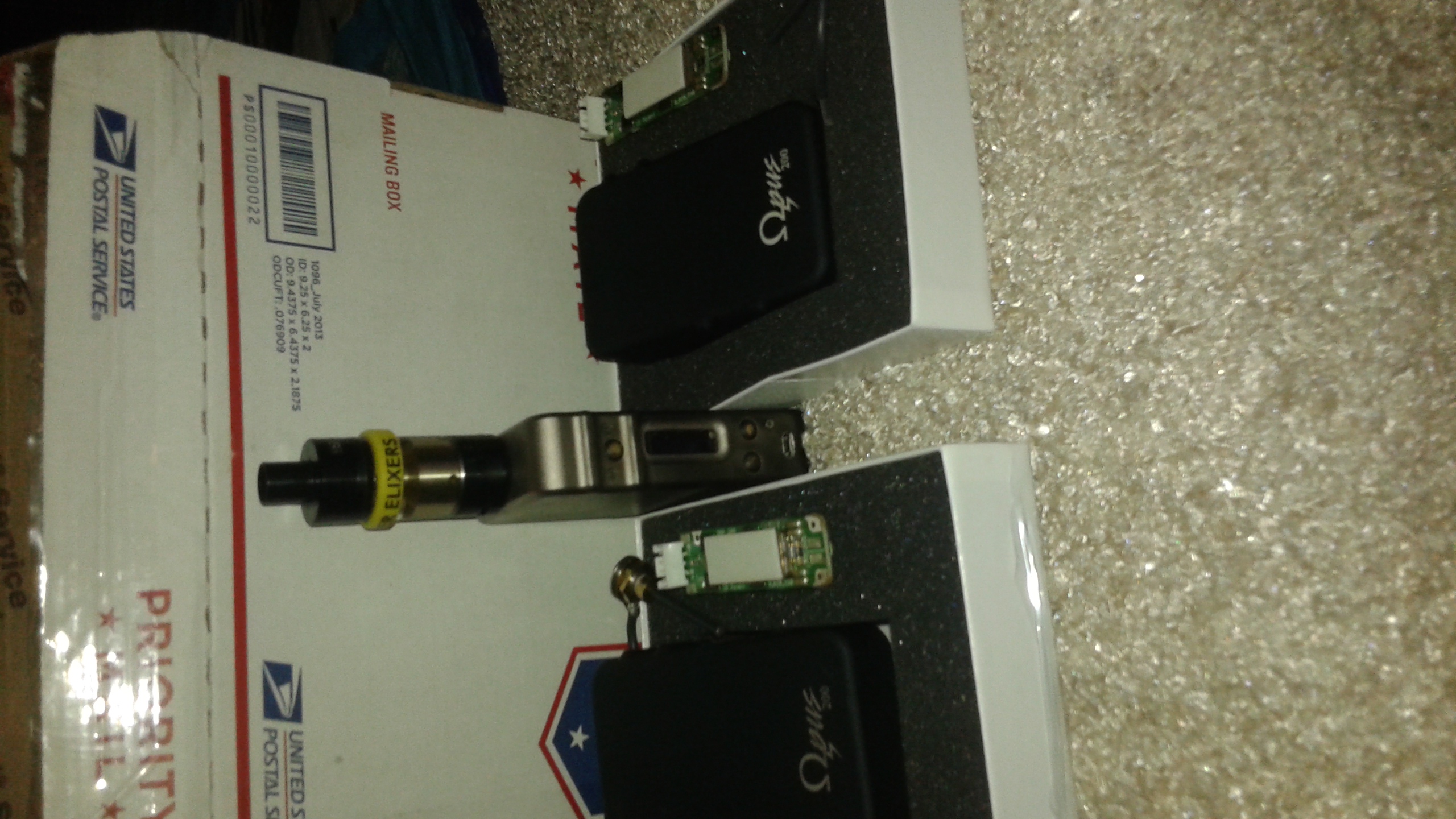

Guest Posted June 16, 2016 Report Posted June 16, 2016 VapingBad said:Also there are only a handful of auto firing instances I have read about, IDK how many DNA 200 are out there, but there are 9,500 users on this forum so it seems to be a tiny proportion. my smoke pro 65 had auto fire protection as it sat in a steel bucket firing or shorted until it killed the Samsung battery with out a atty on it I'll take the fuse any day of the week DNA 200 does not from what I can find auto fire without button sticking or foreign material touching something on the board that it shouldn't. auto fire gets me wound up that's why I own all DNA devices and just stocked up with more
