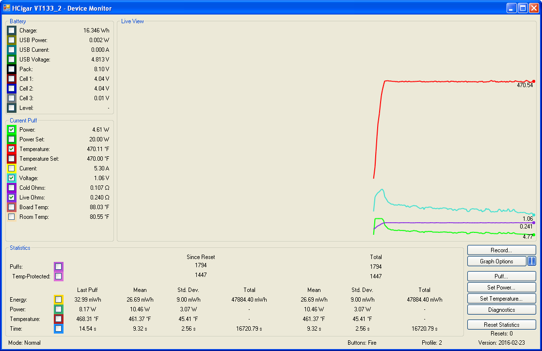

BillW50 Posted July 4, 2016 Report Posted July 4, 2016 What does the graph look like with power, temperature, and live ohms selected? It should look something like this:

BillW50 Posted July 4, 2016 Report Posted July 4, 2016 Preheat you can set higher than the wattage (like 50% higher) and 1 or 2 seconds should be a good starting point. How hard? Just use the middle of the slider right now.

Guest Posted July 5, 2016 Report Posted July 5, 2016 BillW50 said:What does the graph look like with power, temperature, and live ohms selected? It should look something like this: what wire did you use for this Graff? thanks
BillW50 Posted July 5, 2016 Report Posted July 5, 2016 Oh that was on a Crown RBA using a single 3mmID Ni200 28g coil.
JamesVally Posted July 6, 2016 Author Report Posted July 6, 2016 Well i promise a SS curve won't look smooth like that on the top. Like ni200.

JamesVally Posted July 6, 2016 Author Report Posted July 6, 2016 Yea the graphs with ni200 and ti builds have a pretty up tiramp to set temp and then flatlines perfectly at set temp. Where SS builds have a smooth up ramp pending on your preheat settings and how hard etc. then bounce around set temp range by about 10-30*. Its just one of the things with temp but whats weird is you don't feel those while vaping tank/rda. I still love ss316l-430.
