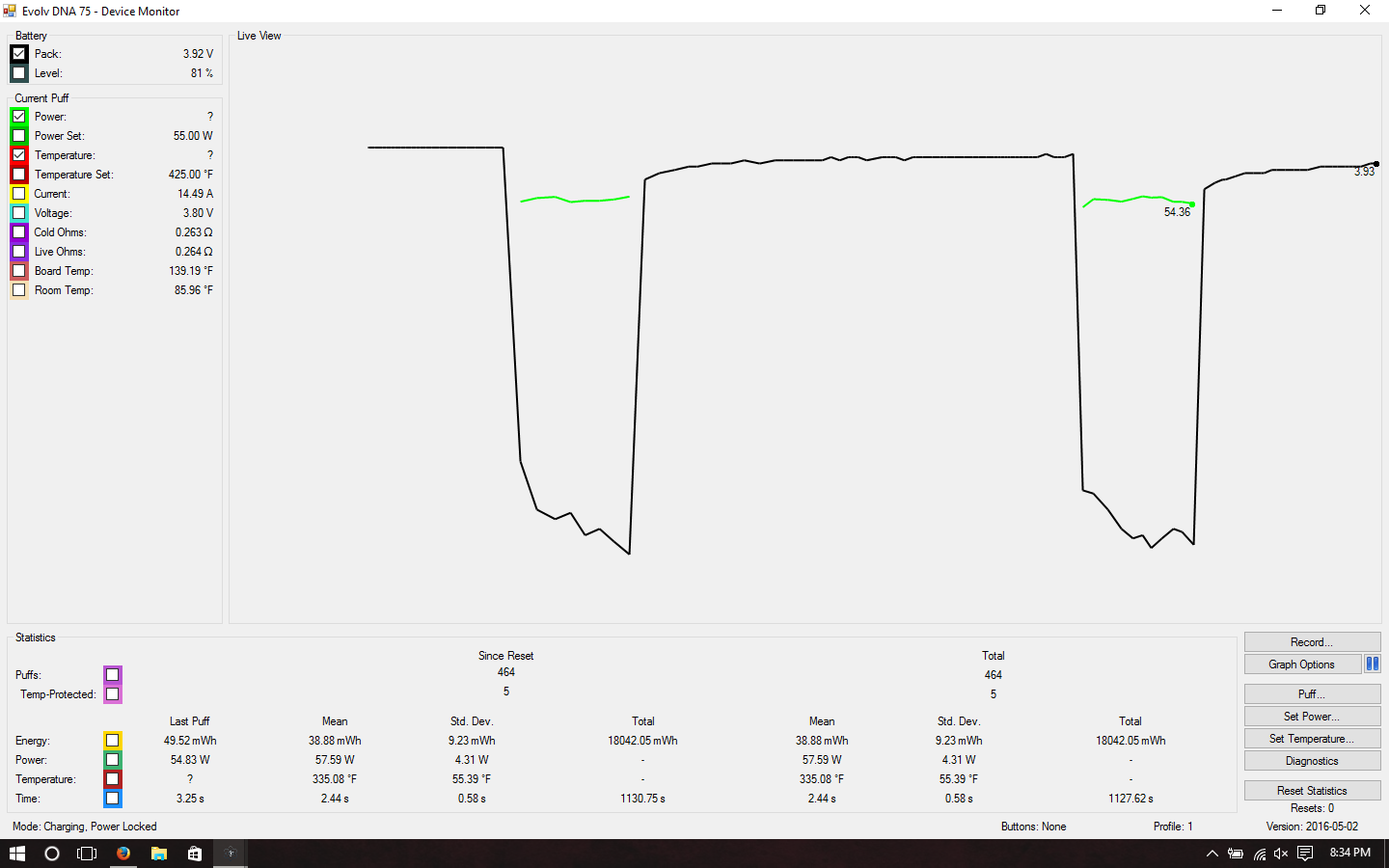

heady4614 Posted June 5, 2016 Report Posted June 5, 2016 I have tried to use the factory settings for any of my batteries and I keep getting the low battery warning at 70% this is with my 26650's and my 18650's alike.
mikepetro Posted June 5, 2016 Report Posted June 5, 2016 heady4614 said:I have tried to use the factory settings for any of my batteries and I keep getting the low battery warning at 70% this is with my 26650's and my 18650's alike.Please post a screen shot of Device Manager after you take a hit that gives the weak bat message.In many cases it because of voltage drop. There is so much voltage drop during the preheat that it triggers the message, but once preheat is over you most often find you had enough voltage to satisfy your temperature requirement for the hit.In other words, it may not be worth worrying about. Device Manager will tell us
heady4614 Posted June 6, 2016 Report Posted June 6, 2016 it is not in temp control mode so there should be no preheat. I have this one in watts.
Spector NS5 RD Posted June 6, 2016 Report Posted June 6, 2016 heady4614 said:it is not in temp control mode so there should be no preheat. I have this one in watts. either way preheat, no preheat, tc or non tc, watts are watts. looks like at 55 watts you got some bad battery sag. what mod is this? what type of battery is this? 26650's are perform very poorly for vaping purposes. especially in the 50 watt and up range. if you're not familiar with battery mooch, i would look at his chart for vaping approved 26650 and 18650 batts. battery tabs/connections also play a role on how well a battery will perform when demands from it are high. make sure you have some good quality batteries to supply power to your dna 75. i'll post a link to suggested batteries.

heady4614 Posted June 6, 2016 Report Posted June 6, 2016 I am using the VT75 using the LG HE2 batteries and Samsung 25R's. the batteries are new so thats not the issue either.
Spector NS5 RD Posted June 7, 2016 Report Posted June 7, 2016 heady4614 said:I am using the VT75 using the LG HE2 batteries and Samsung 25R's. the batteries are new so thats not the issue either.i'm wondering with the new vt75 and dx75, if there is anodizing on the battery thread caps. that could cause a premature 'weak battery' message. i also have no idea what gauge battery wire they are using in these mods nor how or if they are achieving a solid ground connection from battery to board. if it's any consolation, i hear evolv is working on a dna 75 firmware update to make the 'weak battery' message less eager to appear on the screen.
