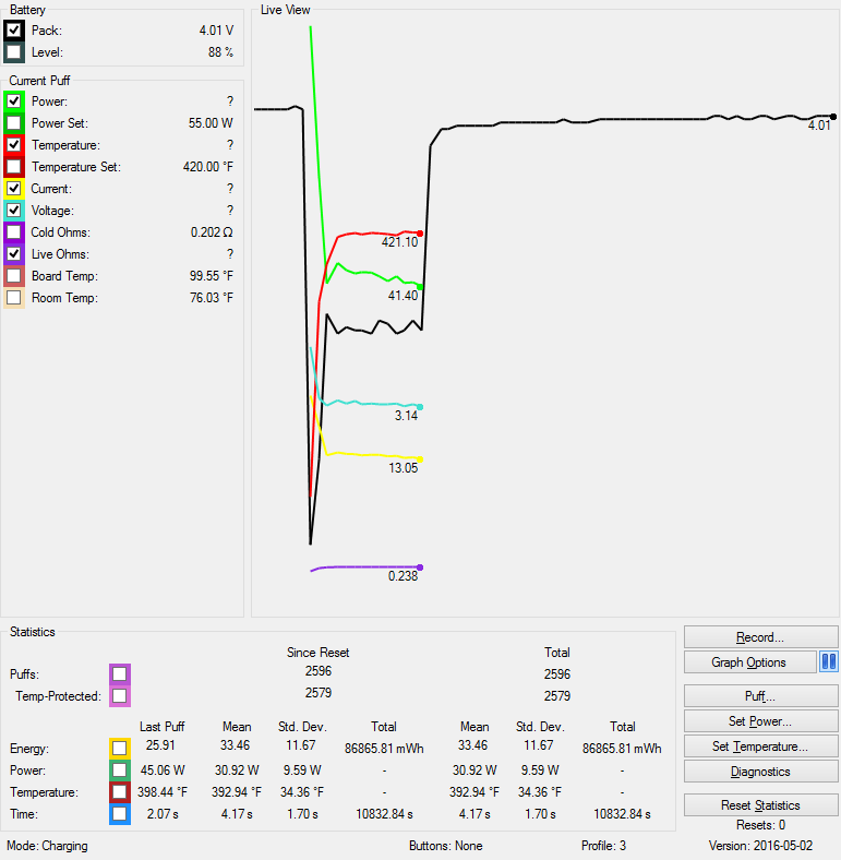

The "weak battery" can easily be a result of voltage sag caused by the high current demand of the preheat.  Looking at eScribe as I fire my DNA75 with an 18650 shows the voltage drop during preheat is really quite high and not an indication of a problem with the chip or the battery, just a result of a very high load.  Even a 26650 will sag, significantly, under loads like that which, in turn, trigger the "low battery" warning.  The chip just sees the voltage drop to the "low" threshold and triggers the warning.

Weak Battery is a warning message and not an error, you get Check Battery when there is more of a problem.  It just means that the battery couldn't supply the power you asked for without sagging below 2.5 V so the board protects your battery by backing off to keep it from dropping that low, which is a good thing IMO.  You may get it a little more in temp mode with the preheat at 75 W, but all it means is you just get say 65 or 70 W preheat instead and mostly you will get full wattage for the rest of the vape, have a look in device monitor to see for yourself.  75 W is a lot from a single cell and the voltage from cells with high internal resistance will sag a little more, the high mAh cell that have got popular more recently and 26650s for instance.  Also if the cells are really tired they take longer to recover than cells in good condition and you will see more warnings, info message would be a better term IMO.

If you get warnings with fuller batteries running the 26650 than 18650 it's the battery, but both should be OK and I was just trying to include all the factors.  If you do feel you are getting the warnings too early I urge you to look at the battery level in device monitor because it is probably jut the initial preheat that is triggering the warning and it may be an idea to turn that down a bit for that battery.
E:
See the battery voltage is the black line, it sags a lot with the 75 W preheat, but quickly recovers as the power reduces to 40 W.  This is a Sept 2014 Samsung 25R that has always been charged at 2 A so is by no means a top condition battery, I don't get any warnings until the resting battery voltages goes down to about 3.3 V with this set up.
