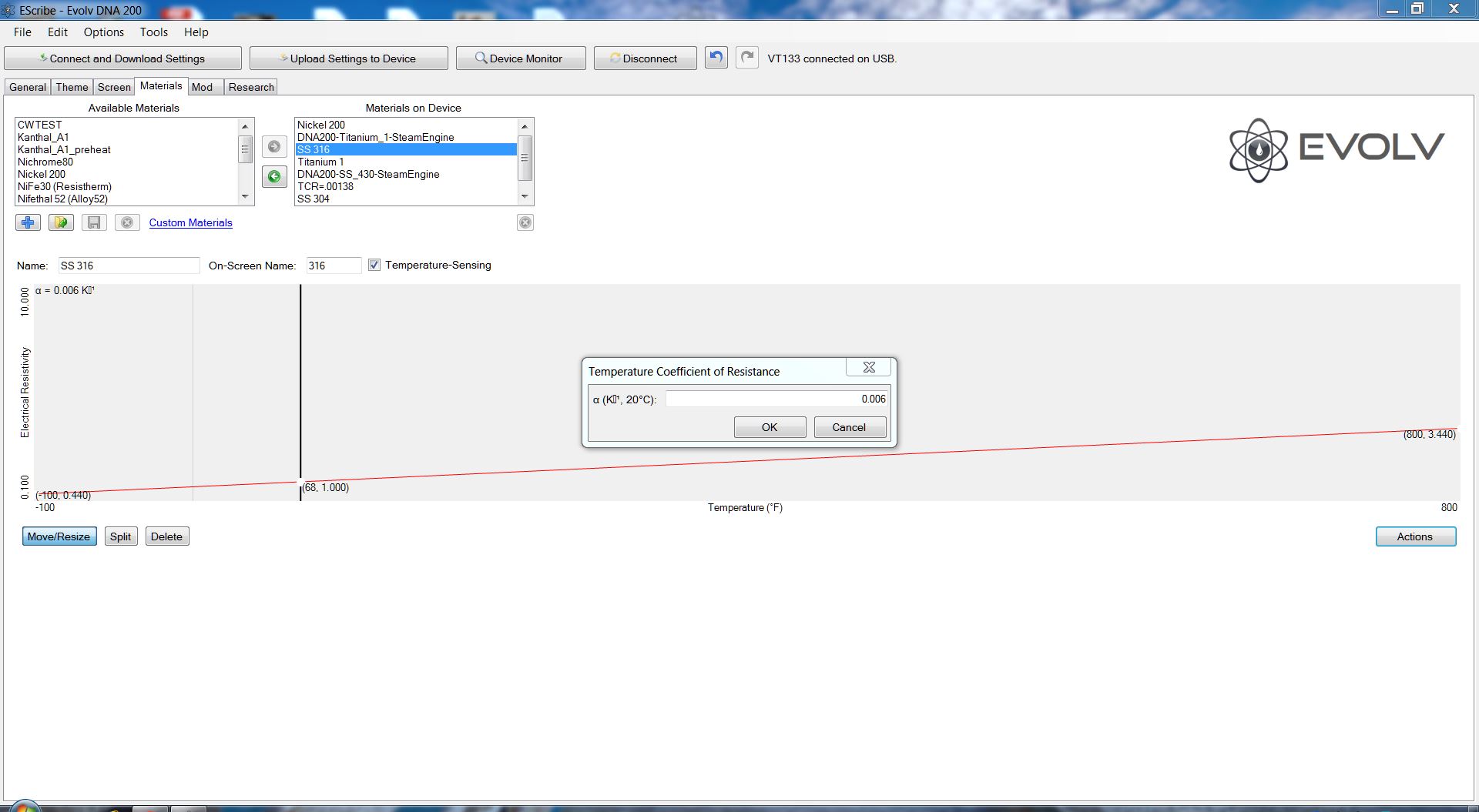

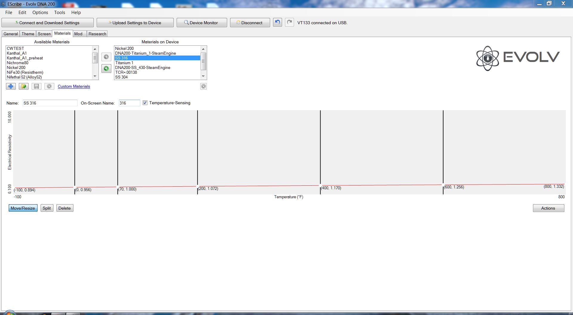

dwcraig1 Posted August 5, 2016 Report Posted August 5, 2016 Here is material tab open and with SS316 highlighted, note the graph's 800 F figure. Here is with the appellate open ready to change it. Note it is 0.006 and the line on the graph has moved to reflect this setting. No changes are made till OK is pressed and uploaded to the device. So unless you are naming your CSV's 0.006, ect. I don't understand how you see this value anywhere but in the window to change it. As far as the mod kicking out of TC, well I never got to that part.
Spirometry Posted August 5, 2016 Report Posted August 5, 2016 Lets word it in an other way. In escribe there is no way to see what tcr value you have set to a particular material. EScribe only shows tfr graphs. The 0.006 you keep seeing is a new tcr value that escribe will use to convert into a tfr graph IF you press the OK button. EScribe has no idea what your current tcr value is. It does however remember the last value you entered until you restart escribe, then it goes back to the default value of 0.006
