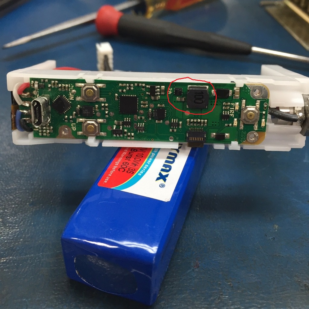

No daughter board? I'm curious how do they light the fire button and show charging lights at the button?
evolv sends out the led's already soldered to the proprietary VS dna 200 boards before VS gets them. here's a pic of a VS dna 200 disassembled . different buttons and a side mounted ZIF socket than the reg 1 amp dna 200. if you look closely around the fire button area you'll notice three SMD led's. two blue (mounted diagonally from each other and one red SMD led (underneath fire button). disregard the red circle i made with MS Paint, that was for something else.

retird said:
THX.. I looked for a picture or video of a VS dna 200 disassembled and didn't run across any.   VS must move a ton of the DNA200's to get a special board.
