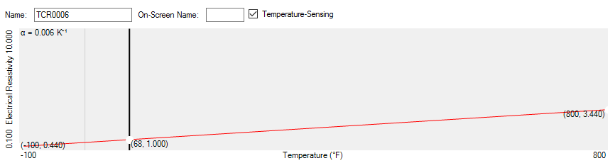

VapingBad Posted August 12, 2016 Report Posted August 12, 2016 The 0.006 is just the default for the box you type a TCR in (close to Ni), DNAs don't use a single value TCR they use the non-linear profile you see as a line on the materials tab. If it were the default these lines would all look like this, notice how it only has data point or black vertical line. You are not going to get the same vape form different tanks or drippers with different builds just because the coils are running at the same temp. EG I find with Aromanizer RDTA using very high horizontal coils I like it about 400 F, but with Serpent Mini I have to turn the temp right up to 460+ to get much flavour and then vape is too hot. This is mainly airflow and coil placement, but coil geometry plays a part to you have to have enough surface area to be able to spread that heat. Long legs can also get hot affecting the temp reading without producing vapour. Also wicking, but I doubt you have that wrong we all know about wicking. It can be frustrating sometimes, but increasing the temp limit within reason while you figure it out in no big deal IMO.The board ensures the coils do not exceed and average temp.
