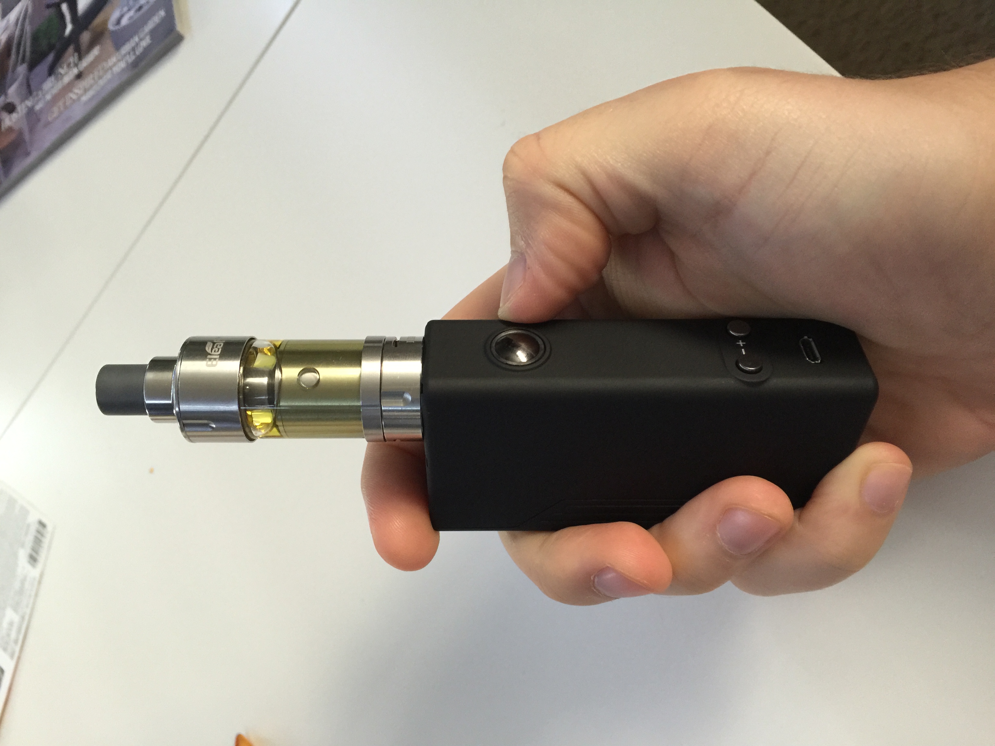

Hey guys, I've been an avid DNA 40 user now for almost a year. Just recently got a Vaporshark 200. I have a dilemma that I'm trying to figure out. I'm trying to set a custom profile for my Lemo settings that vape fantastic on my DNA 40s, but I'm actually getting worse performance in my DNA 200 with this tank. I have a profile set to try and match how the DNA 40 runs, but the DNA 40 is currently outperforming the 200 with this tank so hoping someone can help. On my DNA 40s, I vape the Lemo at 33W 530F. Get a beautiful satisfying vape. I set profile 1 as my Lemo profile, preheat at 40W, temp at 530, punch at 2. And I hit temp and taste a little dryness much earlier in the puff than the DNA 40. Any recommendation for how I could mimic the DNA 40 consistent performance? Everything else like my drippers I've customized and work fantastic. Thanks in advance!

Yup, reading same resistance. If I turn the temp down, I hit temp limiting at its limiting me around 22-24W. If I let the atty cool, then put it on my Flask, same settings, I vape it at 33W 530F, when puffing I rarely hit temp. Usually hovers around 500-510 so the vape is just amazing full on flavour with no hints on dryness at all. For the 200 there must be something I'm missing for it to be limiting me like that, because when it's temp limiting me, I can actually taste the difference, like the cotton is drying much quicker. Hope this all makes sense. I consider myself pretty well versed with nickel as that is all I build with. So having such a change in performance, I'm kinda sitting here scratching my head. So it's time to ask the experts :)

So I modified a bit and performance is much better / almost identical to DNA 40. Set the preheat to 15W punch 1, dropped the wattage to 30W, and now I'm not hitting temp and getting a phenomenal vape like a usually get from my DNA 40. Its not perfect, but I'm understanding the 200 a little better now thanks to some people on the DNA-TP Facebook group.
